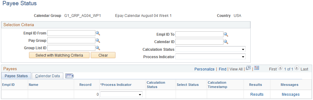

Payee Status Page
Use the Payee Status page (GP_PAYEE_STATUS) to view payees by process indicator, calculation status, or other criteria and specify the action that the system is to take.
Navigation:
Global Payroll & Absence Mgmt, and then Absence and Payroll Processing, and then Review Absence/Payroll Info, and then Payee Status, and then Payee Status
This example illustrates the fields and controls on the Payee Status page.
Payee Status page
To review payee status:
  1. In the Selection Criteria group box, specify which payees to review (optional).
    For example, to see all payees that will be suspended from the next run, select Suspend in the Process Indicator field.
  2. Click the Select with Matching Criteria button to display the results of your search.
To enter processing instructions for a payee:
  1. In the Selection Criteria group box, specify the payees for which you want to enter instructions.
  2. On the Payee Status tab, select the applicable process indicator.
Payee Status
The system displays the results of your search. Each segment, including retroactive segments, is listed on a separate line.
