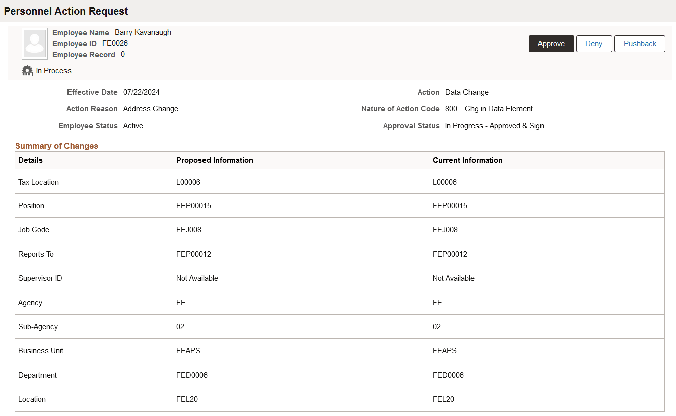

On the Pending Approvals page, select the Personnel Actions USF view type from the left panel and select a PAR entry from the Pending Approvals page.
This example illustrates the fields and controls on the Pending Approvals - Personnel Action Request page as a final HR approver (1 of 2).
Personnel Action Request page (1 of 2)
This example illustrates the fields and controls on the Pending Approvals - Personnel Action Request page as a final HR approver (2 of 2).
Personnel Action Request page (2 of 2)
The approval options on this page are common to all fluid approval transactions, as described in the documentation for the Pending Approvals - <Transaction Details> Page.
Field or Control Description
Approve, Deny and Pushback
Use these buttons to take action on the requested approval.
  • Approve: Once the final approver approves a personnel action request employee's job records are updated.
  • Deny: Once the approver denies a personnel action request the process ends.
  • Pushback: Once the approver pushes back the request it goes back to the originator/requester.

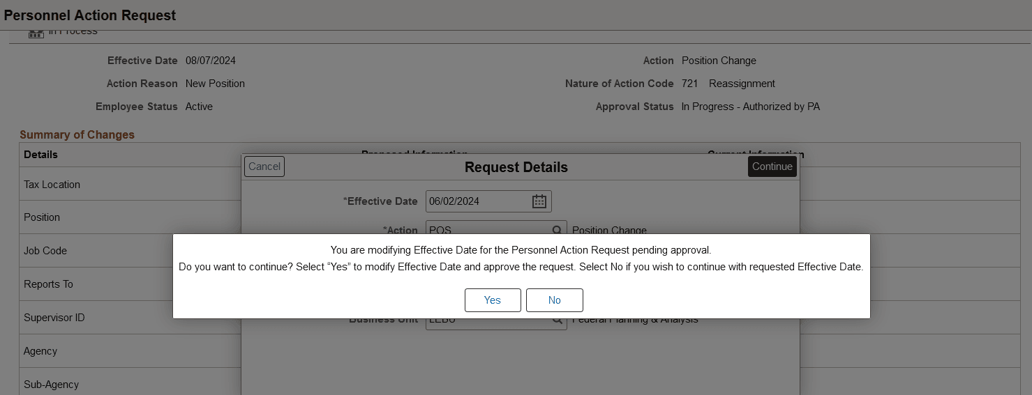

Changing the Effective Date of a Transaction Request
The final approver can select the Edit Details link for a request and make edits to the effective date. When this happens, a warning message appears and asks if you want to continue with the new effective date.
This example illustrates the warning message when modifying the effective date of a Personnel Action Request that is pending approval.
Modifying the effective date of a Personnel Action Request that is pending approval
Select one of the following options before continuing to the Create/View Personnel Actions activity guide pages:
  • Yes: This option uses the new effective date. However, if you exit out of the Create/View Personnel Actions activity guide without saving, the pending approval request will revert to the initial request effective date.
  • No: The option reverts to the original effective date of the transaction request.
The Effective Date field is available only for a Personnel Action Request where you are creating a new transaction row.
--Correct Personnel Action transactions do not allow the final approver to change the effective date.
--Cancel Personnel Action transactions do not grant the final approver access to change the key fields, such as effective date.
Upon save, the previous transaction request will be overridden with the new values, including the new effective date, if indicated. Once the transaction is updated, use the Pending Approvals page to approve the transaction with the new information and commit the changes to the system.

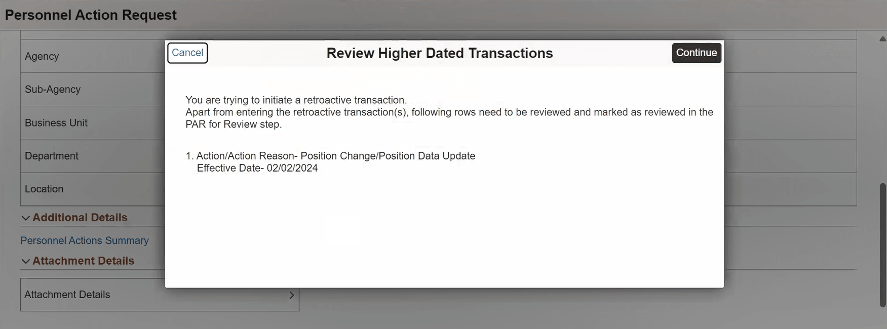

Entering Retroactive Effective Dates
If you enter an effective date that predates the current or future rows, the Review Higher Date Transactions page (GVT_APR_RTR_SCF) displays and provides a warning that you are creating a retroactive row. Select Continue to access the Create/View Personnel Actions activity guide pages and review the existing higher effective dated rows and mark them as reviewed on the PAR for Review Page.
Review Higher Dated Transactions page for a retroactive approval transaction

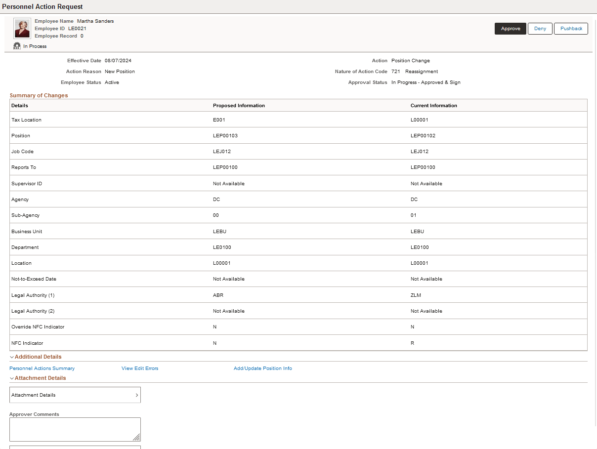

Approving Transactions as a Position Administrator
Using the PeopleSoft Fluid User Interface, a position administrator can be added as an approver for approving a Personnel Action Request.
While configuring a nature of action (NOA), a Federal HR administrator can configure whether the PAR for that action requires approval from a position administrator. For more information on configuring NOA codes, see Application Fundamentals: Nature of Actions USF Page.
On submitting such PAR for approval, the position administrator will be able to view the approval request on his or her Pending Approvals page.
It is up to the PAR administrator to decide if position administrator's approval is required for a specific action request.
This example illustrates the Personnel Action Request page for a Position Administrator.
Personnel Action Request page for the Position Administrator
Add/Update Position Info link
As a position administrator, you can use the link to access the Add/Update Position Info component, make necessary position related changes, save and approve the PAR.
For more information, see PeopleSoft Human Resources Manage Positions: Updating Position Data.

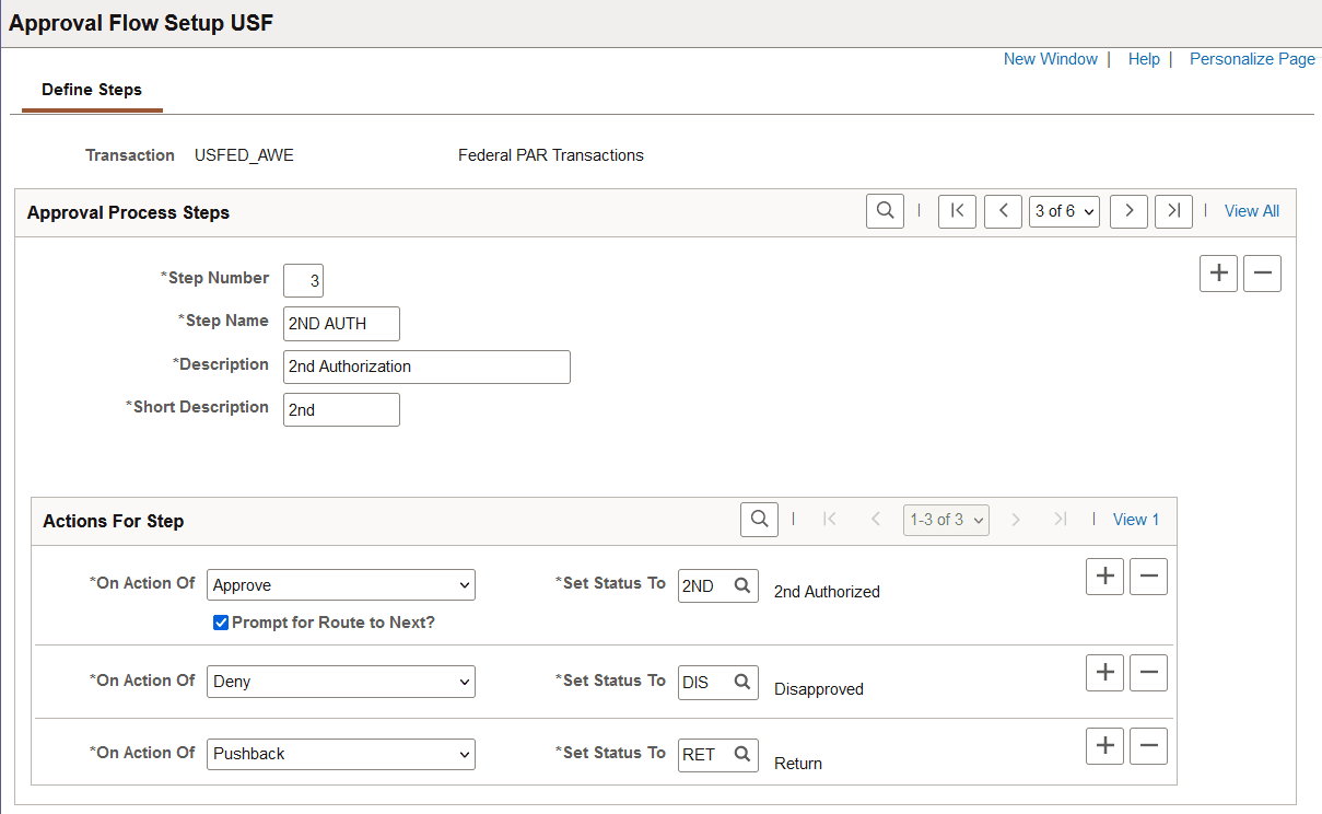

Once a PAR request is submitted, the request is routed to the approval queue. There can be multiple approvers for reviewing and approving a PAR request. PAR administrators can also configure users as 1st approver, 2nd approver, and so on, based on their business requirements. When one level of approval process is complete, the system automatically routes the request to the next level. As an administrator, you can opt not to automatically route the request to next approver and give the approver the option to select the next level approver.
Use the Approval Flow Setup USF - Define Steps page (GVT_WIP_ACTVTY4) to associate WIP statuses with steps in the approval process for federal self-service transactions. You can enable the Route to Next feature using this page by selecting a transaction beginning with USFED as the transaction value in the search page.
Navigation:
Set Up HCM, and then Product Related, and then Workforce Administration, and then Workforce Data USF, and then Approval Flow Setup USF
This example illustrates the fields and controls on the Approval Flow (USF) page.
For definitions for other fields on this page, see the PeopleSoft eProfile: Define Steps Page in the eProfile documentation.
On Action Of
Add or modify the action for which you are defining a WIP status.
Valid actions for transactions beginning with USFED are:
  • Approve
  • Deny
  • Pushback
  • Request

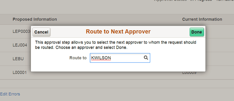

Prompt for Route to Next ?
Select this check box if you want to allow the approver to specify the next level approver, rather than automatic routing.
For example, select the Prompts for Route to Next? check box for the Approve action, with the WIP status as Second Authorizer. In this transaction, when the second authorizer completes and submits the approval request, he or she will be prompted to select the next level approver.
With the Prompts for Route to Next ? check box selected, the Pending Approval pages will present the Route to Next Approver modal window after the person approves the request, where they can enter the route to ID.
This example illustrates the Route to Next Approver page.
Route to Next Approver Page
Route to
Select the next level approver. The data is routed to the selected employee for approval.
Look up options are listed based on the approval user list defined for the next level.
To use this functionality, no changes to Approval Flow configuration is required.
