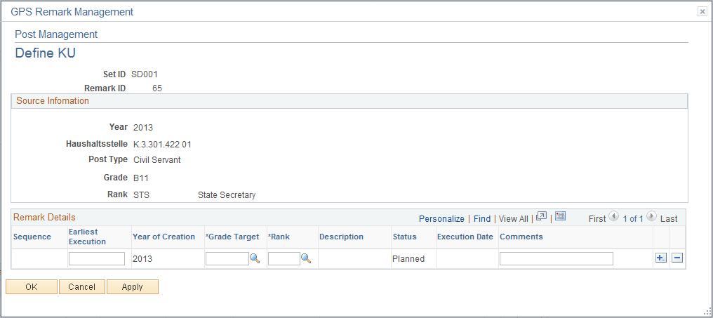

Post Management – Define KU Page or Post Management – Define KW Page
GPS_REMARK_EDIT
Define KU or KW remarks for the corresponding post plan row.

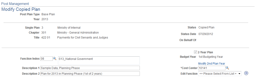

Post Management – Modify Copied Plan Page
Use the Post Management – Modify Copied Plan page (GPS_POSTPLN_NEW) to add or modify post plan details.
Navigation:
  • Click the Add Plan button on the Post Management – Create New Post Plan page.
  • Select a plan to update on the Post Management – Modify Post Plan page.
This example illustrates the fields and controls on the Post Management – Modify Copied Plan page (1 of 2).
Post Management - Modify Copied Plan page (1 of 2)
This example illustrates the fields and controls on the Post Management – Modify Copied Plan page (2 of 2).
Post Management - Modify Copied Plan page (2 of 2)
This page is used to create as well as modify post plans. When you modify a plan that was copied over from the previous fiscal year, some of the page fields are read-only.
Based on the budgeting system that is selected in the installation level, the number of fields (used for identify the budgeting entity) and field labels in the header area can vary. For example, if Kameralistik is used, Single Plan, Chapter and Title field labels are displayed as delivered. If Doppik is the selected budgeting system, Product Area, Product Group, Product, and Account field labels are displayed.
For users who are not part of the planning or administration group and therefore don’t necessarily have the right access post plans, they can view post plans from the Post Management – View Plan page. Post plans are displayed in the read-only mode. Approved plans and closed plans, which are not modifiable anymore, are displayed using the same page.

Function Index
Enter a function index.
Description 1 and Description 2
Enter post plan description.
2-Year Plan
Displays if this is a 2-year post plan.
Budget Year
Displays, for 2-year post plans, whether the current plan is for the first year or the second year.
Click the Modify 2nd Plan Year link to transfer to the plan for the second year. To return to the first year plan, click the OK or Cancel button.
Cost Center
Select a cost center to map with the post plan. This is the cost center of payees that might be eligible for posts identified in the plan.
Cost center values are defined by ADP and made available to post management via integration messages (Integration Broker).
Edit Function
Select an edit function to perform in the post planning phase and click the run button adjacent to the field to transfer to the appropriate page.
The system delivers two edit functions: Define KU and Define KW.
KUs and KWs are instructions about modifying posts; they are triggered automatically by the system when a plan is active (or becomes active) and a post is vacant or becomes vacant.

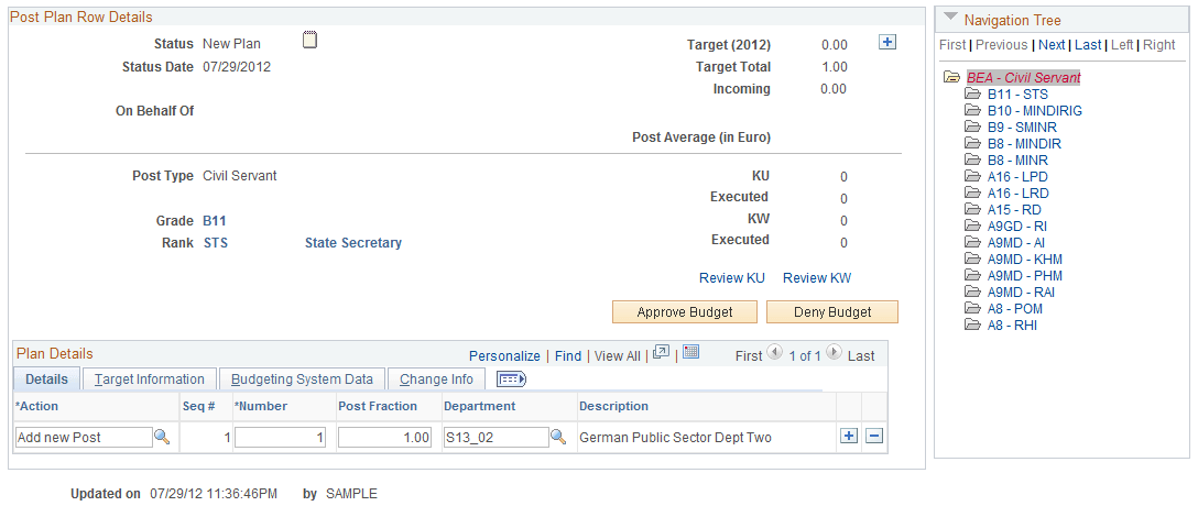

Post Plan Row Details
A post plan row shows the number of posts, specified by grade and rank, to be assigned to any given agency within the public sector. For example, a planner may add one chief inspector (grade) post, one inspector (grade) post and 10 sergeant (grade) posts for the police department of a city government. Each row must be approved via the federal budget in order for the plan to be eligible for approval.
Use this section to perform planning activities, such as add post plan rows (or delete them if created in error), modify post plan row details, and taking necessary actions on posts based on requirements.

Review KU or Review KW
Click to review any available KU or KW remarks on the Post Management - Review KU Remarks page or Post Management - Review KW Remarks page (GPS_REMARK_HIS_SEC).
It includes remarks that are remained open (not processed) and those that were processed past the cutoff date.
Plan Details
Use this section to add individual posts to the post plan row, or perform other action on posts that are in the target of the post plan row (to be processed during cleanup). Actions are defined on the Post Management – Setup Action Table page.
For new plans, the only available action is Add new Post.
For copied plans, additional actions are available based on action status and availability.
Depending on the selected action, some fields become editable for the planner to enter relevant information needed for the action. For example, if the Decrement or Increment action is selected, the planner needs to specify the grade and rank (in addition to number of post and post fraction) that the post or posts should be changed to after the action is performed.

Number
Enter the number of posts on which the corresponding action will need to be processed during the cleanup phase. For example, if the action selected is to add new post and the number is set to 2, two new posts will be added during the cleanup phase.
Post Fraction
Enter the assignment fraction. For example, add 2 new posts with a post fraction of 0.5. A fraction number cannot exceed the value of 1.
Approve Budget
Click to approve the current post plan row.
Clicking this button transfers the user to the Approval Authorization page (GPS_INBEHALF2_SEC) where an approver is specified.
After an approver is selected, the system changes the status of the current row to Approved, and its button label to Reset Approval. Clicking the Reset Approval button sets the status back to the original status and the date to the date prior to the change. Reset is available only until the approval is saved.
Deny Budget
Click to deny the current post plan row. Clicking this button changes the status or the current row to Denied, and its button label to Reset Denial.
Navigation Tree
The tree provides a visual representation of the post plan structure and it displays all post plan rows pertaining to the plan. It allows administrators to navigate from one post plan row to the next easily. Each post plan row is shown as a node with its grade and rank as the node name. Clicking a node link refreshes the Post Plan Row Details section with information for that node.
Use the Post Management – Define KU page or Post Management – Define KW page (GPS_REMARK_EDIT) to define KU or KW remarks for the corresponding post plan row.
Navigation:
  • Select the Define KU edit function on the Post Management – Create/Modify New Plan page and click the run button.
  • Select the Define KW edit function on the Post Management – Create/Modify New Plan page and click the run button.
This example illustrates the fields and controls on the Post Management – Define KU page.
Post Management - Define KU page
The same page is used for defining KUs and KWs. Available fields are slight different depending on which type of remark (KU or KW) you are entering.
A KW (kuenfig wegfallend) indicates that a post would be discontinued and removed as soon as it becomes vacant, where a KU (kuenftig umzuwandeln) remark indicates that a post needs to be changed to the grade and rank specified in the definition as soon as it becomes vacant.
During the planning phase, the planner adds needed KUs and KWs to the budgeting unit (and to both years for 2-year plans). In this phase, KUs and KWs can be updated or removed as long as their associated post plan rows are in these statuses: New, Denied, Changed, or Copied. If an approved post plan row gets a KU or KW, the row status is updated to Changed. No changes can be made to these remarks after the associated budgeting unit has been approved.
During the administration phase, the administrator can define a post upon which an existing KU or KW remark should be processed. He or she can associate the remark with the post, which is referred to as remark individualization.
Old and unused KUs and KWs will be available in a plan the moment the plan was copied forward into the next 2-year or 1-year planning phase. Remarks are available for review in both years using the Review KU or Review KW link. If the current year is the second year of a 2-year plan, and a remark was processed the previous year, it becomes read-only and not available for edit in the current year (the remark’s count will be added to the value in the KU or KW field if it was processed prior to the cutoff date). If it’s defined the previous year but has not been processed, the only remark information that the administrator can update the status (change it to Inactive). If the remark is defined in the current year, the administrator can delete it or modify its details. KUs and KWs that are not processed will always be in active status (unless they are deactivated manually in the planning phase) in the next administration year and will be processed the moment a post becomes vacant.
Remark Details
Use this section to enter one or more remarks for the corresponding post plan row (information is listed in the Source Information section).
Field or Control Description
Earliest Execution
The year entered here must be equal to or greater than the current year.
Grade Target
This field applies to KUs only.
Rank
This field is required for civil service posts and applies to KUs only.
See Also
Post Administration – Individualize KU/KW Page
