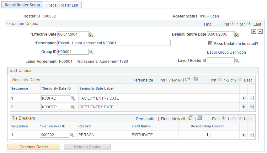

Recall Roster Setup Page
Use the Recall Roster Setup page (HR_RECALL_SETUP) to define the recall roster parameters.
Navigation:
Workforce Administration, and then Labor Administration, and then Layoffs and Recalls, and then Recall Roster, and then Recall Roster Setup
This example illustrates the Recall Roster Setup page.
The system only includes candidates whose recall rights are still valid or those candidates who have a No Recall recall rights rule attached to their labor agreement in the recall roster.
Field or Control Description
Group ID
To populate the recall roster with members in a group, select a group ID.
If you select a group ID, confirm that it includes candidates with the HR status you want for this roster (either Active or Active and Inactive).
Layoff Roster ID
To populate the recall roster with workers laid off from a roster, select the ID of the layoff roster. When generating the roster, the system first checks that the layoff for those candidates was successful and excluded those candidates that weren't successfully laid off.

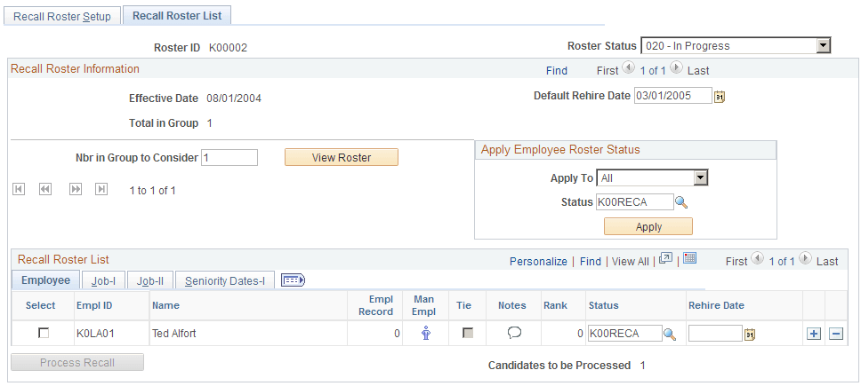

Recall Roster List Page
Use the Recall Roster List page (HR_RECALL_CAND_LST) to manage the recall roster.
Navigation:
Workforce Administration, and then Labor Administration, and then Layoffs and Recalls, and then Recall Roster, and then Recall Roster List
This example illustrates the Recall Roster List page.
The system will populate the Recall/Reinstatement Roster in one of two different ways:
  • If the labor agreement has a no recall expiration rule, the system populates the roster with candidates that were previously laid off.
  • If the labor agreement has recall expiration rule that gives workers recall rights, the system populates the roster with candidates who have been previously laid off and who have valid recall rights.
    Those workers whose recall rights have expired (as determined by the recall rights expiration rule attached to their labor agreement) are not eligible for recall.
You can process candidates in batches. The recall process processes those candidates who have a status with the Process Event? check box selected as part of its definition. After the recall process processes candidates with a process event status, the system resets the candidates' status to one with the Event Complete? check box selected as part of its definition. The recall process will not reprocess candidates with an event complete status.
To process another group of candidates, set the status of a new group of candidates to a process event status and run the recall process again.
Click Process Recall to access the Recall/Reinstatement Process page and process the candidates for recall.
Adding Candidates Manually
You can manually add candidates to the roster (for example, only six former workers still have recall rights but you need to recall eight). To add a candidate manually, add a row and select an EmplID and employee record number. Click the Man Emp (Manual Employee) button to retrieve the person's job details. Once the worker's details have been retrieved, the button becomes display only. The system assigns all manually-added candidates the permanent rank of zero.
The system updates the Nbr in Group to Consider and Total in Group values to reflect the additional candidates.
You can remove candidates who were manually added to the roster.

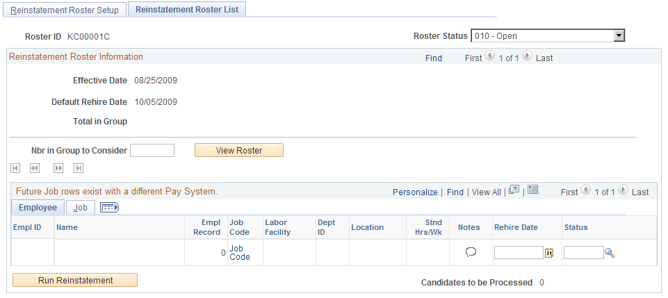

Reinstatement Roster List Page
Use the Reinstatement Roster List page (HR_REINST_CAND_LST) to manage the reinstatement roster.
Navigation:
Workforce Administration, and then Labor Administration, and then Layoffs and Recalls, and then Reinstatement Roster, and then Reinstatement Roster List
This example illustrates the Reinstatement Roster List page.
You can process candidates in batches. The reinstatement process processes those candidates who have a status with the Process Event? check box selected as part of its definition. After the reinstatement process processes candidates with a process event status, the system resets the candidates' status to one with the Event Complete? check box selected as part of its definition. The reinstatement process will not reprocess candidates with an event complete status.
To process another group of candidates, set the status of a new group of candidates to a process event status and run the reinstatement process again.
