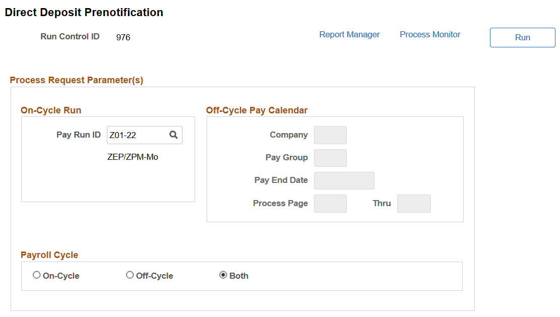

Direct Deposit Prenotification Page
(USA, USF) Use the Direct Deposit Prenotification page (RUNCTL_PAYINIT2 or RUNCTL_PRENOTE) to run the Direct Deposit Prenotification report (DDP005). The report lists direct deposit information for employees who will have their pay deposited directly into their bank account for the first time.
Navigation:
  • Payroll for North America, and then Payroll Processing USA, and then Create Direct Deposits, and then Prenotification Report, and then Direct Deposit Prenotification
  • Payroll for North America, and then Payroll Processing USF, and then Create Direct Deposits, and then Prenotification Report, and then Direct Deposit Prenotification
This example illustrates the fields and controls on the Direct Deposit Prenotification page (RUNCTL_PAYINIT2) when the Create Off-Cycle Files option is disabled.
Direct Deposit Prenotification page (Create Off-Cycle Files option disabled)
The Direct Deposit Prenotification and Direct Deposit Prenote Memo pages are identical, except for the page title. This screenshot displays the version used when the Create Off-Cycle Files option is disabled.
(CAN) The prenotification process does not apply to Canadian Payroll.
Field or Control Description
Pay Run ID
Specify a pay run ID (with confirmed calendars only) for the prenote process.
Company, Pay Group, and Pay End Date
Specify the company, pay group and pay end date of a confirmed calendar for the prenote process.
Process Page and Thru
These fields are for informational purposes only.
Payroll Cycle
This section is for informational purposes only.

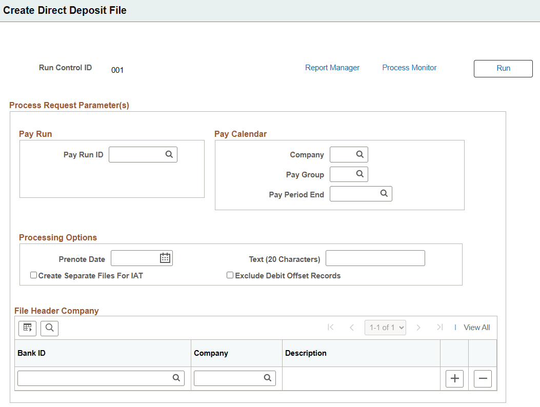

Create Direct Deposit File Page (DDP001 or DDP001CN)
(USA, USF) Use the Create Direct Deposit File page (RUNCTL_DDP001) to run the Create Direct Deposit Transmit process (DDP001), which creates direct deposit transmittal files.
(CAN) Use the Create Direct Deposit File page (RUNCTL_DDP001CN) to run the Create Direct Deposit Transmit process (DDP001CN), which creates direct deposit transmittal files.
Navigation:
  • Payroll for North America, and then Payroll Processing USA, and then Create Direct Deposits, and then Create Direct Deposit File, and then Create Direct Deposit File
  • Payroll for North America, and then Payroll Processing USF, and then Create Direct Deposits, and then Create Direct Deposit File, and then Create Direct Deposit File
  • Payroll for North America, and then Payroll Processing CAN, and then Create Direct Deposits, and then Create Direct Deposit File, and then Create Direct Deposit File
This example illustrates the fields and controls on the Create Direct Deposit File page (DDP001).
This example illustrates the fields and controls on the Create Direct Deposit File page (DDP001CN).
(CAN) Although the Canadian page displays with some differences, all fields have the same functionality as the fields shown on the U.S. page.

The Payroll for North America Create Direct Deposit Transmit process generates direct deposit transmittals for employees within the pay run ID or pay calendar that are in the specified pay group, have a prenotification submitted or a direct deposit to be paid, and have the bank ID and account number assigned.
Processing Options
Prenote Date
(USA) Enter the date that you want the system to use as the starting date of the prenote waiting period.
When a prenote date is specified, that date is used for prenotes on the bank file header and employee direct deposit tables for off-cycle checks.
When a prenote date is not specified, current date is used for prenotes on the bank file header and employee direct deposit tables for off-cycle checks.
Text (20 Characters) or Text (15 Characters)
Enter text that you would like to appear on the direct deposit file. The character limits are:
  • (USA): 20 characters.
  • (CAN): 15 characters.
Create Separate Files for IAT
(USA) Select this check box to report domestic (PPD) and international (IAT) transactions in separate direct deposit files.
Some banks cannot process both domestic and international transactions together in a single file. When this check box is selected, the process will create separate direct deposit files for domestic versus international transactions.
Exclude Debit Offset Records
(USA) Select this check box to exclude debit offset records from the direct deposit files created by the process.
Some banks require that employers submit unbalanced files. Unbalanced files contain only the credit transactions that are depositing funds to employee accounts without any corresponding offsetting debit transactions against the employer's accounts. Selecting this check box enables employers to create files that contain no debit offset transactions.
File Header Company
Bank ID and Company
(USA) Enter your bank's transit number and your company ID. This information appears at the beginning of the transmittal file.

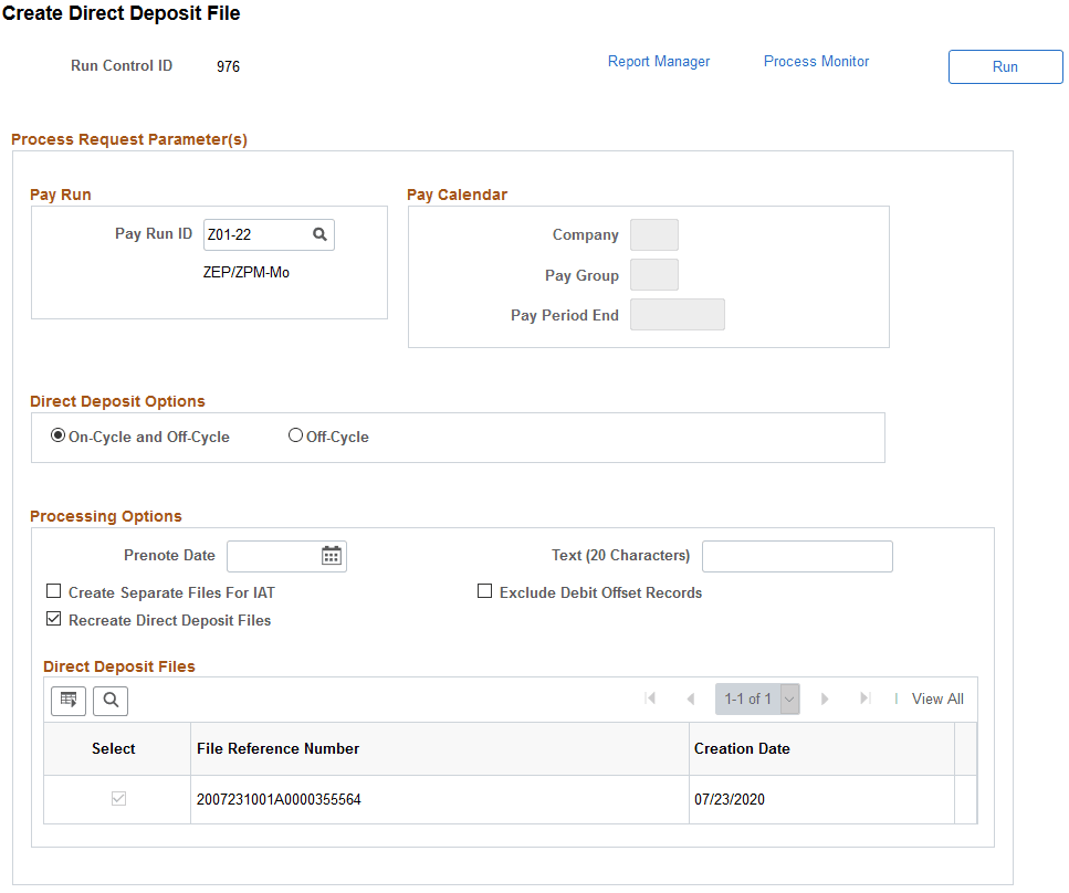

Create Direct Deposit File Page (PY_DIRDEP)
(USA, USF) Use the Create Direct Deposit File page (RUNCTL_DDP001N) to run the Create Direct Deposit Transmit process (PY_DIRDEP), which creates direct deposit transmittal files.
Navigation:
This example illustrates the fields and controls on the Create Direct Deposit File page (PY_DIRDEP).
(USA, USF) This version of the Create Direct Deposit File page (RUNCTL_DDP001N) is displayed when the Create Off-Cycle Files option is selected on the Payroll for NA Installation Page.
(CAN) This page is not applicable to Canadian Payroll.
Important:
While you can run this process multiple times to recreate the direct deposit file for any bank, do not submit the file to the bank more than once a day.
Pay Run or Pay Calendar
Enter either a pay run ID or pay calendar information for the desired pay period.

Recreate Direct Deposit Files
Select this check box to recreate an existing direct deposit file using the specified processing options. This field becomes editable if the system detects one or more direct deposit files for the selected pay run or pay calendar.
When selected, the Direct Deposit Files section appears where you select a generated file to be recreated. The recreated file will include transactions there were previously processed in the selected file, and new ones that are identified during the process run.
When cleared, the system creates direct deposit files for new transactions that have not yet been processed using the specified processing options.
If you select to recreate an existing direct deposit file, be sure to use the same prenote date as before to ensure that the date on the bank file and in the system (PS_DIR_DEP_DISTRIB record) remain in sync.
This section lists the direct deposit files that can be recreated for the specified pay run or pay calendar.
If one file is available, the system selects it by default and the selection is not editable. If multiple files are available, you must select one file to be recreated.
