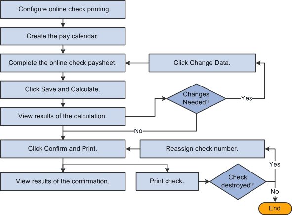

This diagram illustrates the step involved in online check processing from configuring online check printing to the printing of checks.
Diagram showing the step involved in online check processing from configuring online check printing to the printing of checks

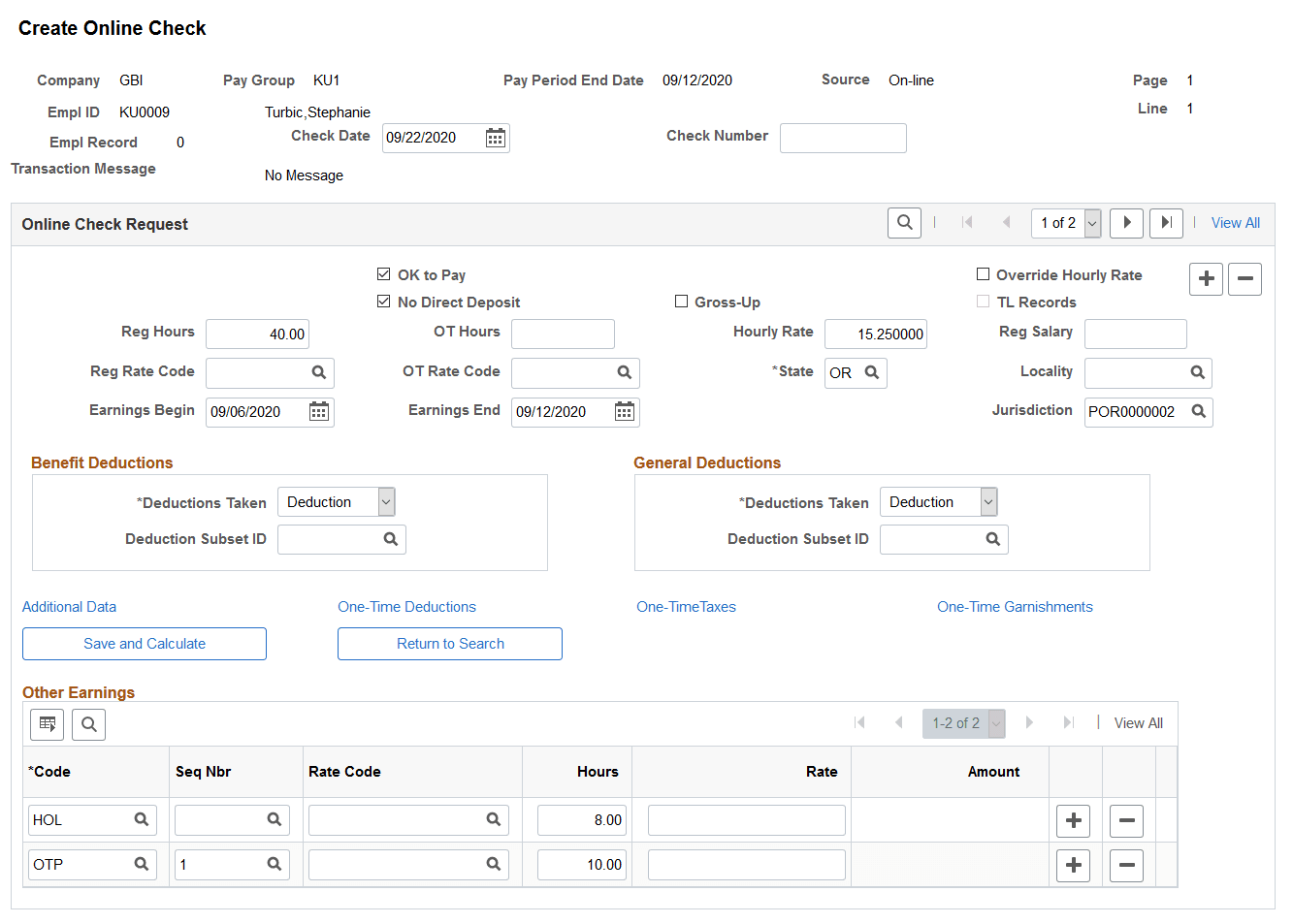

This example illustrates the fields and controls on the Create Online Check page.
Many of the fields on the Create Online Check page are identical to those on the Paysheet page.
WARNING:
If you use the Paysheet Creation process for online checks using the same on-cycle pay calendar that's being processed in batch, the employee receives a duplicate check.
Field or Control Description
Check Number
You can either specify a number or have one assigned by the system.
Benefit Deductions
Benefit Deductions Taken
The initial value comes from the pay calendar, but you can override it.
  • None: Select to specify no benefit deductions.
  • Deduction: Select to have the Deduction table govern benefit deductions.
  • Subset: Select this value if you want to use a specified benefit deduction subset. If you select this value, you must specify the subset ID in the Deduction Subset ID field.
General Deductions
Deductions Taken
  • None: Select to specify no general deductions.
  • Deduction: Select to have the Deduction table govern general deductions.
  • Subset: Select this value if you want to use a specified general deduction subset. If you select this value, you must specify the subset ID in the Deduction Subset ID field.
Additional Page Elements
Save and Calculate
When you're ready to calculate the check, select this button to start the calculation process. The system then displays the Review/Print Online Check page.
Return to Search
If you want to set up a single check for another employee, select Return to Search to redisplay the Create Single Check selection page.

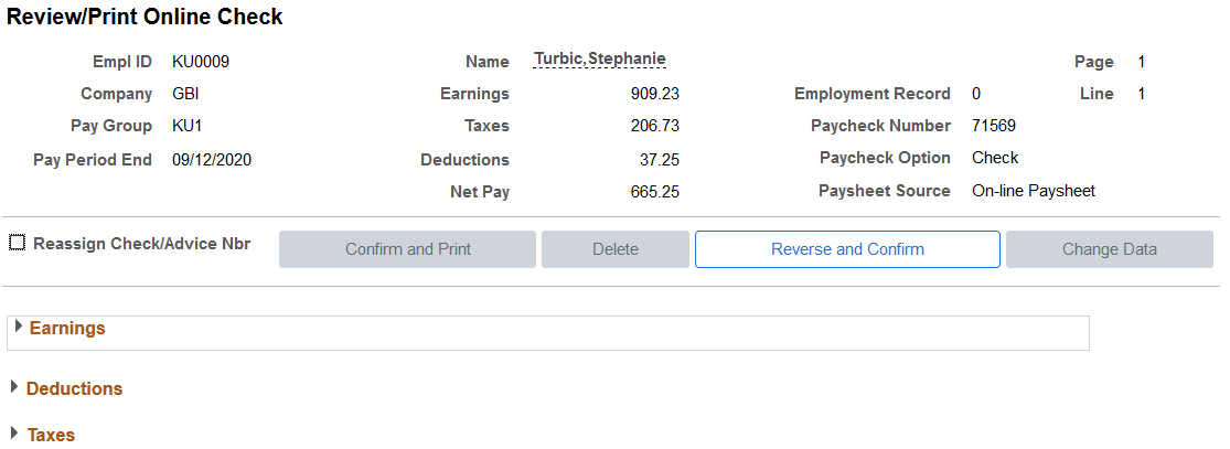

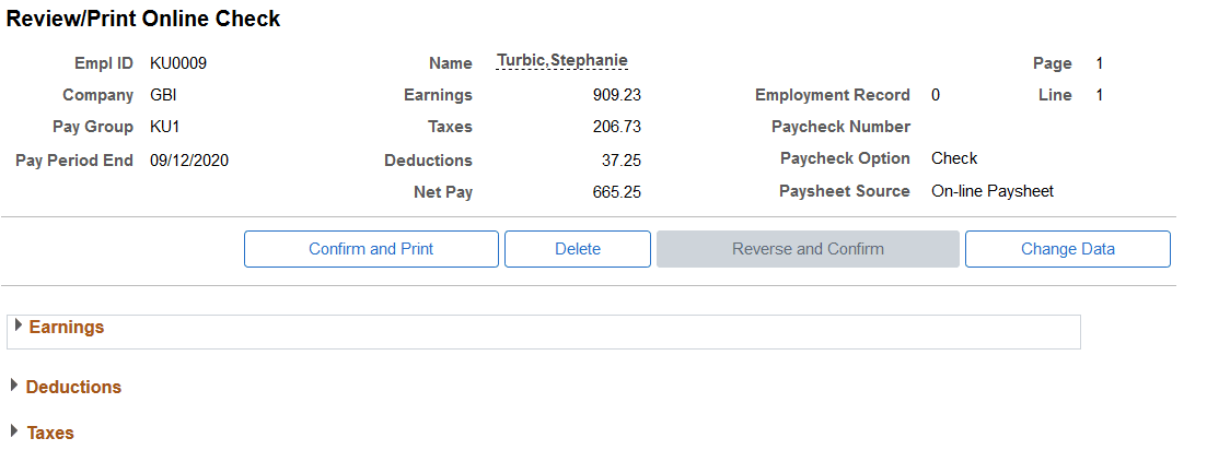

This example illustrates the fields and controls on the Review/Print Online Check page after calculation.
When you select Save and Calculate on the Create Online Check page, the system performs the calculation and displays the Review/Print Online Check page.
You must assign a pay run ID to the appropriate pay calendar. Otherwise, the system cannot find any employee data for online single check processing. The fields on this page are display-only and are based on the data that was entered on the Create Online Check page.
Important:
Any uncalculated or unconfirmed online single checks are automatically calculated or confirmed by an off-cycle pay run if the online check page numbers fall within the range entered for the off-cycle pay run.
Confirm and Print
Select to confirm and print the online check.
Select whether to use BI Publisher to create a PDF paycheck for this employee for self-service viewing. If you select No, the system creates a non-PDF paycheck for the online check using SQR reports.
Note: If you use the BI Publisher process with the View Paycheck transaction in PeopleSoft ePay, the number of days from check date that you specify on the Paycheck Options Table page determines when the employee can view the check online.
After confirming, the system returns you to the Review/Print Online Check page.
Delete
If you fail to confirm and print the online check, you will leave an outstanding paysheet that prevents pay calculation later. Delete the check if you do not complete the process.
Change Data
Select to return to the Create Online Check page to change data and recalculate.

This example illustrates the fields and controls on the Review/Print Online Check page after confirmation.
Reassign Check/Advice Nbr (reassign check or advice number)
If the online check was destroyed while printing, select this check box to reprint the check with a different check number. When you select this check box, the Confirm and Print button becomes available.
Confirm and Print
This button is available if you select Reassign Check/Advice No. Select this button to access the Paycheck Printing/Re-assignment page, where you enter the new check number and select OK to print the check with the new number.
Reverse and Confirm
Select to access the Check Reversal page and run the Check Reversal process. You cannot reverse a single check until it has been confirmed and printed. Until then, this button is unavailable.
