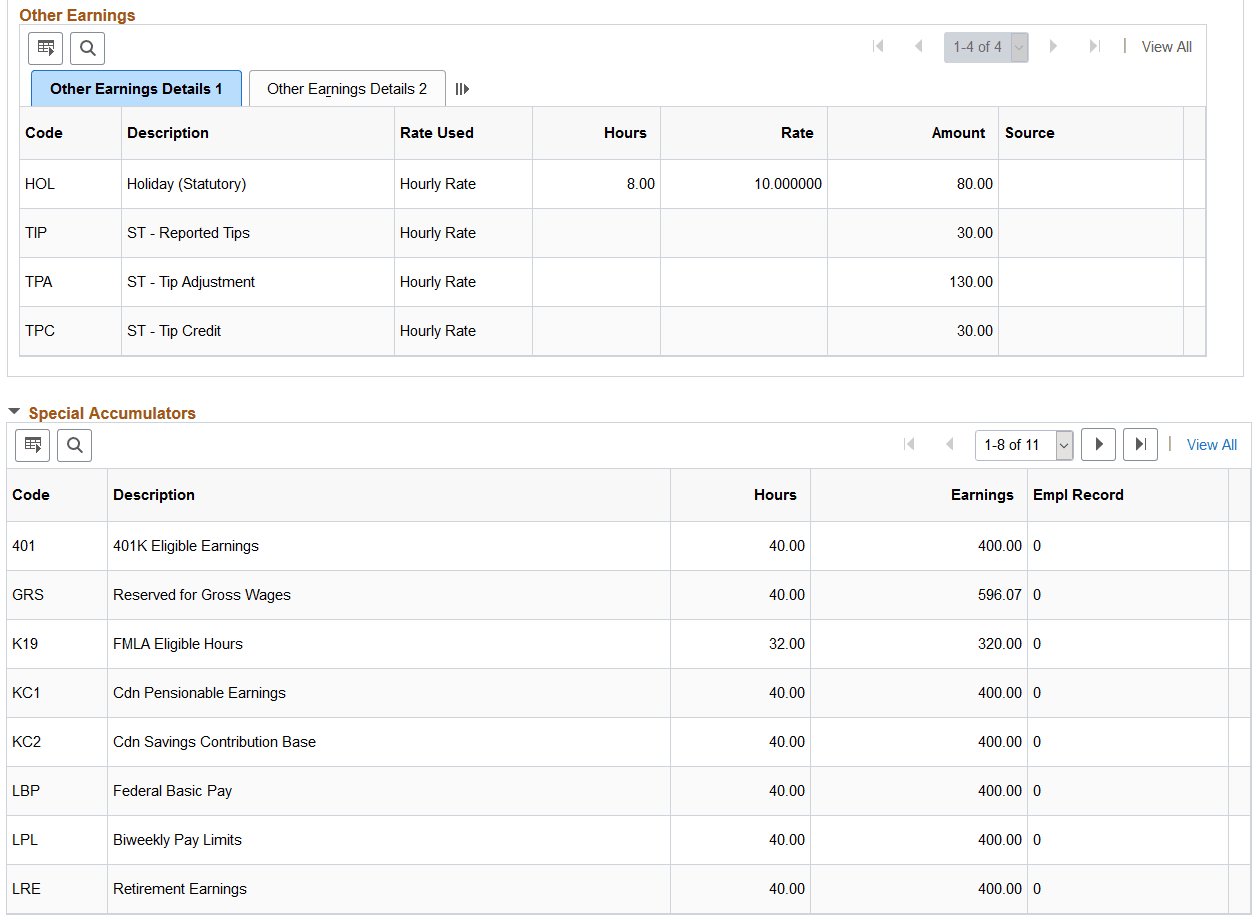

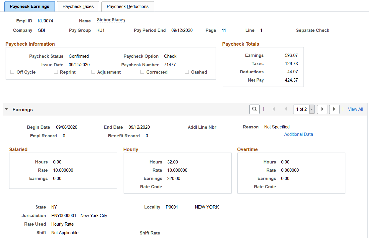

This example illustrates the fields and controls on the Paycheck Earnings page (1 of 2).
This example illustrates the fields and controls on the Paycheck Earnings page (2 of 2).
Paycheck Information
Field or Control Description
Off Cycle
Selected if the payment was processed in an off-cycle payroll.
Reprint
Selected if the Check Reprint COBOL SQL process (PSPRPRNT) was used to renumber the check.
Adjustment
Selected on the reversal check and the adjustment check processed by the Reversal/Adjustment COBOL SQL process (PSPPYREV). If processing a reversal only, this indicator is selected on the check reversal.
Corrected
Selected by the Retro Distribution DB Update PSJob process (HPRETDST) during commitment accounting retroactive distribution processing. This indicator is not related to the payroll adjustment process.
Cashed
Selected by the Check Reconciliation SQR Report process (PAY015A) when the check has been cashed.
(CAN) Province
The province shown on the Paycheque Earnings page is the province of employment.

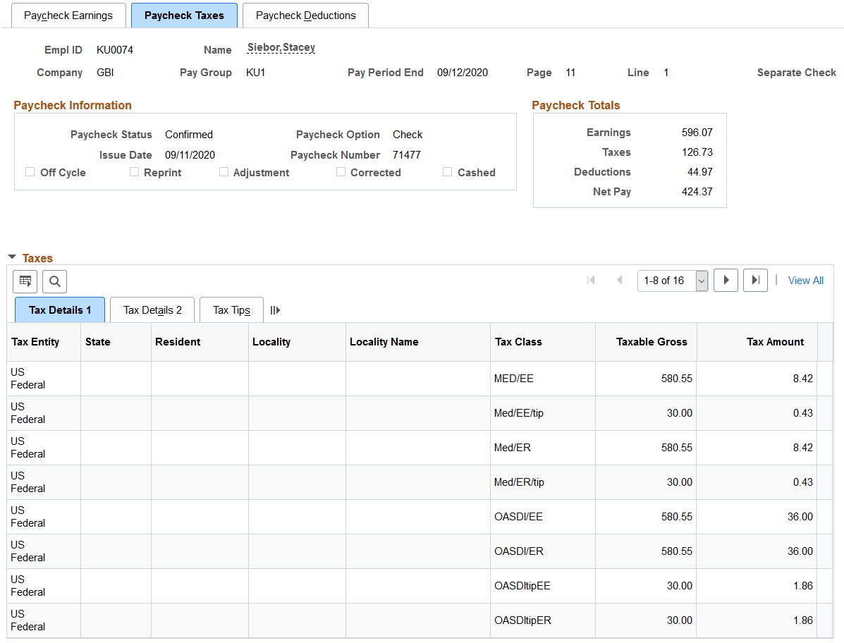

This example illustrates the fields and controls on the Paycheck Taxes page.
Paycheck Taxes page

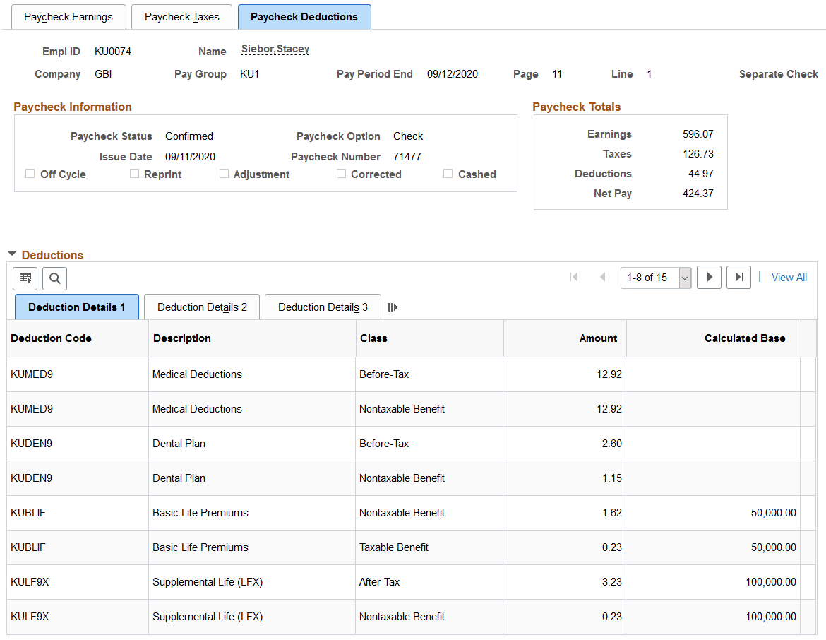

This example illustrates the fields and controls on the Paycheck Deductions page (1 of 2).
This example illustrates the fields and controls on the Paycheck Deductions page (2 of 2).

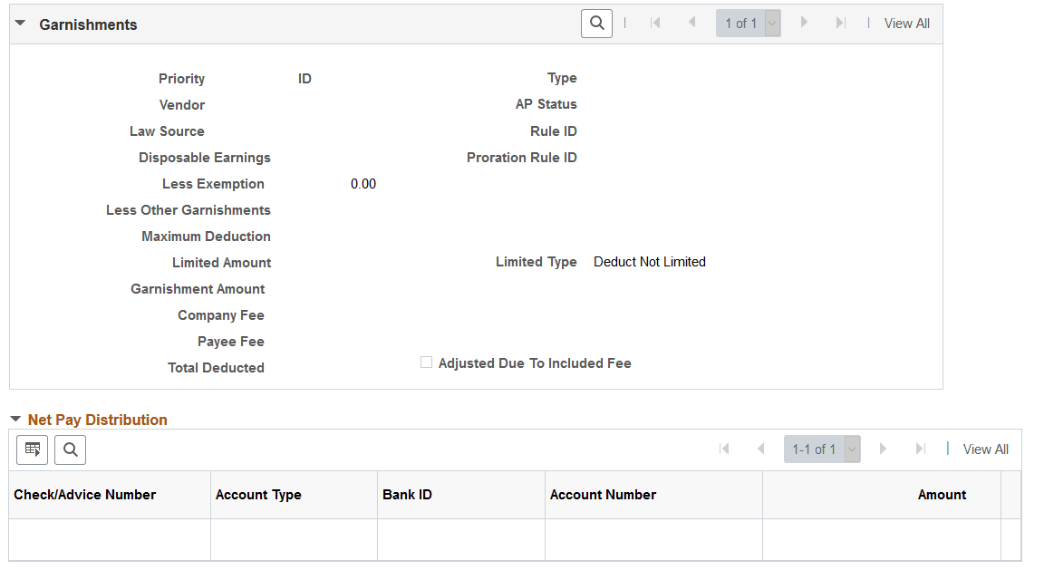

When an employee has child support orders from two or more states, the system uses the Garnishment Proration process to select the maximum deduction that provides the most money for the children. For example, if state A has a maximum deduction of 1200 USD, and state B has a maximum deduction of 900 USD, the system uses the maximum deduction of 1200 USD for both child support orders.
Maximum Deduction
Displays messages indicating the presence or absence of limitations placed on the garnishment after the system calculated the maximum deduction:
Deduct Not Limited: Indicates that no further limitations were placed on the garnishment.
Deduct Limited by Calculation: Indicates that the deduction was limited by one of the deduction calculation amounts or percentages from the Garnishment Spec Data 4 or 5 pages.
Deduct Limited by Total Amount and Deduct Limited by Monthly Amount: Indicate that the system used the limitations from the Garnishment Spec Data 3 page.
Deduction Limited by Proration: Indicates that the deduction was limited by the proration rule displayed in the Prorate Rule ID field.
Adjusted Due To Included Fee
If the system adjusted the calculation for fees included in disposable earnings, this check box is selected. There are two ways the system takes fees:
  • In disposable earnings.
  • On top of disposable earnings.
Specify whether to include the company and payee fees in disposable earnings on the Garnishment Spec Data 3 page.
If the sum of the calculated garnishment amount and the fee is greater than the maximum allowed (disposable earnings minus exemptions), the system makes an adjustment.
If you take the fees on top of the disposable earnings, then the fees that the system takes have no impact on the garnishment amount. For example, if the system determines that you can take a garnishment of 177.00 CAD, and you have fees that are not included in the disposable earnings, then the garnishment amount remains 177.00 CAD.
However, if the order specifies that you take 5.00 CAD for the company fee, but that fee must be included in disposable earnings, then the system adjusts the amount to be garnished and selects the Adjusted Due To Included Fee check box.
If the system has adjusted the garnishment amount based on a percentage of the deduction, the Adjusted Due To Included Fee check box is selected, and the garnishment amount differs from the maximum deduction amount by the amount of the adjustment.

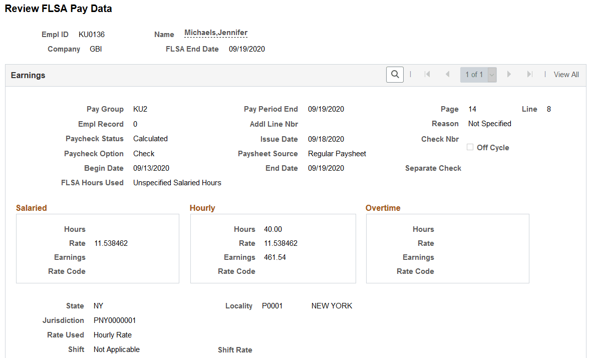

This example illustrates the fields and controls on the Review FLSA Pay Data page (1 of 2).
This example illustrates the fields and controls on the Review FLSA Pay Data page (2 of 2).
