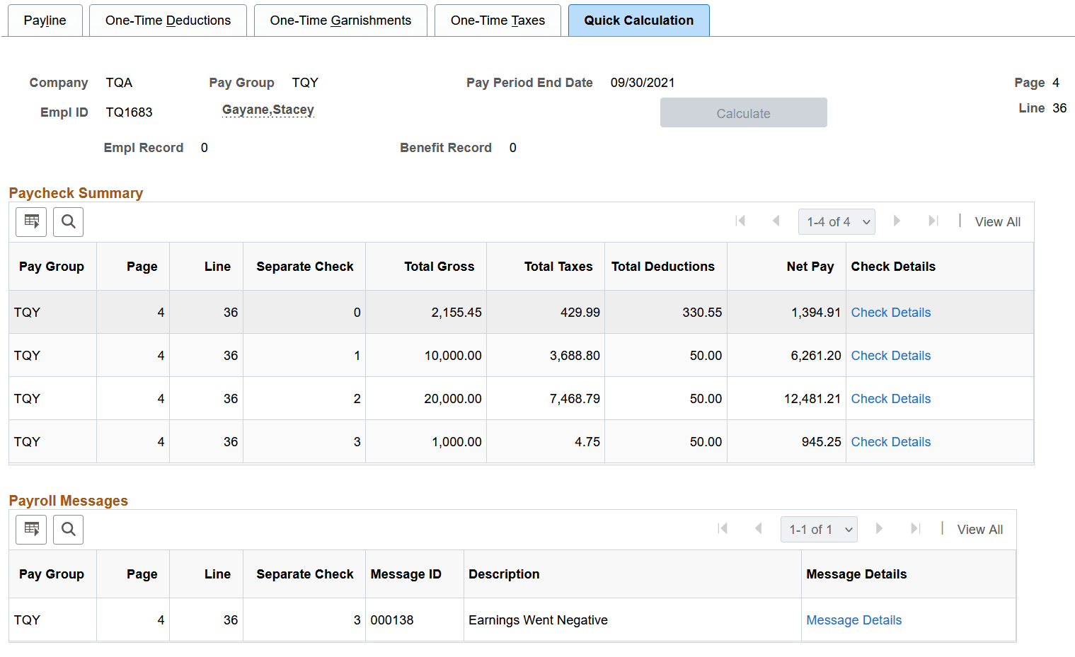

Quick Calculation Page
Use the Quick Calculation page (PAY_SHEET_LINE_Q) to generate and review calculated checks for individual employees.
Navigation:
  • Payroll for North America, and then Payroll Processing USA, and then Update Paysheets, and then By Payline, and then Quick Calculation
  • Payroll for North America, and then Payroll Processing USA, and then Update Paysheets, and then By Payline Security, and then Quick Calculation
  • Payroll for North America, and then Payroll Processing CAN, and then Update Paysheets, and then By Payline, and then Quick Calculation
  • Payroll for North America, and then Payroll Processing CAN, and then Update Paysheets, and then By Payline Security, and then Quick Calculation
  • Payroll for North America, and then Payroll Processing USF, and then Update Paysheets, and then By Payline, and then Quick Calculation
  • Payroll for North America, and then Payroll Processing USF, and then Update Paysheets, and then By Payline Security, and then Quick Calculation
This example illustrates the fields and controls on the Quick Calculation page after the check has been calculated.
When you select the Calculate button, payroll calculation runs in the background for a single employee. Paycheck results are displayed at the end of the calculation.
Field or Control Description
Calculate
Select this button for the system to calculate the paycheck using employee's earnings, deduction, and tax information from the paysheet.
After the Quick Calculation feature is enabled in the setup, the Calculate button becomes available after the creation of paysheets. It becomes unavailable after the pay calculation or quick calculation is run. It is available again after a change is made to the employee-level data (for example, compensation rate update on Job) or the payline. Payline change can be a manual update on the Payline page, or an update as a result of paysheet data load from different sources, such as the Load Paysheets processing, Load Time and Labor processing, and so on.
After the final calculation is run, this button becomes unavailable permanently if the Disable Calculate button after Final Calculation option is selected. For more information, refer to the Setting Up Quick Calculation topic.
Paycheck Summary
This section displays the summary and details of the calculated paychecks. It appears after the quick calculation is completed.
Paycheck information is no longer available in this section if the payline that was used to calculate the paycheck has been modified.

Check Details
Select to view the detailed paycheck data for the employee on the Review Paycheck pages that appear.
See Also Paycheck Earnings Page, Paycheck Taxes Page, and Paycheck Deductions Page.
Payroll Messages
This section displays error messages generated during the payroll processing. Select the Message Details link to view the details on the Review Payroll Error Messages Page.

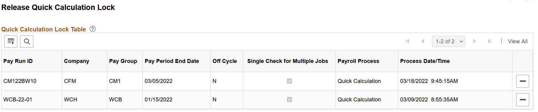

Release Quick Calculation Lock Page
Use the Release Quick Calculation Lock page (PY_QCALC_LOCK_TBL) to delete unsuccessful payroll processes from the lock table.

This example illustrates the fields and controls on the Release Quick Calculation Lock page.
Pay Run ID
Displays the pay run ID that is associated with the company and paygroup of the employee being processed.
Company, Pay Group, Pay Period End Date, and Off Cycle
Displays the corresponding values that are associated with the employee.
Single Check for Multiple Jobs
Displays as selected, if the field of the same name is selected on the Application Fundamentals: Default Settings Page for a company that is associated with the pay run ID.
Payroll Process
Displays the payroll process that was launched, Payroll Calculation or Quick Calculation.
Delete row icon
Select the Delete button to release the lock for all companies and paygroups that are associated with the specified pay run ID.
