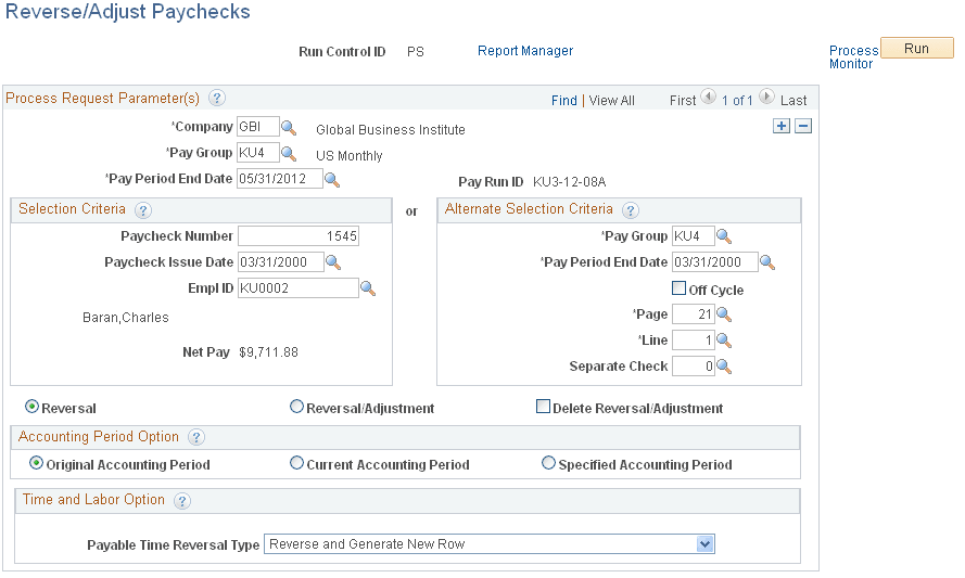

This example illustrates the fields and controls on the Reverse/Adjust Paychecks page.
The page is the same for reversals and adjustments.
You can process a single reversal or adjustment to a paycheck with zero net pay. A check number is not required. However, if you need to process more than one zero net check (without a check number), you must process those reversals or adjustments one at a time.
Field or Control Description
Run Control ID
For every Reverse/Adjust Paychecks run control you enter, the system sets up a separate off-cycle paysheet page and line.
Company, Pay Group and Pay Period End Date
The pay period end date corresponds to the on-cycle pay calendar with which you want to process the reversal or reversal/adjustment. Check reversals cannot be run if the pay run ID for the specified pay period end date is blank on the Pay Calendar table. Also, the reversal must be associated with a pay calendar that is not closed for off-cycle processing.
Paycheck Number and Paycheck Issue Date
If you know the check number and issue date, you can search for the corresponding check to be reversed.
Pay Period End Date, Off Cycle, Page and Line
If you do not know the check number and issue date, you can locate the check by searching for these values in the fields in the right column.
Separate Check
If the check to be reversed was issued as a separate check, enter a value here.
You can also find the paycheck number and paycheck issue date information either online or off-line:
Online: Use the Paycheck Data pages.
Off-Line: Refer to your Payroll Register or Payroll Check Register reports.
Reversal
Select for a check reversal.
Reversal/Adjustment
Select for a check reversal and an adjustment check.
Delete Reversal/Adjustment
To delete an unwanted reversal or reversal/adjustment, set up a run control with this option selected and run the Paycheck Reversal/Adjustment process.

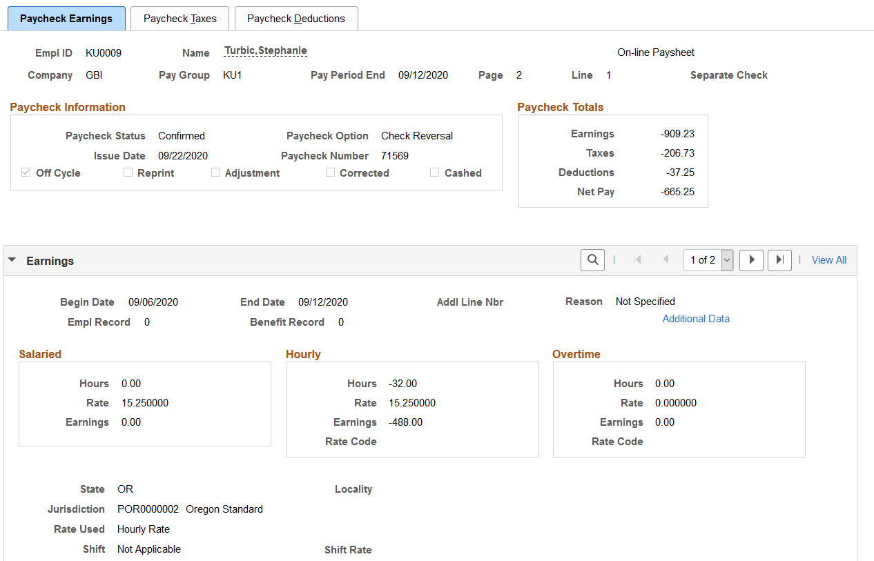

This example illustrates a reversed check on the Paycheck Earnings page (1 of 2).
Reversed check on the Paycheck Earnings page (1 of 2)

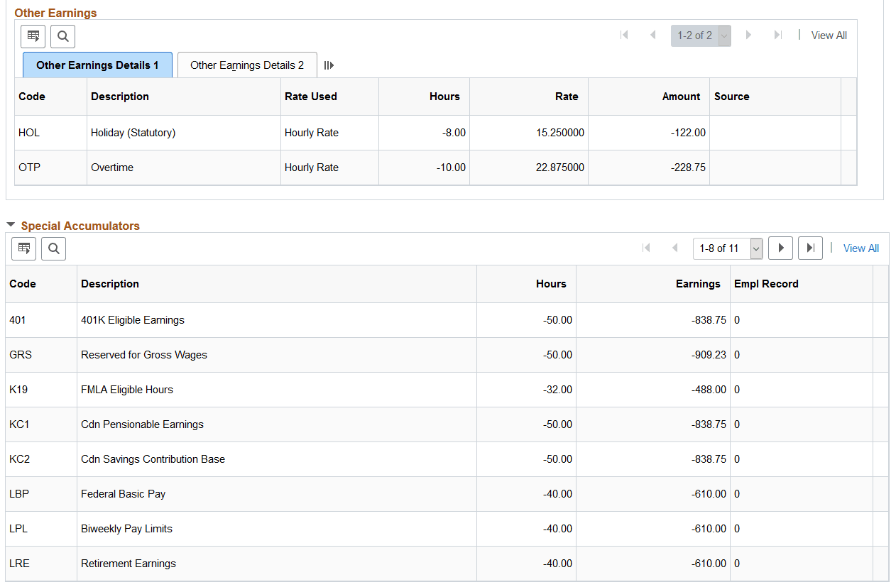

This example illustrates a reversed check on the Paycheck Earnings page (2 of 2).
Reversed check on the Paycheck Earnings page (2 of 2)
You can view the effects of the reversal by looking at the original check and the reversed check on the Paycheck Earnings page.
On the reversed check, all of the amounts display as negative numbers. The paycheck option is set to Check Reversal.
