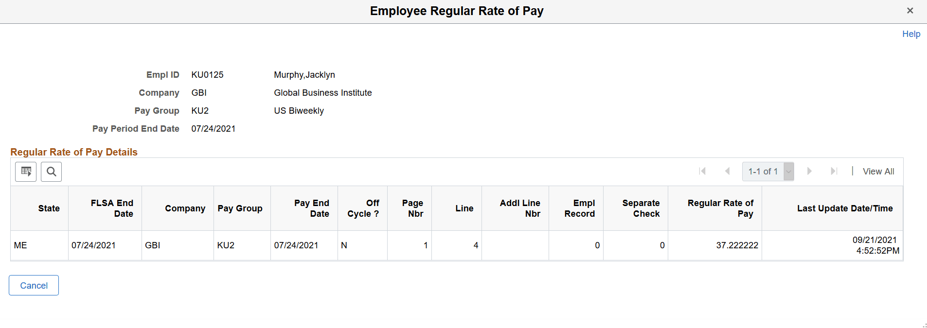

Regular Rate of Pay
1675 USD / 45 = 37.22 USD
The system calculates the employee's regular rate of pay because the number of total hours worked exceeds 40. The regular rate of pay is calculated by dividing the total earnings for the week by the total hours worked, which is 37.22 USD.
This example illustrates the calculated regular rate of pay for the FLSA period on the Employee Regular Rate of Pay page (example 2).
Calculated regular rate of pay for example 2

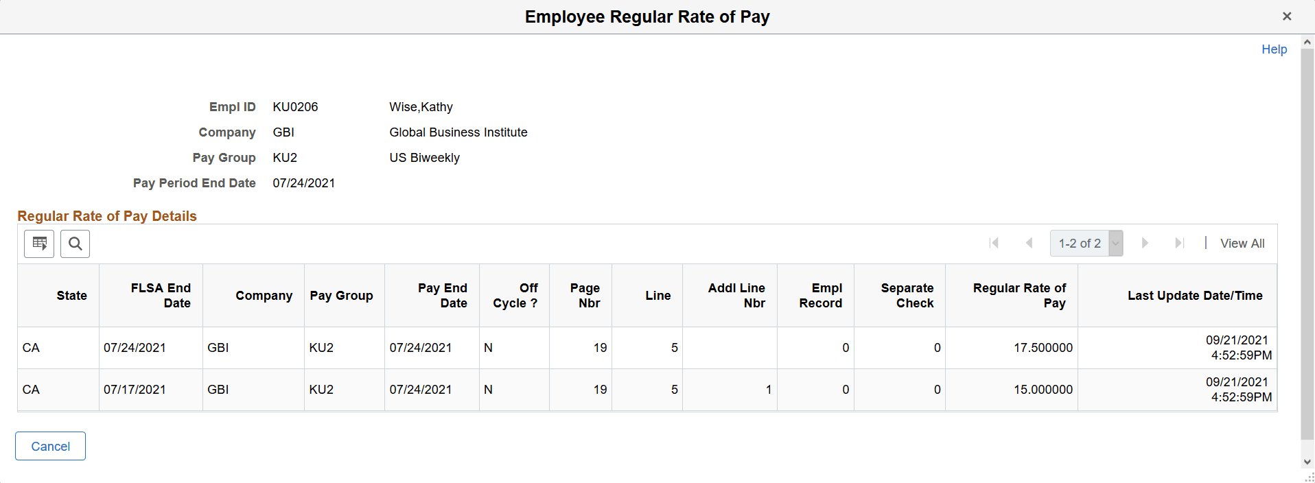

In the second week's example, the employee had a 100 USD bonus and the calculated regular rate of pay is 17.50 USD.
This example illustrates the calculated regular rates of pay for both FLSA periods on the Employee Regular Rate of Pay page (example 3).
Calculated regular rate of pay for example 3

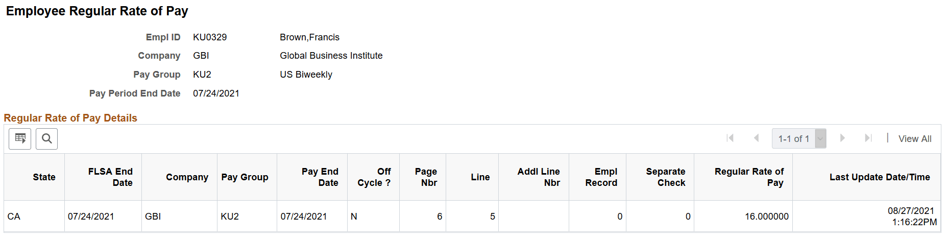

Example 4: Include Overtime Premium Calculation for California Employee Working 40 Hours a Week
In this example, the employee in California worked for 40 hours in the 7-day FLSA period, and had a flat sum bonus. The selected calculation routine for California is Include Overtime Premium.
California is set up on the Alternative Overtime State Table page. The employee's FLSA status is Nonexempt Alternative Overtime.
Pay Information Value
Current Pay Period
July 11, 2021 – July 24, 2021
FLSA Period
July 18, 2021 – July 24, 2021
State
CA
Calculation Routine for State
Hourly Rate
16 USD
Regular Hours
40
Flat Sum Bonus
100 USD
Overtime Premium
(Flat Sum Bonus / Regular Hours)
100 USD / 40 = 2.50 USD
Regular Rate of Pay
(Hourly Rate + Overtime Premium)
16 USD + 2.50 USD = 18.50 USD
The regular rate of pay is calculated by adding the hourly rate and overtime premium, which is 18.50 USD.
This example illustrates the calculated regular rate of pay for the FLSA period on the Employee Regular Rate of Pay page (example 4).
Calculated regular rate of pay for example 4

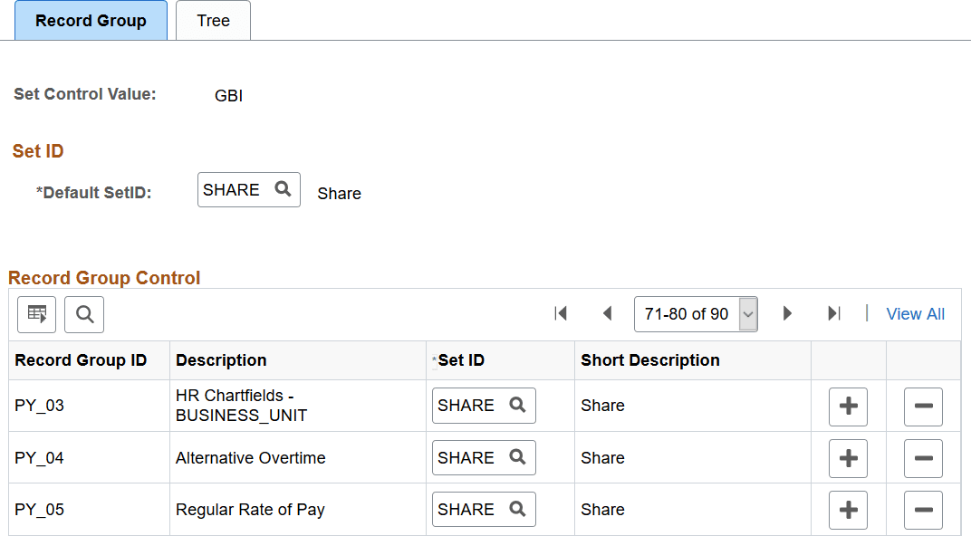

  1. Select an setID for the PY_05 record group on the Record Group page (SET_CNTRL_TABLE1) to match the setID that you use for the regular rate of pay setup on the Regular Rate of Pay Control Page.
    This example displays the record groups and their setIDs for GBI on the Record Group page. The setID for the PY_05 record group is SHARE, the same setID that is also used in the regular rate of pay setup.
    Selecting a setID for the PY_05 record group on the Record Group page

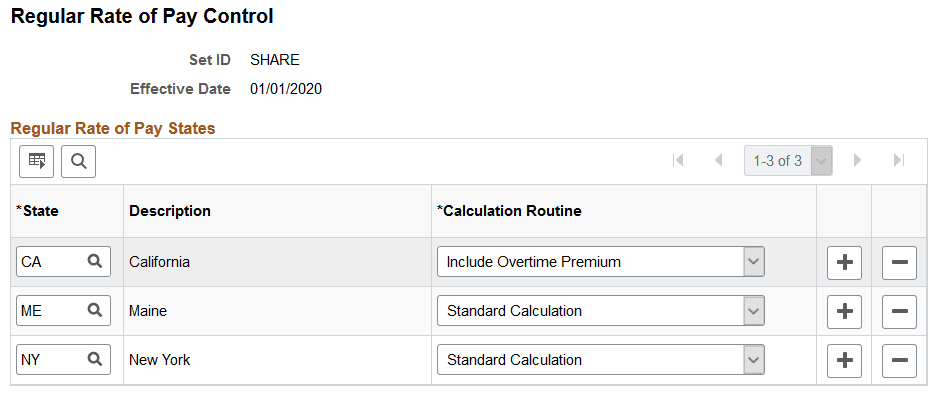

  2. Specify the states that require employees’ regular rate of pay to be calculated for non-overtime pay and the applicable calculation routine on the Regular Rate of Pay Control Page. The Pay Calculation process uses the setID of the company on the payline to determine if the state needs the regular rate of pay calculation as of the earnings end date.
Use the Regular Rate of Pay Control page (PY_REG_RT_TABLE) to specify the states that require regular rate of pay calculation for non-overtime pay.
Navigation:
Set Up HCM, and then Product Related, and then Payroll for North America, and then Payroll Processing Controls, and then Regular Rate of Pay Control, and then Regular Rate of Pay Control
This example illustrates the fields and controls on the Regular Rate of Pay Control page.
The SHARE setID is delivered as sample data showing the states that use the regular rate of pay to calculate non-overtime pay for non-exempt employees. This screenshot displays state information for illustration purposes. Update information on this page to support your organization's alternative overtime business rules.
Field or Control Description
State
Specify the state that requires regular rate of pay calculation.
Calculation Routine
Select the applicable calculation routine for the state. Values are:
Include Overtime Premium: Select this option if the state, for example, California, requires the regular rate of pay to include the overtime premium/regular bonus rate. This calculation routine factors a flat sum bonus that an employee receives into their regular rate of pay by:
Amount of the bonus / total number of non-overtime hours worked during the work period
Standard Calculation (default value)
