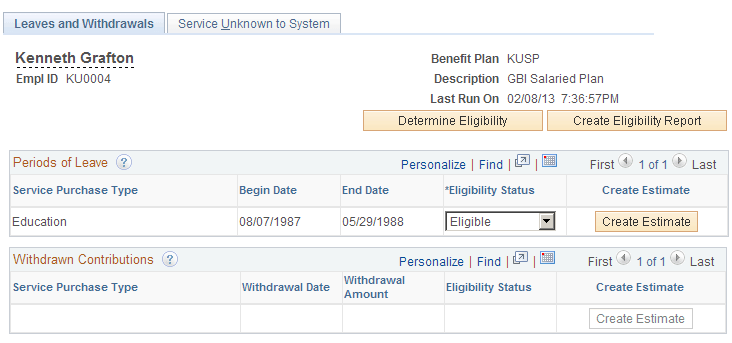

Leaves and Withdrawals Page
Use the Leaves and Withdrawals page (PA_SP_STP_PERIODS) to:
  • Identify an employee’s leave periods based on data from the PeopleSoft Human Resources system.
  • Identify an employee’s contribution withdrawals based on data from the pension system.
Navigation:
Pension, and then Service Purchase, and then Select Purchasable Service, and then Leaves and Withdrawals
This example illustrates the Leaves and Withdrawals page.
Read-only fields at the top of the page identify the employee and plan for which you are identifying purchasable service.
Field or Control Description
Last Run On
Displays the date and time that you last ran the eligibility process.
Determine Eligibility
Click this button to run the eligibility process for each service purchase type shown in the component, including those on this page and on the Service Unknown to System page. Eligibility processes for specific plans and service purchase types are defined on the Service Purchase Configuration - Eligibility Page.
Create Eligibility Report
This button becomes active after you run the eligibility process by clicking the Determine Eligibility button.
Click the Create Eligibility Report button to generate a letter to the employee summarizing the eligibility for the service purchase types shown in this component. The letter includes information about periods of leave, withdrawn contributions, and service unknown to the system.
This letter is a report that is generated using Oracle Business Intelligence Publisher (BI Publisher). The report definition is SPELIGLTR.
Periods of Leave
The system populates the Periods of Leave grid by comparing the employee’s action/reason history to the actions and reasons for the plan’s service purchase types, as configured on the Service Purchase Type Page.
Displays the service purchase type for the leave period in the employee’s action/reason history.
Begin Date and End Date
Displays the beginning and ending date of the leave period as established by the employee’s action/reason history.
Eligibility Status
Initially, the Eligibility Status is Undetermined. When you click the Determine Eligibility button, the system changes this value to either Eligible or Ineligible.
If the Eligibility Override Allowed check box is selected on the Service Purchase Configuration - Eligibility page, this field is editable. Otherwise, it is read-only.
Create Estimate
If a leave period is determined to be eligible for service purchase, the Create Estimate button becomes active. Clicking this button creates a new service purchase record and transfers you to the Purchase Service page, where you can calculate costs and benefits and create and manage service purchase estimates.
Withdrawn Contributions
The system populates the Withdrawn Contributions Leave grid by looking at the employee’s withdrawal subaccount under the plan’s employee account. Only withdrawals that resulted in forfeited service are shown.
Displays Withdrawn Contributions, which is the delivered service purchase type for contribution withdrawals.
Withdrawal Date
Displays the date that the employee withdrew contributions.
Withdrawal Amount
Displays the amount of money withdrawn.
Eligibility Status
Create Estimate
If a withdrawal of contributions is determined to be eligible for service purchase, the Create Estimate button becomes active. Clicking this button creates a new service purchase record and transfers you to the Service Purchase page, where you can calculate costs and benefits and create and manage service purchase estimates.

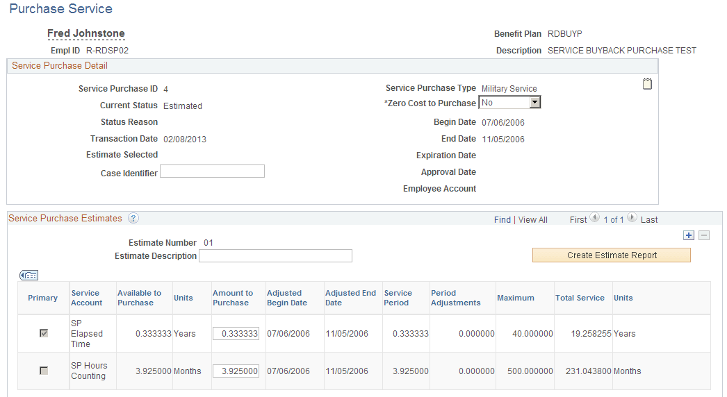

Purchase Service Page
Use the Purchase Service page (PA_SP_SVC_COST_BEN) to administer a service purchase transaction.
Navigation:
  • To create a service purchase transaction, click the Create Estimate button on the Leaves and Withdrawals page or the Service Unknown to System page.
  • To manage an existing service purchase transaction, select Pension, and then Service Purchase, and then Purchase Service
This is the first of two examples illustrating the Purchase Service page. In this example, the grid that lists service is showing all columns. However, it is a tabbed grid in default state.
Purchase Service page (1 of 2)
This is the second of two examples illustrating the Purchase Service page.
Purchase Service page (2 of 2)
All fields on this page become read-only when the status changes from Estimate to Submitted.
Service Purchase Detail
Service Purchase ID
Displays the system-generated unique identifier for the service purchase transaction.
Current Status
Displays the status of the service purchase transaction. You can manually set this status using the Status field at the bottom of this page.
See The Lifecycle of a Service Purchase Transaction.
Status Reason
Displays the status reason for the current status. To manually assign a reason, use the enterable Status Reason field at the bottom of this page.
Transaction Date
Displays the date this service purchase transaction was created.
Estimate Selected
A service purchase transaction can have multiple estimates that model different options. Only one estimate, however, can be submitted. When you submit an estimate, the Estimate Selected field displays the numeric identifier of the submitted estimate.
Displays the service purchase type for the transaction.
Zero Cost to Purchase
This field is visible only if the Allow Zero Cost check box is selected on the Service Purchase Configuration - Cost Page. The initial value is No, but you can change the value to Yes to reinstate service at no cost to the employee.
When you select Yes, the Service Purchase Cost field on this page becomes read-only and displays a zero value. Service adjustments are automatically applied when the status of the purchase is updated to Elected, and after the service adjustments are applied, the system updates the status to Complete.
Displays the beginning and ending date of the leave period for which the employee is purchasing service. If the service purchase type is Withdrawn Contributions, these fields are blank.
Expiration Date
Displays the date when the service purchase estimate is no longer valid if it has not yet been elected.
The system sets the expiration date at the time the estimate is submitted. The length of time that an estimate remains valid after submission is determined by the Expiration Duration fields on the Service Purchase Configuration - Parameters Page.
Approval Date
Displays the date, if any, that the service purchase was put into Approved status.
Employee Account
After the service purchase transaction is submitted, this field displays the employee account where purchase payments are entered. This account is a service purchase account or a withdrawal account, depending on the service purchase type.

Service Purchase Estimates
A service purchase transaction can have multiple estimates that model different service, cost, and payment options.
Estimate Number
A service purchase transaction can have multiple estimates that model different options. This field displays the numeric identifier that the system assigns to each estimate.
Estimate Description
Enter a description of each estimate.
Create Estimate Report
Click this button to generate an estimate report for the employee. This report summarizes the employee’s service amount, the benefit amount with and without the service purchase, the cost of purchasing the service, and payment information for purchasing the service.
This letter is a report that is generated using Oracle BI Publisher. The report definition is SPESTRPT.
Service for Periods of Leave
If the service purchase type is for a period of leave, service information appears in a grid that, in its default state, has tabs for Service to Purchase, Service Details, and Overall Service.
The system populates this grid with a list of the service function results used for this service purchase type, as shown on the Service Purchase Configuration - Eligibility page.
Primary
This read-only check box is selected for the service function result that is used in the plan’s benefit calculation.
Service Account
Displays the name of the service function result.
Available to Purchase and Units
Displays the amount of service that is available to purchase.
Amount to Purchase
Displays the amount of service to be purchased. This field is editable if the Allow Service Override check box is selected on the Service Purchase Configuration - Parameters page. If overrides are not allowed, the amount to purchase is always the same as the amount available to purchase.
Changing the amount to purchase clears related information from the estimate, including cost information and the benefit amount with the purchased service.
Adjusted Begin Date and Adjusted End Date
Displays the adjusted begin and end dates of the leave period. These dates might be different from the actual leave dates depending on the plan rules regarding service accrual during leave periods. For example, a plan may grant service through the end of the month when an employee goes on leave, even if the leave starts mid-month. In this scenario, the adjusted begin date is the first day of the following month, and the time from the leave date through the end of the month would not be available for purchase.
Service Period
Displays the total service represented by the adjusted leave period dates for this function result.
Period Adjustments
Displays the total amount of service already purchased back for this period. The system calculates this amount based on:
  • Service purchased through other service purchase transactions in Elected, Payment in Progress, or Complete status.
  • Service recorded on the Upgrade Existing Purchases page for the same leave period.
Maximum
Displays the maximum amount of service allowed by the service definition.
Total Service and Units
Displays the employee’s total service for the service function result.

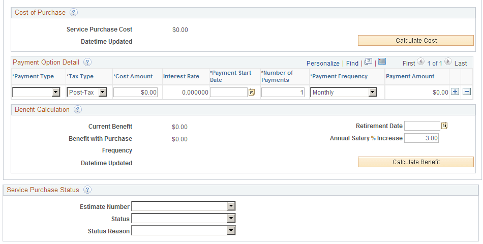

Cost of Purchase
Displays the cost to purchase the amount of service shown in the Amount to Purchase field. The system populates this field when you click the Calculate Cost button, and clears the data if you change the amount of service to purchase.
This field is editable if the Allow Cost Override check box is selected on the Service Purchase Configuration - Cost page.
If the Zero Cost to Purchase field is visible with a value of Yes, the Service Purchase Cost field is read-only and shows a zero amount.
Datetime Updated
Displays the date and time that the Service Purchase Cost field was last updated, either by the system or (if overrides are allowed) by manual entry.
Calculate Cost
Click to calculate the cost to purchase the amount of service shown in the Amount to Purchase field. Cost is calculated using the method specified on the Service Purchase Configuration - Cost page. If the calculation method is Use Calculation, default calculation parameters come from the Cost Calculation Defaults Page.
Payment Option Detail
Enter payment information in this grid. The system calculates the amount of each payment.
Payment Type
The payment type options depend on settings on the Service Purchase Configuration - Payments page, and can include a lump sum payment, installment payments, or payments made through payroll deductions.
Select Lump Sum if the employee will make a single lump payment.
Select Installments if payments will be made over a predefined number of payment periods.
Select Deductions if payments will be made through payroll deductions. If this payment method is used, you must manually enter the deduction into the payroll system to start payments. The pension system will establish corresponding balances in the employee’s service purchase account, and deductions will be credited to the account in the same way that regular pension contributions are credited to employee accounts.
Note: When Payroll for North America processes the general deduction, it does not check the remaining balance in the withdrawal account. Therefore, to ensure that you stop taking deductions after the entire balance is repaid, you may want to set up the deduction with a target amount. As interest accrues on the account, you may have to increase the target.
Create additional rows in the Payment Option Detail grid to set up combination options. For example, an employee could pay half the cost with an initial lump sum payment and the other half in periodic installments.
Tax Type
Select Pre-Tax or Post-Tax to indicate whether payments will be made with pre-tax or post-tax money. This information is necessary so that the employee account can accurately track pre-tax and post-tax contributions, which affects the tax treatment of the employee’s eventual benefit.
Cost Amount
Enter the amount to be paid using the specific payment method. The total cost amount across all rows in this grid must equal the service purchase cost. If the Service Purchase Configuration - Payments page specifies a minimum amount for a particular payment method, the system validates that this minimum is met.
Interest Rate
Displays the default interest rate that is configured for this payment method on the Service Purchase Configuration - Payments page. If the Override Interest Rate check box is selected on the Service Purchase Configuration - Payments page, this field is editable.
Payment Start Date
Enter the date of the first payment (or, for lump sum payments, the date of that payment).
Number of Payments
If the payment type is Deductions or Installments, enter the number of payments across which the cost is spread.
If the payment type is Lump Sum, this field is read only and displays the value 1.
Payment Frequency
If the payment type is Deductions or Installments, select one of the following as the payment frequency: Weekly, Biweekly, Monthly, Semimonthly, Quarterly, Annual, or Onetime Payment.
If the payment type is Lump Sum, this field is read only and displays the value Onetime Payment.
Payment Amount
The system calculates and displays a payment amount based on the payment options you entered.
Benefit Calculation
Click the Calculate Benefit button to display information about the employee’s pension benefit with and without the purchased service.
Current Benefit
Displays the employee’s pension benefit without the purchased service.
Benefit With Purchase
Displays the employee’s pension benefit with the purchased service. The system clears this value if you change the service to purchase amount.
Frequency
Displays the frequency for both the current benefit and the benefit with purchase.
Datetime Updated
Displays the date and time that the benefit amounts were last calculated.
Retirement Age(YY.MM)
This field is visible if the Event Age/Date Option on the Service Purchase Configuration - Benefit Page is Age.
Enter the employee’s assumed retirement age to use in the calculation. Enter the age in years and months using the format YY.MM where YY is years and MM is months.
Retirement Date
This field is visible if the Event Age/Date Option on the Service Purchase Configuration - Benefit Page is Date.
Enter an assumed retirement date to use in the benefit calculation.
If the Event Age/Date Option on the Service Purchase Configuration - Benefit page is Date Alias, the alias provides the date and it is not necessary to enter either an age or date on the service purchase transaction.
Annual Salary % Increase
This field is visible if the Allow User Salary Increase check box is selected on the Benefit Amount Calc Defaults Page. Optionally enter an assumed rate of salary increase to use in the benefit calculation.
Calculate Benefit
Click to calculate the employee’s benefit with and without the service purchase. Cost is calculated using the method specified on the Service Purchase Configuration - Benefit page. If the calculation method is Use Calculation, default calculation parameters come from the Benefit Calc Defaults page.
Service Purchase Status
Estimate Number
This field is visible only if the current status is Estimated. Before you update the status to Submitted, use this field to specify the estimate number that are submitting.
Status
Update the status of the service purchase transaction to move the transaction through the service purchase process. The values available in the Status field depend on the current status, as described in the topic The Lifecycle of a Service Purchase Transaction.
Status Reason
Optionally select a reason for the status assignment. Reasons for each status are configured on the service purchase Status Reasons Page
Refund Payments
If the Allow Refund check box on the Service Purchase Configuration - Payment Options Page is selected, this field appears when you select the status Canceled for a transaction that is currently in Receiving Payments status. Before you can cancel the transaction, you must select Yes or No to indicate whether payments are to be refunded.
