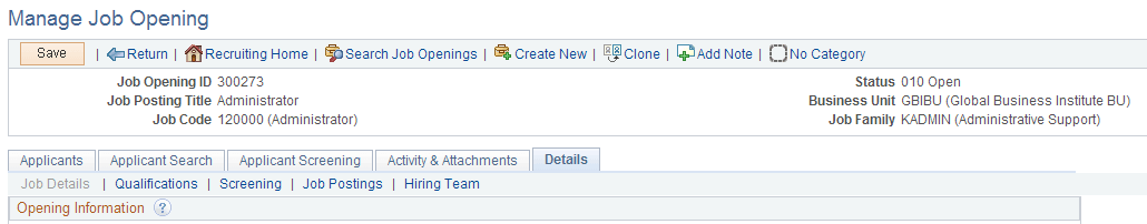

At runtime, the system renders template pages differently depending on whether the user is adding a new job opening or accessing an existing job opening:
  • If a user is creating a new job opening, the template pages appear as tabs on the Job Opening page.
  • If a user accesses an existing job opening, template pages are rendered as section links under the Job Opening Details tab.
    After a job opening is created, the Job Opening page has additional tabs for managing applicants and tracking recruiting activities. Therefore, the actual job opening data is consolidated under a Job Opening Details tab, and the template pages are pushed down one level in the display hierarchy.
In the following examples, the job opening template defines five pages: Job Details, Qualifications, Screening, Job Postings, and Hiring Team. The first image shows the Job Opening page during the job opening creation process. The second image shows the Job Opening page after the job opening is created.
This illustration shows the five pages from the job opening template rendered as tabs on the Job Opening page during the job opening creation process.
Job opening template pages when creating a new job opening
This illustration shows the five pages from the job opening template rendered as subsections of the Job Opening Details tab on the Job Opening page, after the job opening has been created.
Job opening template pages when viewing an already-created job opening

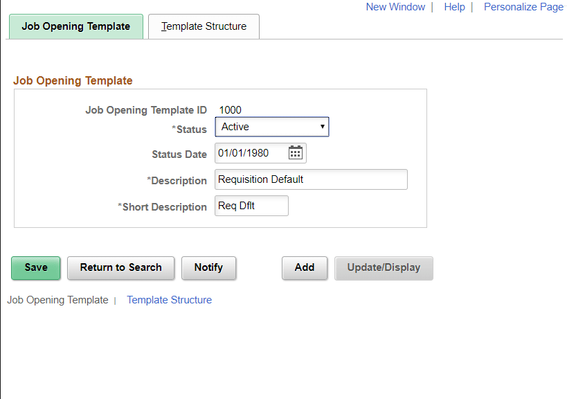

Job Opening Template Page
Use the Job Opening Template page (HRS_JO_TMPL_DESCR) to identify job opening templates.
Navigation:
Set Up HCM, and then Product Related, and then Recruiting, and then Templates, and then Job Opening Template, and then Job Opening Template
This example illustrates the Job Opening Template page.
Field or Control Description
Job Opening Template ID
Template IDs are automatically assigned when you create the template.
Status and Status Date
Indicate whether the definition is Active or Inactive and the date that the status was assigned. Only active templates are available for selection in recruitment templates. The system displays a warning if you attempt to inactivate a template that is used in a recruitment template.
Description
Enter an identifying name for this template A descriptive name helps you when you reference the template from within a recruitment template.

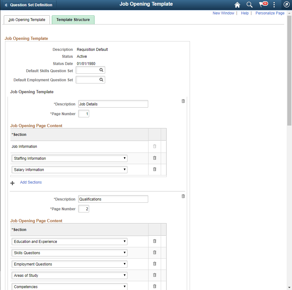

Template Structure Page
Use the Template Structure page (HRS_JO_TMPL_STRUCT) to configure the availability and organization of job opening data.
Navigation:
Set Up HCM, and then Product Related, and then Recruiting, and then Templates, and then Job Opening Template, and then Template Structure
This example illustrates the Template Structure page.
This illustration shows only part of the page.
Default Skills Question Set
Optionally, enter a Skills question set whose questions will be automatically loaded into job openings that you create using this template. Users can still add and remove questions from the job opening, this option simply streamlines data entry when you use a standard set of Skills questions for all job openings based on the template.
Changes made to the Skills question set, or the association of a different question set ID with the template, will not impact job openings that have already been created. Any changes to the template or the Skills question set will apply to new job openings only.
Note: When a job opening is cloned, the new job opening does not load Skills questions from this default question set. Instead, the system copies the Skills questions from the original job opening.
Default Employment Question Set
Optionally, enter an Employment question set whose questions will be automatically loaded into job openings that you create using this template. Users can still add and remove questions from the job opening, this option simply streamlines data entry when you use a standard set of Employment questions for all job openings based on the template.
Changes made to the Employment question set, or the association of a different question set ID with the template, will not impact job openings that have already been created. Any changes to the template or the Employment question set will apply to new job openings only.
Note: When a job opening is cloned, the new job opening does not load Employment questions from this default question set. Instead, the system copies the Employment questions from the original job opening. You cannot have a question that exists both in the Skills Question set and Employment Question set
Description
Enter a title for the template page. This title appears on the corresponding tab (when creating a job opening) or tab section (when accessing an existing job opening).
Page Number
Enter a sequence number for the template page. This controls the order in which the tabs or tab sections appear on the Job Opening page.
Add Pages
This link appears at the bottom of the Job Opening Template page, after all existing page definitions. Click to add another template page at the bottom of the Template Structure page. (There is no scroll area for the template pages; they appear in one long list.)
Job Opening Page Content
Use this grid to list the sections to be included in the template page.
Section
Select the section or sections that you want included on this page. Values in the drop-down list box include both predefined recruiting sections and profile content types that have been configured for recruiting use.
Note: The Job Information section is always the first section on the first template page, where it appears in a read-only grid row
Add Sections
Click to add another section to the template page. A blank row appears in the Job Opening Page Content grid.
On any particular page of the job opening template, the included sections appear in a predefined order, not in the order specified in the template.
