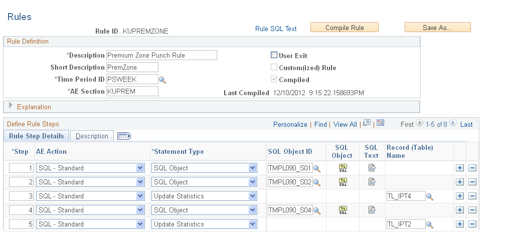

Rules Page
Use the Rules page (TL_RULE_PNL1) to enter basic information about a rule and enter descriptions for each rule step.
Navigation:
Set Up HCM, and then System Administration, and then Utilities, and then Build Time and Labor Rules, and then Rules, and then Rules
This example illustrates the fields and controls on the Rules page. You can find definitions for the fields and controls later on this page.
Rules page

Define Rule Steps - Rule Step Details Tab
Use this grid to enter the steps of the rule.
Multiple views of this portion of the Define Rule page are available by selecting the tabs in the scroll area. We document fields that are common to all views first.
Rules usually begin with steps to truncate working tables (TL_IPT2-5 and other working tables) to create spaces within the working tables for processing steps in the rule.
WARNING:
Never truncate TL_IPT1. Doing so destroys the data.
Generally, order the rules by period. For example, if you have daily rules and weekly rules, the system should resolve the daily rules first.
Field or Control Description
Step
Enter a value in this column to determine the processing order of the rule steps. Lower numbers indicate higher priority. Numbers can be up to three digits. Each number within this column must be unique. We suggest assigning numbers in increments of 10 so that you can insert steps later without renumbering the entire rule. The processing order is extremely important because it can directly affect payable time calculations.
Step Type
Select a value from the list. Valid values are:
(none): Select for the system not to use any effective date logic.
SQL Obj: Select to add a SQL object in this rule step. If you select this option, the Record (Table) Name column is unavailable.
Action: Select to add an action in this rule step. If you select this option, the Record (Table) Name column is unavailable.
Expr Text: Select to add expression text in this rule step. If you select this option, the component changes and the Expression Text page is visible.
Truncate: Select to truncate a table in this rule step. If you select this option, the SQL ID, Page Transfer, and Rule Step SQL Text button columns in the grid are unavailable.
SQL Object ID
Select the object to include in this rule step.
Action
Select the action to include in this rule step.
SQL ObjectSQL statement
To view the SQL text of the object you are adding to the rule, click the Rule Text button to access the Action SQL Text Resolution secondary page. You will not see the SQL text of other objects in the step list. To view the entire rule text, click the button at the top of the page.
SQL TextAdd
Click to view the details of the SQL object that you are adding to the rule step. You cannot modify the object.
Record (Table) Name
Select the table that you want to truncate, if applicable.
Define Rule Steps - Description Tab
Access the Description tab on the Define Rule page.
Description
Enter a short description of what this rule step should accomplish.

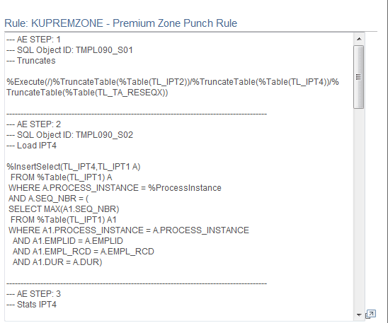

Action SQL Text Resolution Page
Use the Action SQL Text Resolution page (TL_RULE_TEXT_SP) to view the SQL text of the rule step you are adding to a rule.
Navigation:
Click the Compile Rule button on the Rules page.
This example illustrates the fields and controls on the Action SQL Text Resolution page. You can find definitions for the fields and controls later on this page.
