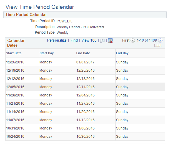

View Time Period Calendar Page
Use the View Time Period Calendar page (TL_CALENDAR_VW_PNL) to view the time period instances for each calendar.
Navigation:
Set Up HCM, and then Product Related, and then Time and Labor, and then Time Periods, and then View Time Period Calendar, and then View Time Period Calendar
This example illustrates the fields and controls on the View Time Period Calendar page. You can find definitions for the fields and controls later on this page.
Use the scroll arrows to move up and down the list of the start and end dates on the Time and Labor View Page.
