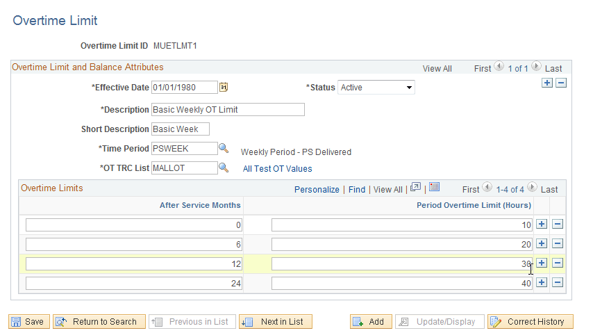

Overtime Limit Page
Use the Overtime Limit page (TL_OT_SETUP) to define overtime limits for a set of TRCs. Also identify the TRCs for which you want to track overtime balances. You must define the value list that includes the TRCs first.
Navigation:
Set Up HCM, and then Product Related, and then Time and Labor, and then Time Reporting, and then Overtime Limit, and then Overtime Limit
This example illustrates the fields and controls on the Overtime Limit page. You can find definitions for the fields and controls later on this page.
Overtime Limit page
Field or Control Description
Overtime Limit ID
Displays the unique ID for the overtime limit definition. IDs can contain up to eight alphanumeric characters.
Overtime Limit and Balance Attributes
Complete the following fields to designate the TRCs for which you want to set overtime limits and/or track overtime balances.
Status
Select the status of the Overtime Limit ID: Active or Inactive.
Note: You cannot inactivate an overtime limit definition that is associated with an active workgroup. To inactivate the limit definition, first remove it from the Workgroup page. (You can query the Workgroup table to find out which workgroups are associated with an overtime limit definition).
Time Period
Select the time period for managing overtime limits and balances. For example, if you select monthly, the system tracks the number of overtime hours for the month. If you also set a limit of 10 hours, this limit applies to each month.
Repeating and complex time periods are not allowed.
See Establishing Time Periods.
OT TRC List
Select the value list that includes the overtime TRCs for which you are defining limits and/or tracking balances.
View List
Click to view the list of TRCs that are members of the value list selected in the OT TRC List field.
Overtime Limits
Define the overtime limits in this group box. If you base overtime limits on months of service, add a row for each term of service that has a different overtime limit.
After Service Months
To base overtime limits on an employee's number of months of service, enter the number of months here. Enter whole numbers only. If you do not want to link overtime limits to months of service, leave the default value of 0 (zero) in this field.
Note: The system refers to the employee's Service Date on the Employment record to determine months of service. Because service dates can be defined for employees only, the system cannot calculate overtime balances or apply overtime limits for non-employees.
Period Overtime Hours Limit
Enter the maximum number of overtime hours that employees are allowed to work during the time period defined in the Time Period field. If you entered a non-zero value in the After Service Months field, the limit you enter here represents the number of overtime hours permitted for employees who have met the service requirement. If you entered zero in the After Service Months field, the limit you enter here applies to all employees.
Example 1: Defining Overtime Limits without Service Dates
Assume that employees can work a maximum of 25 hours of overtime each month. The values you enter are as follows:
After Service Months Period Overtime Hours Limit
0
25
Example 2: Defining Overtime Limits with Service Dates
Assume that employees must complete 12 months of service before working any overtime and after that can work a maximum of 20 hours of overtime each month. After 24 months of service, employees can work a maximum of 50 hours of overtime each month. In this case, the values that you enter are as follows:
12
20
24
50
