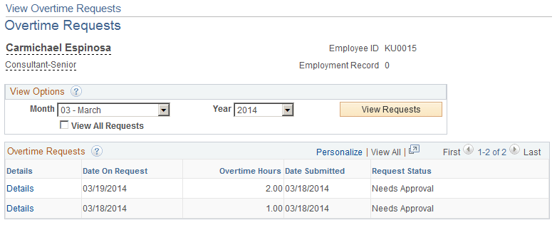

View Overtime Requests - Overtime Requests Page
Use the View Overtime Requests - Overtime Requests page (TL_OT_EVENTS) to view an employee's overtime requests.
Navigation:
Manager Self Service, and then Time Management, and then View Time, and then Overtime Requests, and then View Overtime Requests
Click the employee name link.
This example illustrates the fields and controls on the View Overtime Requests - Overtime Requests page. You can find definitions for the fields and controls later on this page.
This page lists all of the employee’s overtime requests and the status of each request: Submitted, Needs Approval, Approved, Denied, or Push Back.
To view the approval details for a request or see comments that were submitted with a request, click the Details link. The Overtime Request Details page appears.

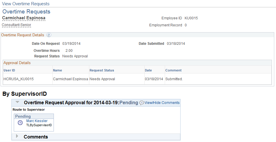

Overtime Request Details Page
Use the Overtime Request Details page (TL_OT_RQST_DTL) to view the details of an employee's overtime request.
Navigation:
Click a Details link on the View Overtime Requests page.
This example illustrates the fields and controls on the View Overtime Requests — Overtime Requests Details page. You can find definitions for the fields and controls later on this page.
View Overtime Requests - Overtime Requests Details page
This page is the same as the Overtime Request Details page that employees can access.

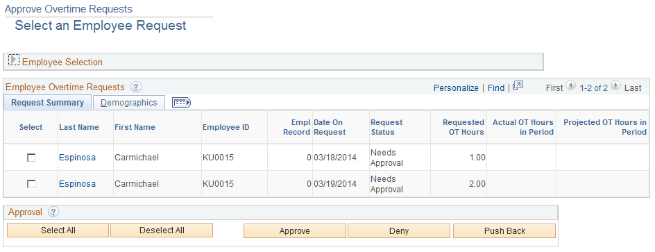

Approve Overtime Requests - Select an Employee Request Page
Use the Approve Overtime Requests - Select an Employee Request page (TL_OT_MNGR_LIST) to approve, deny, or push back employees' overtime requests.
You can approve, deny, or push back multiple requests at the same time.
Navigation:
Manager Self Service, and then Time Management, and then Approve Time and Exceptions, and then Approve Overtime Requests, and then Approve Overtime Requests
This example illustrates the fields and controls on the Approve Overtime Requests - Select an Employee Request page. You can find definitions for the fields and controls later on this page.
To approve, deny, or push back requests:
  1. Identify the requests to approve, deny, or push back:
    • Select the check box next to the requests, or
    • Click the Select All button to select all unapproved requests.
  2. Click the Approve Selected, Deny Selected, or Push Back Selected button.

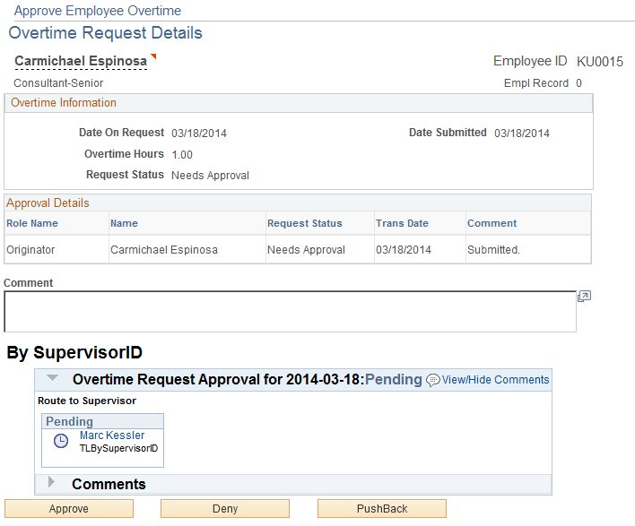

Approve Employee Overtime – Overtime Request Details Page
Use the Approve Employee Overtime – Overtime Request Details page (TL_OT_APPR) to approve or deny a single overtime request.
You can also add comments that the employee can see.
Navigation:
This example illustrates the fields and controls on the Approve Employee Overtime – Overtime Request Details page. You can find definitions for the fields and controls later on this page.
Approve Employee Overtime - Overtime Request Details page
This page is the same as the Overtime Request Details (view) page, but contains these additional fields:
Field or Control Description
Comment
Explain why the request is being approved, denied, or pushed back. The information you enter here appears on the employee's Overtime Request Details page.
Approve
Click to approve the request.
Deny
Click to deny the request.
Push Back
Click to push back the request.
View All Overtime Requests
This link takes you to a listing of all overtime requests for the employee as a reference. Use Cancel to return to the individual request to approve or deny.
