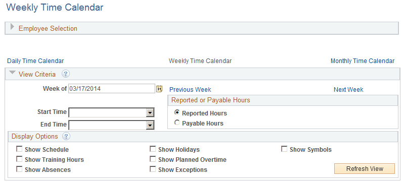

View Criteria Page
Use the View Criteria page (TL_WV_CRITERIA_SBP) to select the criteria to view on the current calendar page.
The system retains the Group ID and Show Symbols selections and defaults to these each time you access the page. The system also carries these selections to the next calendar view you access using the Navigational Links. The daily calendar also retains the Start Time and End Time selections.
Navigation:
Manager Self-Service, and then Time Management, and then View Time, and then Daily, Weekly or Monthly Time Calendar
This example illustrates the fields and controls on the View Criteria group box. You can find definitions for the fields and controls later on this page.
Each of the calendar viewing pages enables you to select the types of information you choose to view. The viewing options must first be defined on the Calendar View Options page. The available viewing options display above the calendar. This flexible design enables you to adjust the criteria so that you view exactly the information you need. By selecting the check box next to the option you want to add to the view, you can build a multi-layered view of the schedule.
Though absence, overtime and training information can be selected to display on all calendar views, the type of information displayed depends on the period being viewed and implementation of PeopleSoft Absence Management (for absences) and PeopleSoft Human Resources Administer Training or PeopleSoft Learning Management for training data. Time and Labor uses the Scheduled Time Fullsync and Scheduled Time Sync application messages to pull training data from ELM to the HCM database. For more detailed information on these selections, see the page description for the specific view.
Field or Control Description
Previous Day, Previous Week, Previous Month, Next Day, Next Week and Next Month
Navigate forward and backward keeping the same view criteria and time period selection.
Show Schedule
Selecting this option adds a row beneath each time reporter row in the calendar grid. For each time reporter, the top row displays only reported or payable time and the bottom row displays the scheduled time as either "Workday" or "Offday." The Sum column displays the total number of scheduled hours for the time reporter. Before using this option the schedules must be created, built and assigned to time reporters.
Show Holidays
Select to display the holiday schedule of each time reporter.
To derive Holiday data, first the system determines if there is a Holiday Schedule on the JOB record for the employee. If there is no Holiday Schedule on the Job record, then the system will check for a Holiday Schedule in the following order:
  1. If the employee is enrolled in the Global Payroll system, derive the Holiday Schedule from the Global Payroll pay group.
  2. If the employee is enrolled in the Payroll for North America system or Payroll Interface, and the selected Absence System is Absence Management, derive the Holiday Schedule from Global Payroll pay group.
  3. If the employee is enrolled in the Payroll for North America system or Payroll Interface, and the selected Absence System is Other, derive the Holiday Schedule from the Payroll for North America pay group.
  4. If there is no Holiday Schedule on the pay group, derive the Holiday Schedule from the Time and Labor Workgroup.
Holidays display on the time row, not the schedule row. If time is reported on a holiday, the system displays the time event with the highest priority so, if "Holiday" is higher, the color and symbol for holiday displays.
If the holiday is also a regular workday but no time is reported, the system displays the scheduled time in the reported slot with the color and symbol for holiday. Only reported hours calculate in the Sum column in this case.
Show Symbols
Select to display the designated time event symbols as defined on the Calendar View Options page.
Note: Defining symbols is optional. If symbols have not been defined in the setup, Show Symbols will not be an option.
Show Exceptions
When selected, an Exceptions column is added in the grid and displays an Exceptions link for any time reporter with exceptions during the Time Administration Process. Clicking this link takes you to the Exceptions Information page which provides more details about the exception and enables you to manage these exceptions.
The Exceptions column appears only if there are exceptions to show.
See Exceptions Page.
Show Absences
This option either displays absences reported in Absence Management or displays reported absences in Time and Labor for Base Benefit users, who are reporting leave time.
Show Training Hours
This option works with Human Resources Administer Training and Learning Management to display requested , approved, and reported training time.
View Day, View Week, and View Month
Click to apply the selected viewing options to the current page. The system stores the Group ID and Start Time, End Time and Show Symbols viewing criteria so that the next time this page is accessed with the same User ID, the same options will appear. Each time the options are changed click the View Time button to refresh the calendar view.

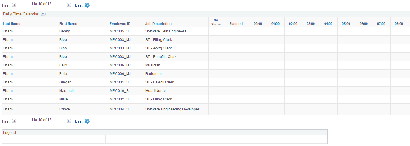

Daily Time Calendar Page
Use the Daily Time Calendar page (TL_WV_DAILY) to use the Daily Time Calendar page to view detailed information regarding time reporters' daily time related data for a specific date.
The page defaults to the current date.
Navigation:
Manager Self-Service, and then Time Management, and then View Time, and then Daily Time Calendar, and then Daily Time Calendar
This example illustrates the fields and controls on the Daily Time Calendar page (1 of 2). You can find definitions for the fields and controls later on this page.
This example illustrates the fields and controls on the Daily Time Calendar page (2 of 2). You can find definitions for the fields and controls later on this page.
This page provides an overview of a manager's time reporters' work time on a specified day. When accessing the page, all time reporters for the manager are listed and reported time for the current day (00:00 – 23:00) is displayed.
The Sum column displays the total time recorded for each time reporter for the selected viewing period. For punch time reporters, the sum represents the time between each in and out punch. If no out punch exists, the lesser of either current time or the selected period end time is used as the out time for the calculation.
On the daily calendar for example, if a time reporter records an in punch at 1:00 p.m. and the selected calendar view range runs from 8:00 am to 4:00 p.m., the sum would report four hours for this time reporter. For elapsed time reporters, the Sum column will display reported hours that are associated to TRCs that were found in the TRC List(s) designated on the View Options page.
On the daily calendars, punch time reporters recorded punch times display in the applicable time slot using the color/symbol for the Default Reported/Payable Time. If a symbol is specified for the time event, the punch time is preceded by the symbol and a dash. If a subsequent punch time event occurs within the same time slot, the time of this next event is appended with a dash separating the times. For time slots where no actual punches occur that are subsequent to a time-in punch and prior to a time-out punch, the color/symbol alone is displayed. For a time where a scheduled event such as training also occurs (the Show Training option must be selected) the color/symbol with the highest priority displays in the time slot.

Weekly and Monthly Time Calendar Pages
Use the Weekly or Monthly Time Calendar page (TL_WV_WEEKLY) to view detailed information regarding time reporters' weekly or monthly time related data for a specific time period.
Navigation:
Manager Self-Service, and then Time Management, and then View Time, and then Weekly Time Calendar, and then Weekly Time Calendar
Navigation:
Manager Self-Service, and then Time Management, and then View Time, and then Monthly Time Calendar, and then Monthly Time Calendar

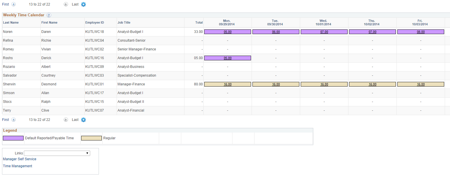

This example illustrates the fields and controls on the Weekly Time Calendar page (1 of 2). You can find definitions for the fields and controls later on this page.
This example illustrates the fields and controls on the Weekly Time Calendar page (2 of 2). You can find definitions for the fields and controls later on this page.
The previous screenshot does not display the entire page. Scroll to the right on your system to view all of the fields on the page.
The Weekly and Monthly Time Calendar pages provide managers with an overview of their time reporters' reported time and other time related data for a specific week or month.
If reported or payable time exists for a time reporter, the hours quantity displayed in the cell is associated to that reported or payable time. The time displays as a link in the cell. If multiple TRCs are reported by a time reporter for a specific date, the reported or payable hours appear for that date with the color and symbol for the TRC with the highest priority appearing as the link. Click this link to view details on the reported or payable time.
If no reported or payable time exists but another time event item does, the quantity and symbol (if Show Symbolsis selected) of the next highest priority item will the cell displays.
The Sum column displays the total time for the selected viewing period. For punch time reporters, the sum represents the time between each in and out punch.
If no out punch exists, the system uses the end of the day (24:00); if no in punch exists, the system uses the beginning of the day (00:00).
