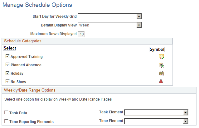

Manage Schedules Options Page
Use the Manage Schedule Options page (SCH_MNG_OPTIONS) to set up preferences and display options for viewing schedules.
Navigation:
Manager Self Service, and then Time Management, and then Manage Schedules, and then Manage Schedules
Scroll down and click the Schedule Display Options link (The page opens in a new window).
This example illustrates the fields and controls on the Manage Schedules Options page. You can find definitions for the fields and controls later on this page.
Use this page to set defaults for the Manage Schedules pages.
Field or Control Description
Start Day for Weekly Grid
Select a day of the week that a schedule should be displayed.
Default Display View
Select the default display view that the Manage Schedule page should use when entering the page. Select the Day value for the default Daily Schedules page (SCH_MNG_DAILY), the Week value for the default Weekly Schedules page (SCH_MNG_WEEKLY), and the Date Range value for the default Date Range Schedules page (SCH_MNG_DRANGE).
Maximum Rows Displayed
This field is display only and displays a maximum of ten employees at a time.
Schedule Categories
Select the Schedule Category values to display the respective icons on the Employee grid on the Manage Schedules pages. A legend also appears on the Manage Schedules pages with a description of each category and icon.
Values are Approved Training, Planned Absence, Holiday and No Shows.
Note: The No Shows value only displays for the Daily Schedules page. No Shows information is stored, so any No Shows information from the past can be viewed.
Weekly/Date Range Options
Choose one value to display on the Weekly and Date Range pages. Values are Task Data and Time Reporting Elements. If using the Task Data and Time Reporting Elements, select a field value for each from the drop-down list box. From the Task Data drop-down list, the values are: Activity ID, Business Unit, Combination Code, Customer, Department, Job Code, Location Code, PC Business Unit, Performance Measurement Business Unit, Position Number , Product, Project/Grant, Resource Category , Resource SubCategory , Resource Type, Task Profile ID, User Field 1 – 4.. From the Time Reporting Elements drop-down list, the values are: Country, State, Locality, TRC, Billable Indicator.
By choosing a value from Task Data or Time Reporting Elements, the employee who is scheduled with this value, appears in the daily cell of Manage Schedules for that day. If there are changing elements throughout the day, there will be an icon representing any changing elements in the shift. This is an indicator to the user that they can drill down into the Schedule Daily Detail page for more information on the daily changes.
In order for all of the schedule category icons and other options to be displayed to the user, the user must ensure that they save this page, in order to save the options.

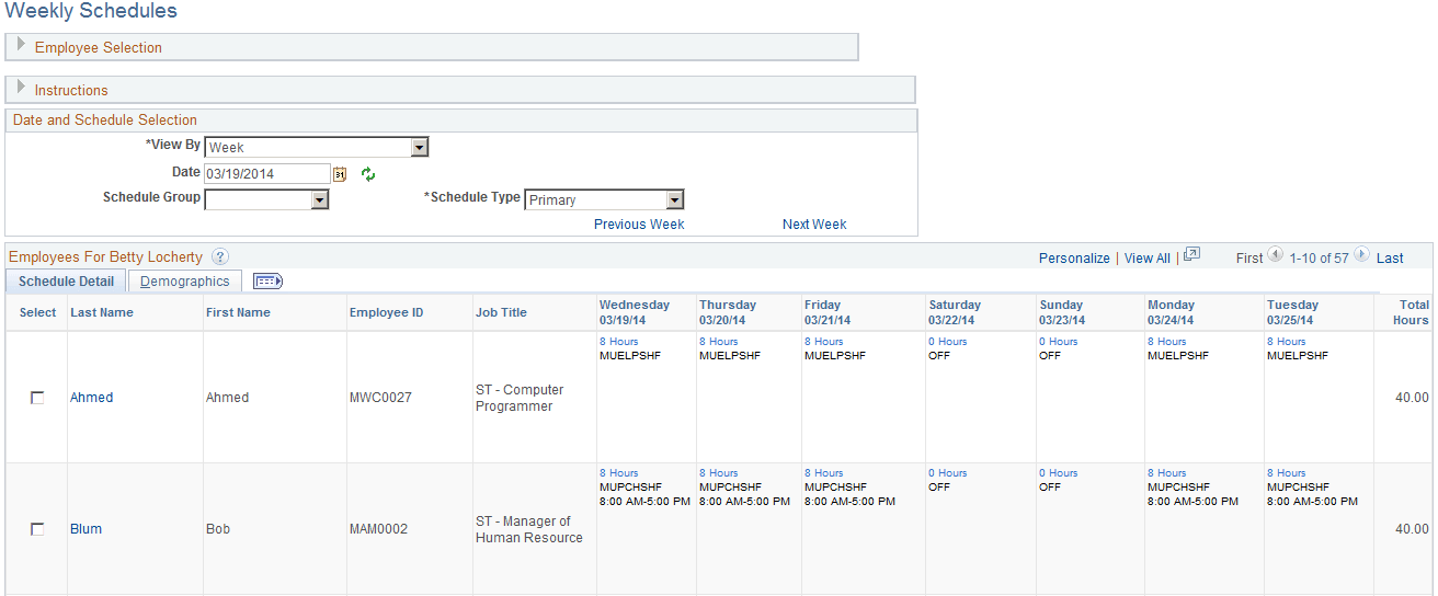

This example illustrates the fields and controls on the Weekly Schedules page (1 of 2). You can find definitions for the fields and controls later on this page.
This example illustrates the fields and controls on the Weekly Schedules page (2 of 2). You can find definitions for the fields and controls later on this page.
The previous graphics do not show the entire page. Scroll to the right on your system to view all of the fields on the page.
When entering the page, the system displays either the Daily, Weekly, or Date Range Schedules pages, depending on the default set on the Manage Schedules Display Options page. This page also sets defaults that are used on the Schedule Replacements, Copy Schedules, and Swap Schedules pages, such as date fields and link names.
Enter values in Employee Selection Criteria and click the Get Employees button to filter the list of employees that requires changes or review.
Click the Instructions expand section to view instructions about how to use the page.

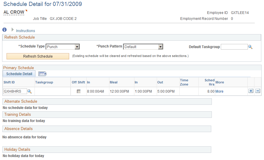

Schedule Detail Page
Use the Schedule Detail page (SCH_MNG_DAILY_DTL) to override a schedule, refresh or add a schedule for the day, or enter a new schedule for the day.
Navigation:
Manager Self Service, and then Time Management, and then Manage Schedules, and then Manage Schedules. Click the link in the Daily Schedule Details column on the Daily Schedules page. On the Weekly Schedules and Date Range Schedules pages and then click the link in the Date column.
This example illustrates the fields and controls on the Schedule Detail page. You can find definitions for the fields and controls later on this page.
You can override a schedule on this page by refreshing or adding an existing schedule for the day, or you can create a new schedule for the day.
Schedule Type
Options in this field are Punch and Elapsed.
Punch Pattern
This field is available If you selected the Punch option in the Schedule Type field. Options for this field are Default and All Punches.
  • Default displays punch types that are derived from the Default Punch Pattern on the Configurations tab of the Time and Labor Installation page, or on the Schedule Settings tab of the Global Payroll & Absence Management Installation Settings page.
  • All Punches displays all available punch types (IN, BREAK, IN, MEAL, IN, BREAK, IN, TRANSFER, OUT) and provides more flexibility.
See Time and Labor Installation Page.
Default Task Group
Enter a value in this field to display Time Reporting Elements and Task Elements or Task Profile values.
Using a default taskgroup for the day is appropriate if you enter schedule changes without using a Shift ID. If making schedule overrides using a Shift ID, any taskgroup and task information from the Shift ID is derived and displayed in either the Primary Schedule or Alternate Schedule group boxes.
The selection of Schedule Type and Taskgroup will derive the time reporting template used to default the display of Time Reporting Elements and Task Elements or Task Profile values for that taskgroup. If you defined the time reporting template to use the task template, these tabs are displayed in the Primary Schedule and Alternate Schedule group boxes.
Note: The selection you enter in the Schedule Type and Taskgroup fields derive the time reporting template used to display Time Reporting Elements and Task Elements or Task Profile values for the taskgroup. If you defined the time reporting template to use the task template, these tabs are displayed in the Primary Schedule and Alternate Schedule group boxes, and may include Task Reporting Elements and Chartfields.
More
Click this link to open the Daily Detail – Shift Information page.
Refresh Schedule
Click this button after you change the Schedule Type Punch Pattern or Default Taskgroup values for the day. This resets the day to enter a new schedule override.
Note: Remember to save the page for the schedule change to be reflected in the Manage Schedules components.

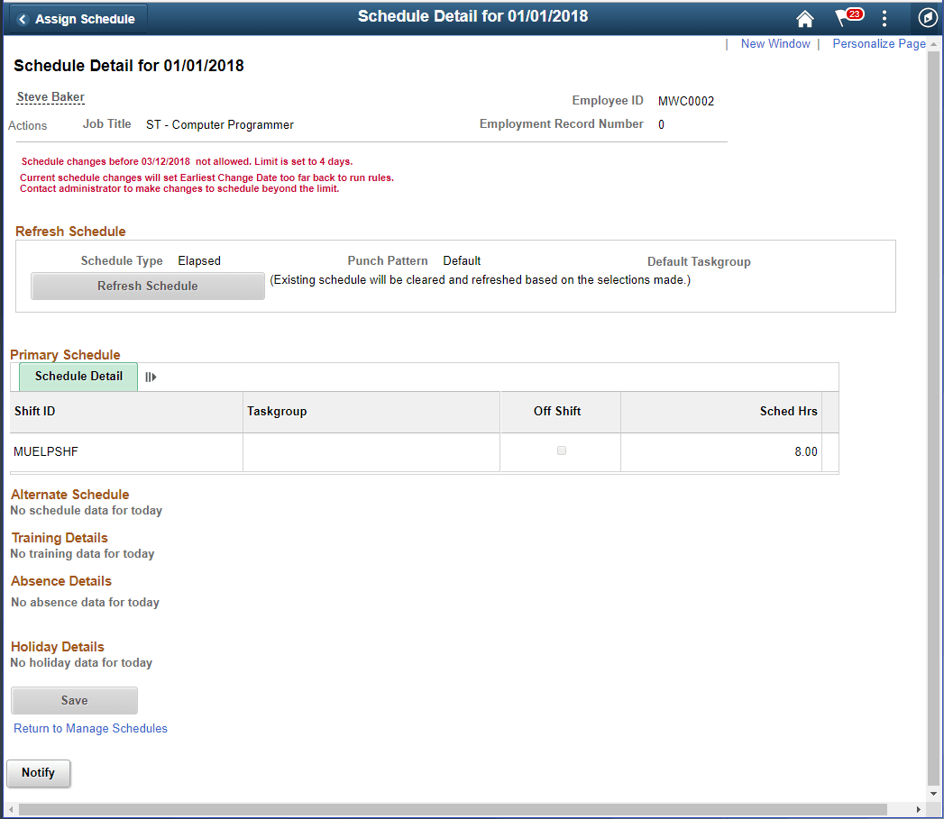

This example illustrates the fields and controls for the Schedule Detail Page.
Schedule Detail Page for beyond Schedule change limit
In this example, the Refresh Schedule will be greyed out as the schedule change limit is not within the specified period mentioned in Installation options and Time Period ID mentioned under Workgroup Defaults in Workgroup - Definition Page.
The Manage Schedules component recognizes the date and time formats selected by the user under My Personalizations.
Schedule Daily Detail and the Display of Shift ID
When you have set the appropriate SETID for an employee, the system displays the Shift ID field for that employee. The SETID is derived from the Schedule Group associated with the employee's predefined or default schedule assignment. The only time that a Shift ID field does not appear on the Daily Detail page is when:
  • There is no row in Assign Work Schedule for the employee.
  • There is no schedule ID defined on the employee's workgroup.
If the employee does not have a long term schedule, then the Shift ID field will not appear on the page. As a result, you need to enter the shift data manually for the day. Select the Refresh Schedule button to activate fields in the Primary Schedule and Alternate Schedule group boxes.
Any schedule information from a prior schedule change, or imported schedule information, or permanent work schedule is displayed in these group boxes. If no primary or alternate schedule detail exists for the day, it can be added using the Refresh Schedule button. You can enter a schedule override with a predefined shift which has the SetID of the employee's Schedule Group. You can also enter a schedule override that has only punch times or only scheduled hours for an elapsed schedule, without using shifts. If changing time reporting or task elements exist in a shift, the detail of the Shift can be accessed through a More link both on the Primary and Alternate Schedule sections. An icon representing Shift has Changing Elements appears for those shifts that have changing elements.
To enter an off shift, you can choose a predefined shift that has the Off Shift check box activated. If you are not using shifts, you can enter either elapsed hours with an Off Shift check box activated or an IN and OUT time with an Off Shift check box activated. The Off Shift check box determines that the Scheduled Hours are zero, it does not change the duration of the off shift.
Multiple shifts can be entered as a schedule override for a day. If you enter a punch shift that overrides the times of another punch shift for the day, you will receive a warning message.
The Alternate Schedule Detail tab is displayed only if core Global Payroll or Absence Management are installed and selected on the Installation Table – Products page.
Training Details
This group box displays training detail information from PeopleSoft Training Administration or Learning Management. The start time and end time of the training for the day are displayed.
Absence Details
This group box displays the duration of an absence from Global Payroll or Absence Management, or from leave reported directly on the Timesheet in Time and Labor or PeopleSoft Base Benefits.
Holiday Details
This group box displays the name of the holiday and number of hours from the Holiday Schedule. If a holiday schedule exists for the employee on the Job Data page, it is displayed. If no holiday schedule exists on that page, the system checks if the employee is a Global Payroll employee and uses the holiday schedule from the Global Payroll pay group. If the employee is not enrolled in a Global Payroll pay group, but is enrolled in Time and Labor, the system uses the holiday schedule from the employee's Workgroup.

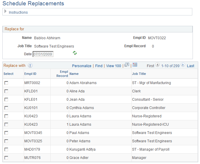

Schedule Replacements Page
Use the Schedule Replacements page (SCH_MNG_REPLACE) to schedule a replacement for an employee for a day.
Navigation:
Select one check box in the Select column and click the Replace Schedule button on the Daily, Weekly, or Date Range Schedule pages.
This example illustrates the fields and controls on the Schedule Replacements page. You can find definitions for the fields and controls later on this page.
On the Schedule Replacements page, change the date if required and select one employee to substitute the schedule for the day. In most cases, the user would be finding a replacement for an employee who will be absent for the day. All the employees who are not in training for that time, and not absent for the day, appear in the Replace with grid.
After an employee is Replaced, an R is placed next to the employee in their daily cell, on any of the Manage Schedules pages - day, week or date range. The employee who is replacing the employee, inherits the schedule. The replaced employee retains the original schedule, so as to represent what the original schedule was, and for appropriate payment if the employee then reports an absence for the day.
If you decide that the replacement was a mistake, you can undo it by accessing the Daily Detail page from the Scheduled Hours link, and clicking the Undo Replacement button and then clicking the OK button on the Confirmation page. As a result, the R will no longer be displayed on the Manage Schedules page.
For the employee who had inherited the employee's schedule, the schedule for that day would need to be changed, if the employee is no longer replacing the employee's schedule for that day.
If you selected the Day View By Option, the Date field on this page is display only.

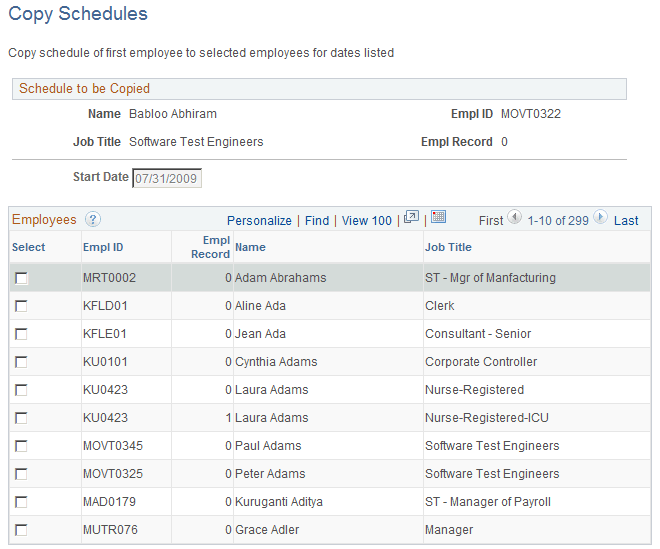

Copy Schedules Page
Use the Copy Schedules page (SCH_MNG_COPY) to copy an employee schedule to be used by another employee for a day or specified date range.
Navigation:
Select one check box in the Select column and click the Copy Schedules button on the Daily, Weekly, or Date Range Schedule pages.
This example illustrates the fields and controls on the Copy Schedules page. You can find definitions for the fields and controls later on this page.
Copy Schedules page
On the Copy Schedules page, change the Start Date and End Date if required. Select single or multiple employees to copy schedules and click the Copy button. The whole day will be copied for the date or range of dates defined. .
If you selected the Day View By option, the Date field on this page is display only.
