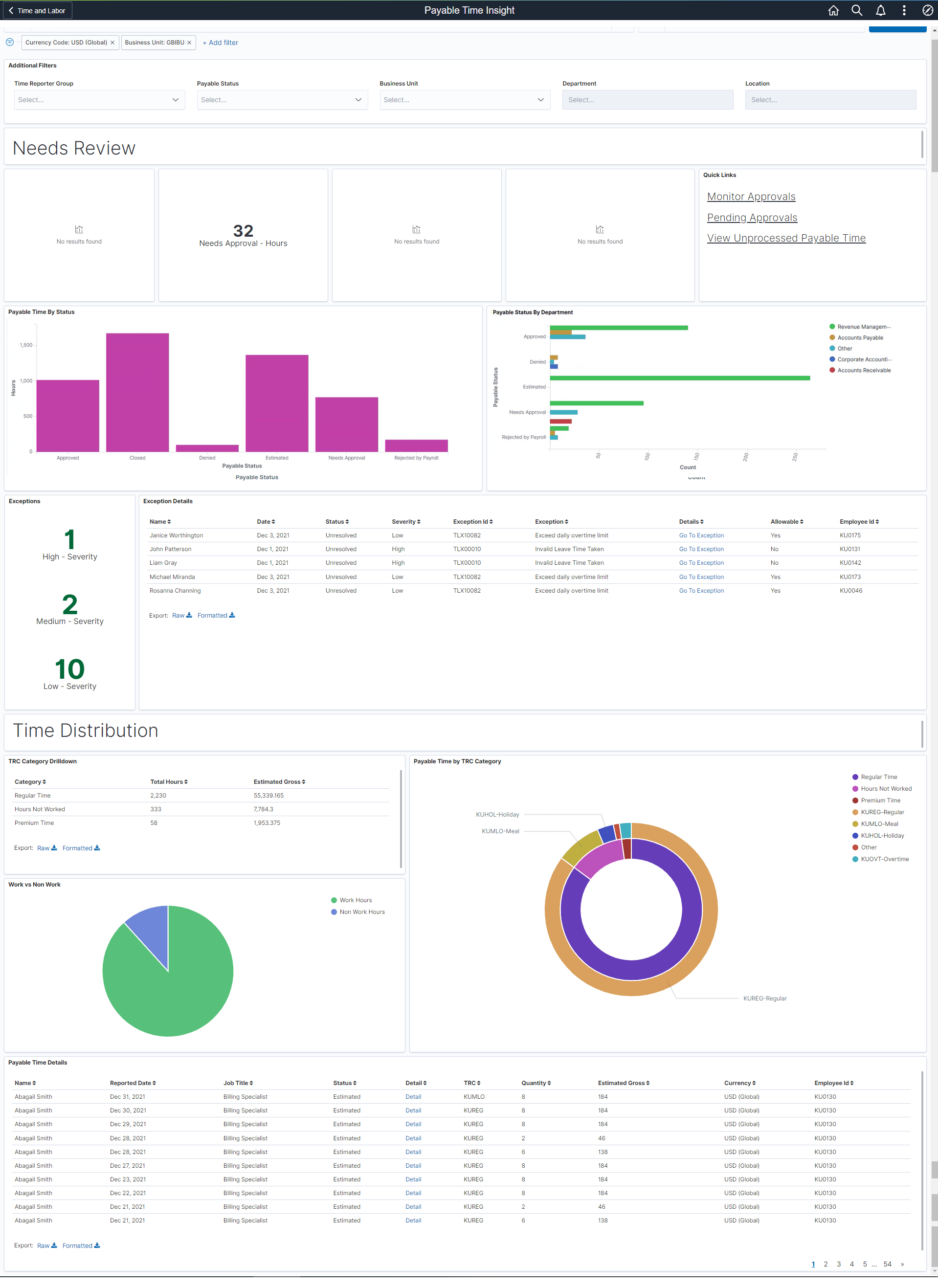

Payable Time Insights Dashboard
The Time administrators and managers can use the Payable Time Insights dashboard to view several interactive visualizations based on the time reporting time data specified for a date range for the group of employees specified by the filters.
The visualizations are used in the following ways:

This example illustrates the fields and controls on the Payable Time Insights dashboard. You can find definitions for the fields and controls later on this page.
Payable Time Insights Page
The visualizations are presented in different visual representations to best present data. There are different types of analytics which include:
  • Needs Review
  • Payable Time by Status
  • Payable Status By Department
  • Exceptions and Details
  • TRC Category Drilldown
  • Work Vs Non-Work
  • Payable Time By TRC Category
  • Payable Time Details

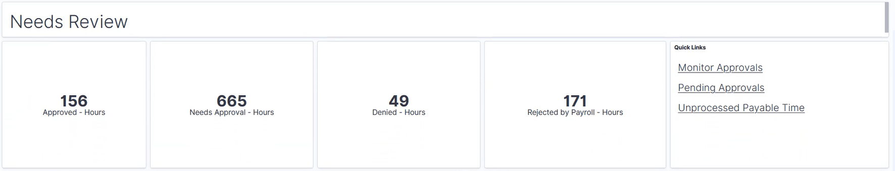

Needs Review
Use the Needs Review visualization to view the Payable Time statuses which may require review.
This example illustrates the fields and controls on the Needs Review visualizations.
Actual Time Submission
The Quick Links visualizations show approvals status and unprocessed payable time contains links to other pages which might be useful when reviewing the various Payable Time statuses.
Quick Links show top 10 statuses in this visualization in alphabetical order. You can edit visualization and filter to include only specific statuses.

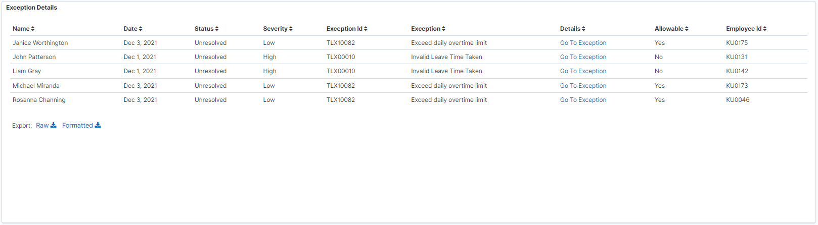

Exception Details
Use Exception Details to view details of the exceptions or to export the data in the format which is needed.
The exception index HC_TL_GBL_PAYABLETIME_EXCPTN is used for getting exceptions data.
This example illustrates the fields and controls on the Exception Details.
Exception Details
The exception details show only the unresolved exceptions for which the source is Time Administration.
Select the Go to Exception hyperlink to access the Manage Exceptions page.

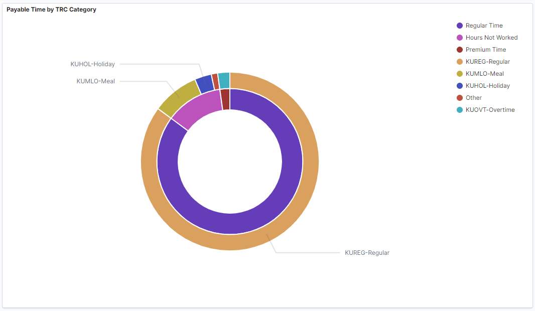

Payable Time by TRC Category
Use Payable Time by TRC Category double doughnut visualizations to view the payable time distributed over TRC category.
This example illustrates the fields and controls on the Payable Time by TRC Category.

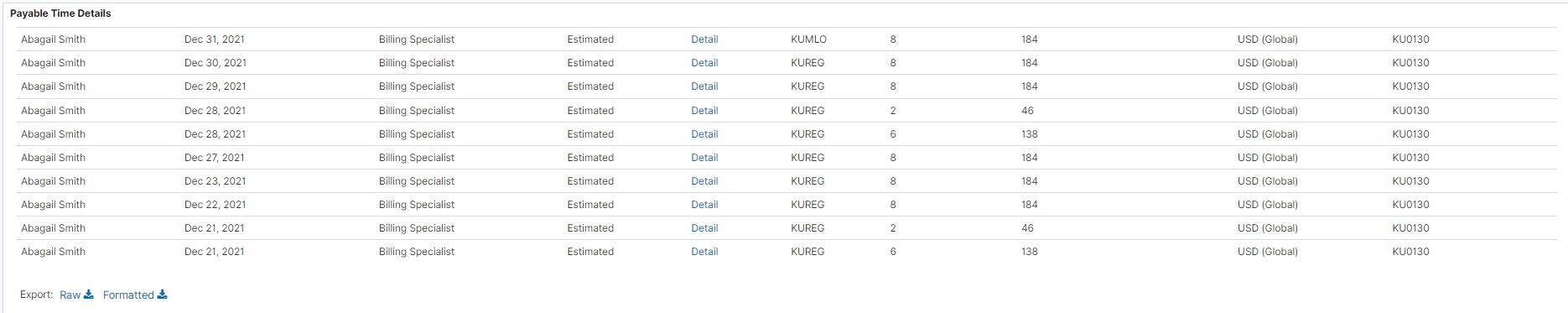

Use Payable Time Details to view the details and the data on the visualizations.
This example illustrates the fields and controls on the Payable Time Details.
Selecting the Detail link takes you to Payable Time page from where you can manage the view settings.

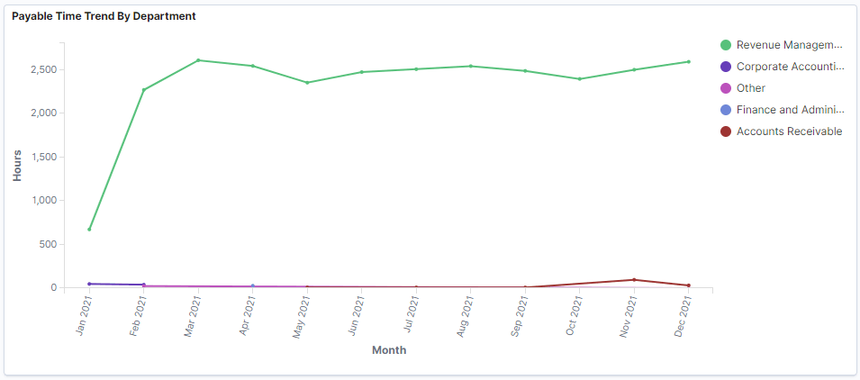

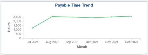

Payable Time Trend Tile
Use the Payable Time Trend tile to access Payable Time Trend Dashboard.
The tile displays the hours per month trend of payable time.
This example illustrates the Payable Time Trend Tile.
The Payable Time trend visualization displays a rolling period. It shows the past six months trend from the current months context.

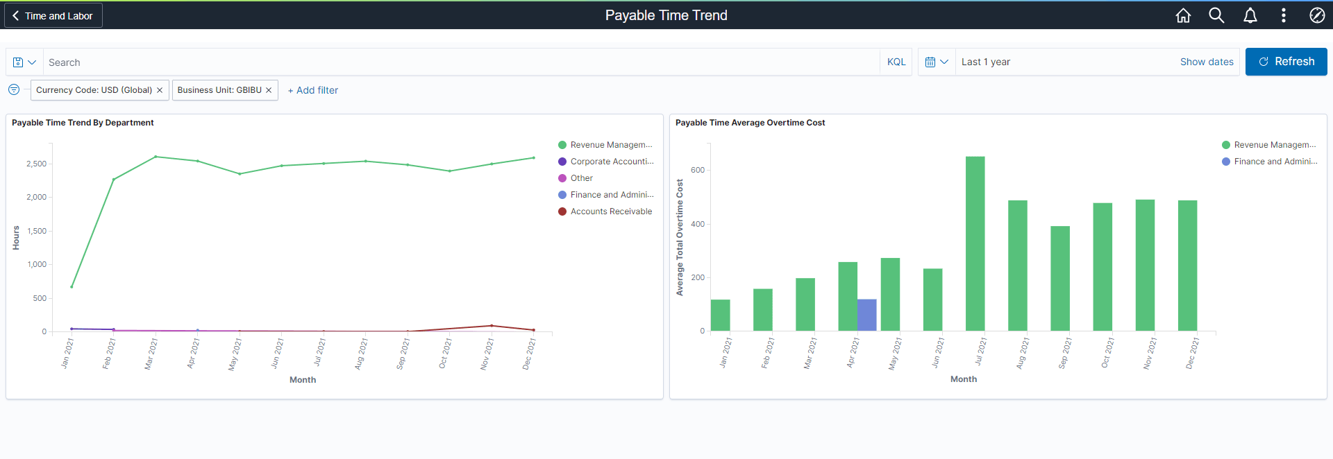

Use the Payable Time Trend and to view the payable time and overtime trends Dashboard and overtime trends by department.
  • Identify the departments that generate the most payable time average overtime cost.
  • View the overtime trend.
This example illustrates the fields and controls on the Payable Time Trend Dashboard.
Payable Time Trend By Department
Use Payable Time Trend By Department visualization to view the payable time trend in hours with the respective departments.
This example illustrates the fields and controls on the Payable Time Trend By department.
