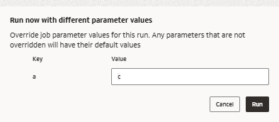

Run a Job with Different Parameter Values
You can choose to run a job immediately with modified parameter values.
  1. On the Home page, click Workflow.
  2. Click on the job you want to run.
  3. Click the down arrow next to Run Now. Click Run now with different parameters.
    Run now button expanded to display Run now with different parameters option highlighted
  4. Enter new values. These parameter values only apply to this job run.
    Run now with different parameter values prompt
  5. Click Run.
