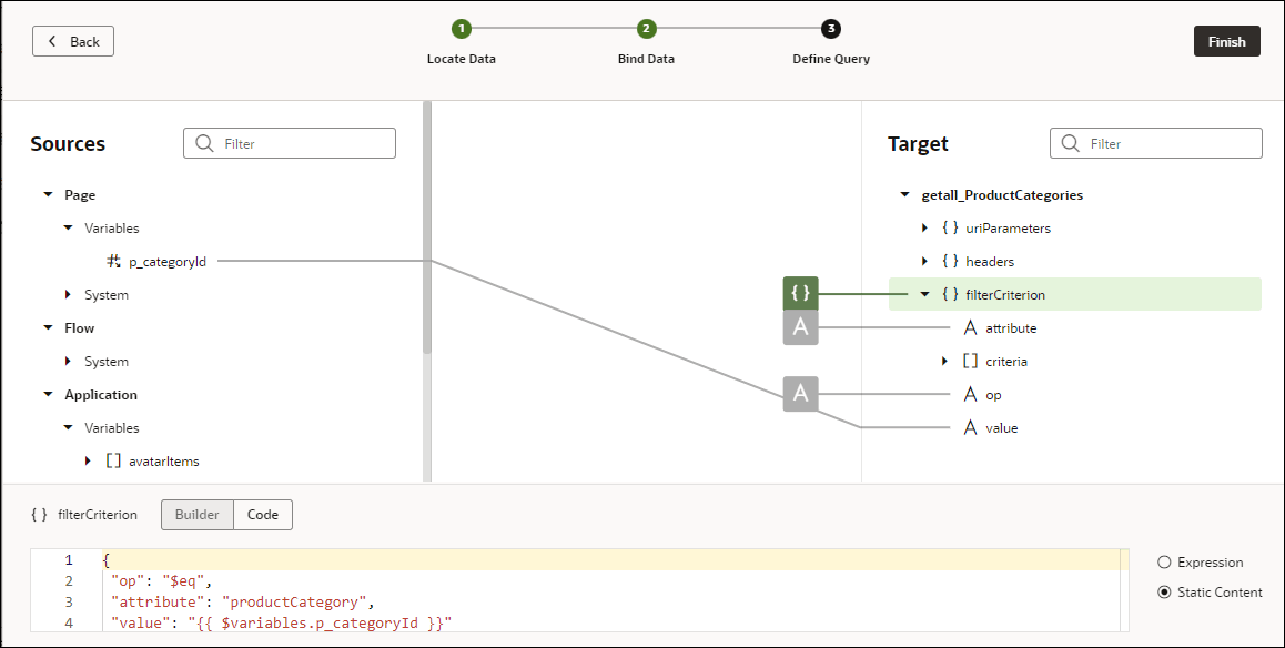

You can specify filter criteria for a collection component, such as a list or table, and append the parameter to the application page URL to apply the filter. This makes it easy to share the page URL with the filter already applied.
To enable the search criteria, set the filterCriterion attribute. In this example, we bind the value of the variable p_categoryId to the productCategory field of the business object.
To assign a page variable as a filter criterion for a table:
  1. Click the Variables tab for your page.
  2. Click + Variable, then enter the ID, select the Type, and click Create.
  3. Select the variable and, in the Properties pane, set the Input Parameter to Enabled or Required and check the Pass On URL box.
  4. Open the Page Designer and drag a Table component onto your page.
  5. Click the table, then click the Add Data quick start to populate the table.
  6. On the Add Data page, specify the business object you want to use and click Next.
  7. On the Bind Data page, bind the fields you want to display and click Next.
  8. On the Define Query page of the quick start, expand the filterCriterion builder icon on the Target pane and build your filter by specifying values for attribute, op, and value individually.
  9. Click Finish.
To filter the table, add ?paramName=Value to the end of the app URL.
