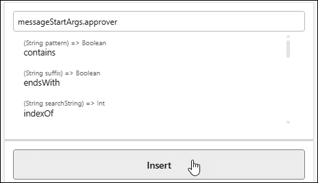

  3. When the expression is complete, select Insert to insert the expression in the task field.
    The image shows an expression editor pane with a selected field and context-aware function suggestions. The input box at the top contains “messageStartArgs.approver,” indicating a selected string field. A scrollable list below suggests applicable string functions with brief signatures and return types.At the bottom is a large “Insert” button, with a cursor hovering over it, to add the chosen expression.

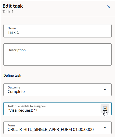

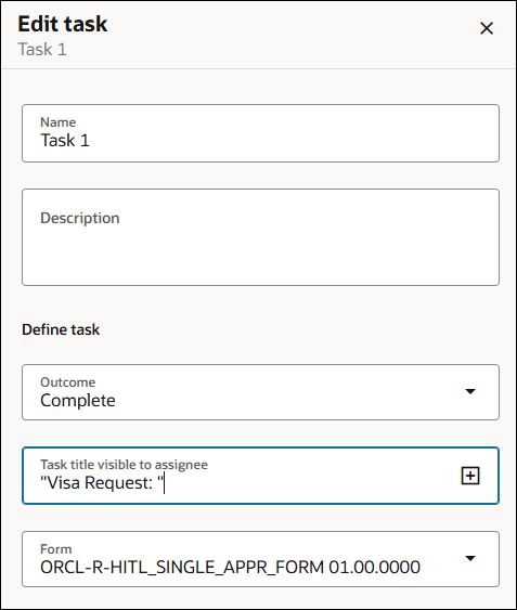

  4. In the Define task section, select the Task title visible to assignee field.
  5. Enter a string within quotation marks. For example, "VISA Request: ".
    A screenshot of an Edit task dialog. It shows fields for Name (“Task 1”), Description (empty), and a “Define task” section with Outcome set to “Complete.” Below, a field labeled “Task title visible to assignee” contains the text “Visa Request:”. At the bottom, a dropdown labeled “Form” displays “ORCL-R-HITL_SINGLE_APPR_FORM 01.00.0000.”
    The static string VISA Request: will appear as is in the task title in runtime.
  6. Position your cursor immediately after the closing quotation mark and enter a plus sign +.
    This is the concatenation operator that will join the static string with the dynamic expression that we'll create in the next steps.

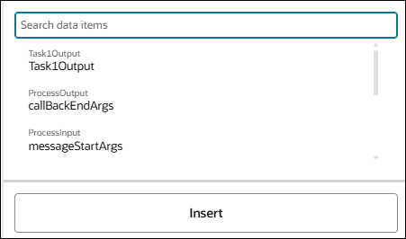

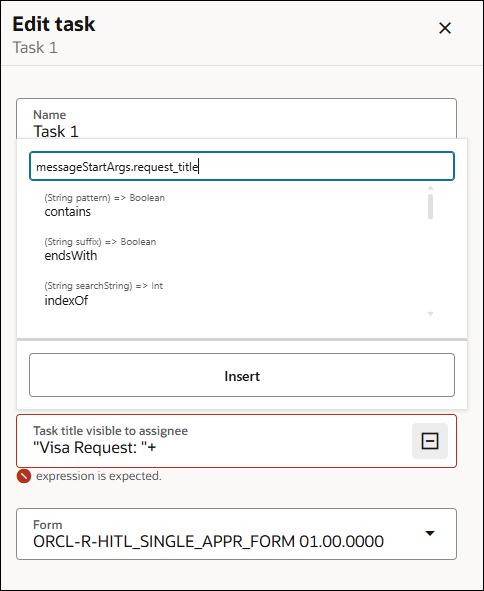

  7. Position your cursor after + and then select Open Expression Editor icon to open the expression editor.
    A screenshot of an Edit task dialog labeled “Task 1.” It includes fields for Name (“Task 1”), Description (empty), and a “Define task” section with Outcome set to “Complete.” The “Task title visible to assignee” field contains the text “Visa Request:” with a cursor at the end, and a plus (+) icon button to the right being clicked. At the bottom, a dropdown labeled “Form” shows “ORCL-R-HITL_SINGLE_APPR_FORM 01.00.0000.”

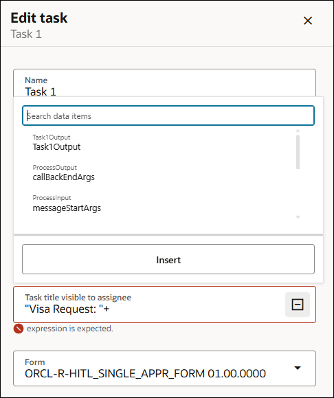

  8. As soon as you put the cursor in the expression field of the expression editor, you get a list of suggested data items.
    A screenshot of an Edit task dialog labeled “Task 1.” A data item selection panel is open beneath the Name field, showing a search bar labeled “Search data items” and a list including “Task1Output,” “callBackEndArgs,” and “messageStartArgs,” with an “Insert” button below. The “Task title visible to assignee” field contains “Visa Request: +” and is highlighted with a red border, displaying an error message below that reads “expression is expected.” A Form dropdown at the bottom shows “ORCL-R-HITL_SINGLE_APPR_FORM 01.00.0000.”

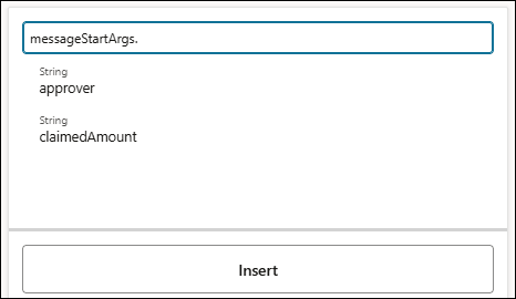

  9. Select a data item. For example, messageStartArgs.
    Related suggestions for the next level are displayed below the expression field.

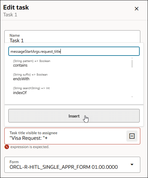

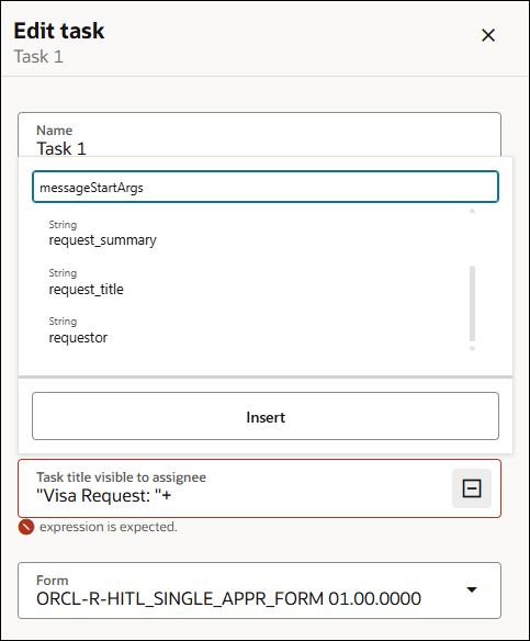

  10. Select a data item from the list of suggestions. For example, request_title.
    A screenshot of an Edit task dialog labeled “Task 1.” A data item selection panel is open with “messageStartArgs.request_title” entered in the search field, showing function suggestions like “contains,” “endsWith,” and “indexOf.” Below is an “Insert” button. The “Task title visible to assignee” field contains “Visa Request: +” and is highlighted in red with an error message reading “expression is expected.” A Form dropdown at the bottom shows “ORCL-R-HITL_SINGLE_APPR_FORM 01.00.0000.”
  11. Click Insert.
    This image

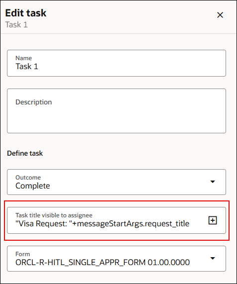

  12. The expression messageStartArgs.Request_Title is added after the operator + in the Task title visible to assignee field.
    A screenshot of an Edit task dialog labeled “Task 1.” It shows fields for Name (“Task 1”), Description (empty), and a “Define task” section with Outcome set to “Complete.” The “Task title visible to assignee” field contains the expression “Visa Request: " + messageStartArgs.request_title” and is highlighted with a red border. A plus (+) icon button appears to the right of the field. At the bottom, a Form dropdown displays “ORCL-R-HITL_SINGLE_APPR_FORM 01.00.0000.”
    In the expression "VISA Request: " + messageStartArgs.request_title:
    • "VISA Request: " is a literal text prefix that will always appear as is in the task title in runtime.
    • + is a string concatenation operator that joins two strings together.
    • messageStartArgs.request_title is a variable populated from the message start argument, that is, the data passed into the workflow when it was started via a message. request_title is a field in that incoming payload.
