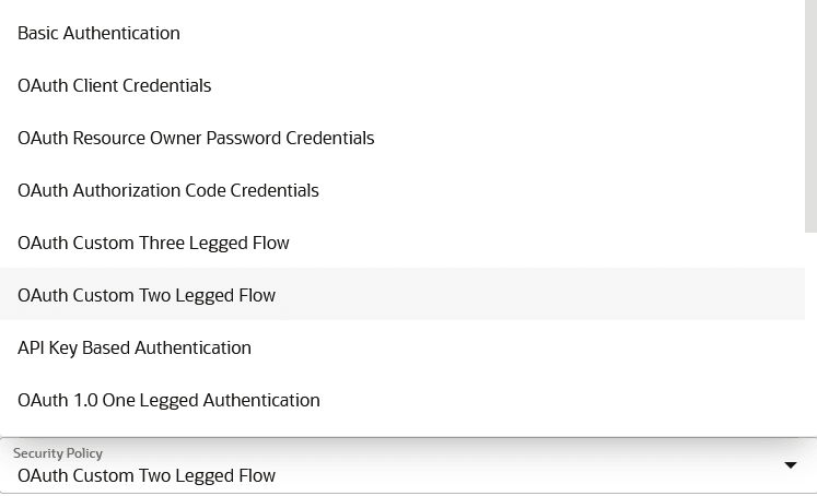

The following security policy options are available on the Connections page for the REST Adapter.Description of oic3_oauth2leg.png follows
Each option is applicable in a different context and is used to negotiate and obtain a valid access token. Read your REST service provider documentation to identify the applicable policy.

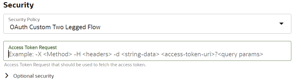

Step 1: Configure the Access Token Request
The Security Policy field shows OAuth Custom Two Legged Flow selected. Below this is the Access Token Request field with example text.
The Access Token Request field is formed using the URI syntax of the HTTP request used to fetch the access token. The URI syntax resembles cURL but is more basic and only supports the following options.

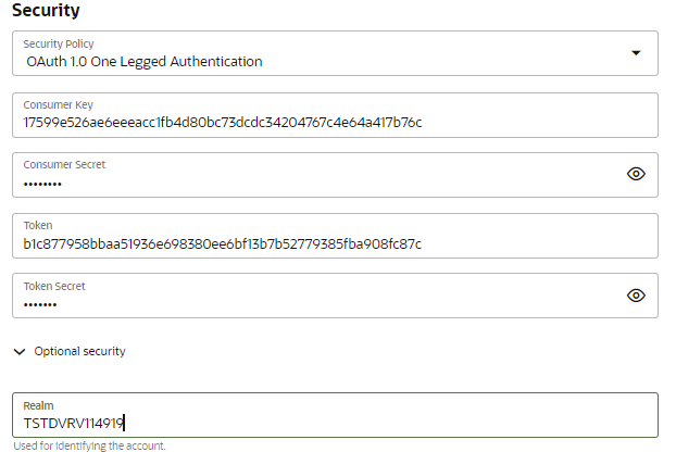

Configure the following fields on the Credentials dialog of the Connections page. These credentials are provided by the service provider (Oracle NetSuite or Twitter).
  • Consumer Key — Specify the key that identifies the client making the request.
  • Consumer Secret — Specify the consumer secret that authorizes the client making the request.
  • Token — Specify the token that accesses the protected resource.
  • Token Secret — Specify the token secret that generates the signature for the request.
  • Realm — Specify the realm that identifies the account.
See Configure Connection Security.
