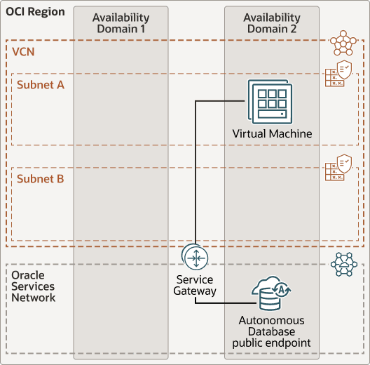

Low Latency Connections Using Public Endpoint with Application Running Inside the OCI Region
![Description of adb-public-low-latency.eps follows Description of adb-public-low-latency.eps follows](img/adb-public-low-latency.png)
Description of the illustration adb-public-low-latency.eps

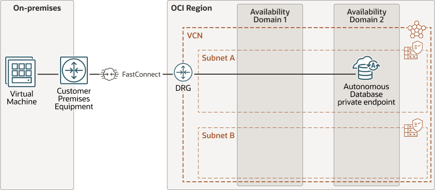

Low Latency Connections Using a Private Endpoint with Application Running In On-Premises Data Center Connected to OCI Using FastConnect
![Description of adb-fastconnect-private-low-latency.eps follows Description of adb-fastconnect-private-low-latency.eps follows](img/adb-fastconnect-private-low-latency.png)
Description of the illustration adb-fastconnect-private-low-latency.eps

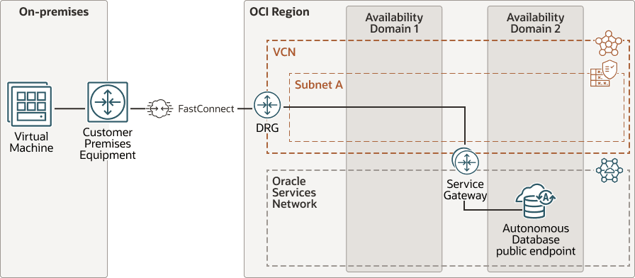

Low Latency Connections Using a Private Endpoint with Application Running In Your in On-Premises Data Center Connected to OCI Using FastConnect
![Description of adb-fastconnect-public-low-latency.eps follows Description of adb-fastconnect-public-low-latency.eps follows](img/adb-fastconnect-public-low-latency.png)
Description of the illustration adb-fastconnect-public-low-latency.eps
