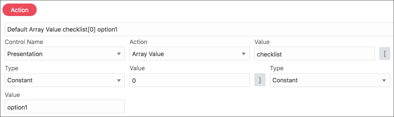

    • Use the Array Value action to set the value of a particular element in an array on occurrence of an event. Specify the array, index of the element, and value to set—in that order—in the subsequent fields of the event window. The following image shows a value of option1 set to an element with index 0 in the array named checklist.
      Description of array-value.png follows
