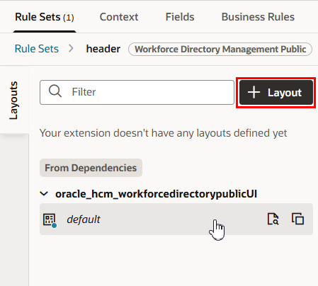

  1. In the Rule Sets editor, open the rule set for the component you want to configure.
  2. Click + Layout in the rule set’s Layouts pane and type a name for the new layout. Click Create.

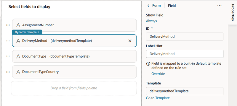

Edit a Field’s Properties in a Layout
When you edit a field’s properties in a rule set’s layout, your changes only apply to the field in the current layout. You might want to do this to override a field’s properties in a specific layout, for example, to mark a field as Required or Read Only. If you want to edit a property so that it’s the same in all layouts—for example, if you want it always to be Read Only—you should edit the field’s properties in the Fields editor.
To edit a field’s properties:

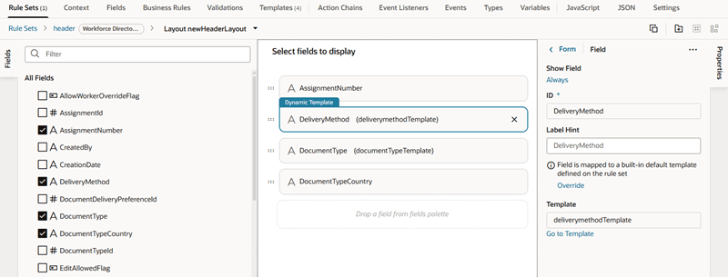

  1. In the Rule Sets editor, open the layout and select the field in the center pane.
  2. Set the Show Field property to control when the field is displayed. The default setting for this property is Always. For details on how to set the property, see Use Conditions to Hide and Show Fields in a Layout .
  3. Edit the field’s Read Only and Required properties in the Properties pane.
    If you are editing the properties of a field defined by an Oracle Cloud Application service, the image below shows the message you’ll see in the Properties pane if the field has undergone a custom transformation, which may override any changes you make to the field’s properties.
    Description of dynamicui-rulesets-layoutfields-message.png follows
    In the next image, you can see the warning that is displayed in the Properties pane when you try to edit a property that you might not be able to override because it was already set in the Fields editor. For example, you’ll see this warning if a custom field’s property is set to Read Only and you try to override it in your layout.
    Description of dynamicui-rulesets-layoutfields-warning.png follows
    The Read Only and Required properties might not be editable in the Properties pane if you select a field that has a template applied to it. In this case, you might need to remove the template if you want to edit these properties in the layout. In the next image, you can see that a field template is already applied to the selected field.
    Description of dynamicui-rulesets-layoutfields.png follows

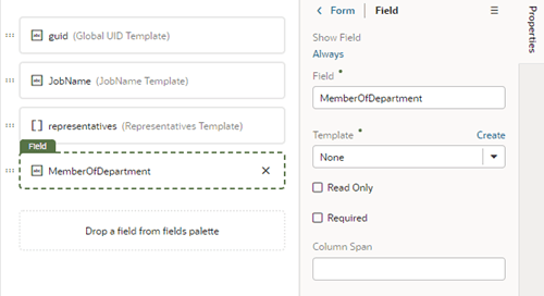

    When you select the field, you can see the field’s properties in the Properties pane. By default, the Show Field property is set to Always, so the field is always displayed.
    Description of dynamicui-rulesets-layoutfields-notemplate.png follows
    Description of the illustration dynamicui-rulesets-layoutfields-notemplate.png

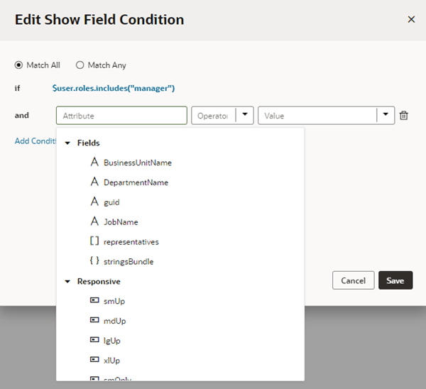

  2. In the Properties pane, click Always under the Show Field property to open the Edit Show Field Condition dialog box.
  3. Define the field’s conditions by selecting attributes, operators and values in the condition builder in the dialog box. Click Save.
    The Attributes drop-down list contains the fields and variables that you can use in your layout, and the Operators list contains the operators (for example, ‘=’ and ‘<=’) that are valid for the attribute you select. The Values list shows values already defined for the attribute (for example, ‘true’ and ‘false’), if any, but you can also enter your own value.
    The Attributes variables are grouped by context in the list. In addition to the $fields context, there are variables in other built-in contexts that provide a way to access various pieces of information when building conditions. For example, you can check the size of the device accessing your app, or information about the user using the app such as their role or email. Context variables include:
    • $fields variables determined by the fields displayed in the Fields editor. For example, the $fields.firstName.value lets you access the value of the First Name field in your data source. Look for these variables under the Fields group in the condition builder.
      Note: For each field, regardless of type, you can choose $numberValue. For example, $fields.ConflictId.numberValue() or $value ($fields.ConflictId.value(). You should use $numberValue when you know the field’s value should contain a number. For example, if the ConflictId field’s type is a string and you choose $numberValue, the field’s value will be converted to a number, if possible. If the value can’t be converted, the $numberValue will be NaN (Not a Number).
      The only limitation is that $numberValue is limited by the maximum precision allowed by the Number type in Javascript.
    • $responsive variables determined by the screen size of the device the app is currently displayed on. For example, the responsive.mdUp variable’s value is True if the current user is using a device where the screen width is 768 pixels or more, such as a tablet. Look for these variables under the Responsive group in the condition builder.
    • $user variables determined by the current user. For example, the user.isAuthenticated variable’s value is True if the current user is an authenticated user. You can use the user.roles variable to check the role of the user using the app. Look for these variables under the User group in the condition builder.
      Note: When using user.roles, start entering the role name you need in the Value field. The Value drop-down will display up to 25 matching Oracle Cloud Applications job and abstract roles; keep typing until the desired role displays. (The drop-down will not list any duty roles. If you want to specify a duty role, you can manually type the duty role name in the Value field.)
      You must be granted the ASE_REST_SERVICE_ACCESS_IDENTITY_INTEGRATION_PRIV privilege to see user roles in the drop-down list. Contact your instance administrator if you require this user privilege.
    Description of dynamicui-rulesets-showfieldcondition.png follows

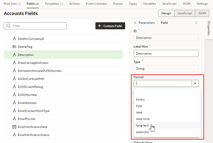

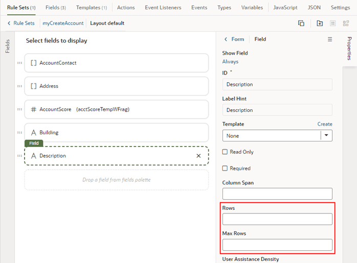

Set a Field to Display as a Text Area in a Form
If a field’s value is a long string, for example, when a field is used to display a long description, you can configure the field so that it is rendered as a multi-line text area in forms instead of the default single-line text field.

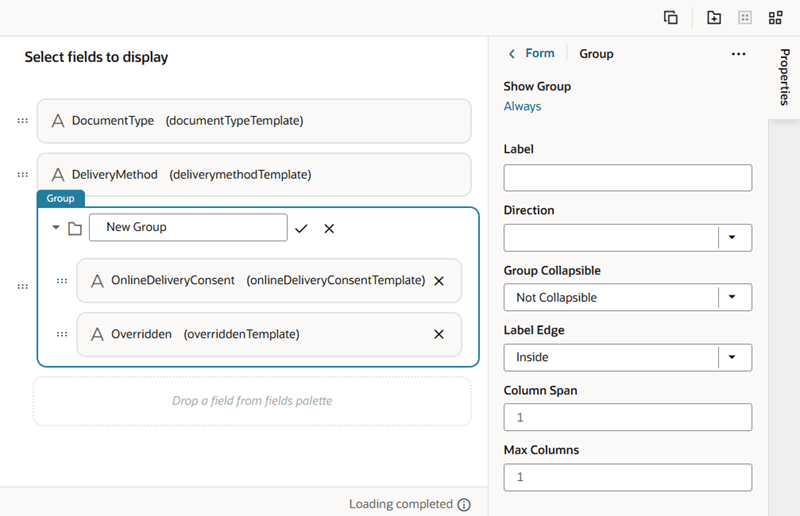

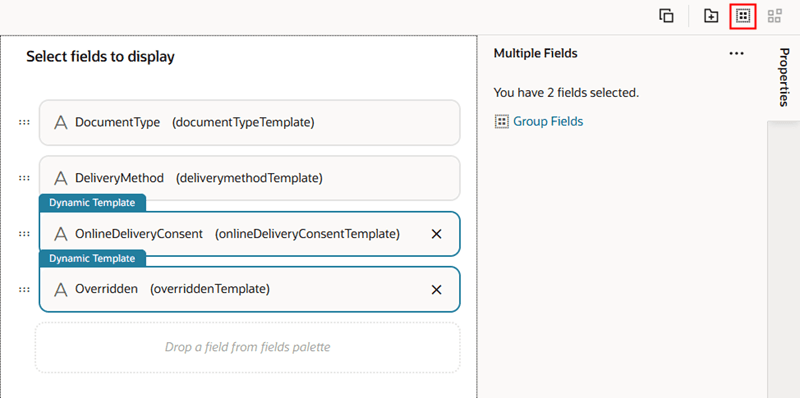

  3. In the layout diagram, select the fields that you want to group together, either by holding down the CMD key (on macOS) or the Ctrl key (on Windows).
  4. Click Group Fields in the Properties pane, or Group Fields icon in the toolbar.
    Description of group-fields-create.png follows
    The selected fields are grouped under a new folder in the layout diagram:
    Description of group-fields-name.png follows
  5. Enter a name for the new group. Click Check mark icon to save the group name.
  6. (Optional) Set properties for the group in the Properties pane.

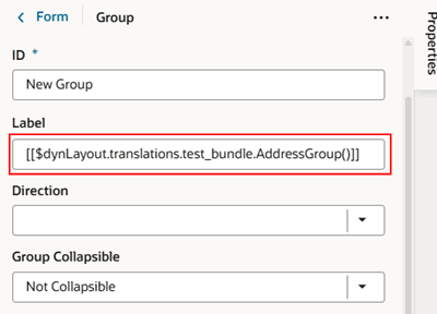

Note: If you want to use a translation bundle for a string you enter in the Label property, you currently need to manually enter the translation expression in the Label field in the Properties pane, and edit the layout’s json file (layout.json) to add the import element for its translation bundle. For example, if the label was Address Group, and the name of the translation bundle was test_bundle, you would add [[$dynLayout.translations.test_bundle.AddressGroup()]] in the Label field:
Description of group-fields-label-translate.png follows
You would also need to manually add the import for the translation bundle to the json file (in this example, test_bundle):
