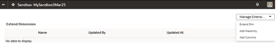

  4. In the Manage Extension list of values, select Extend Dim.
    The Manage Extensions list of values

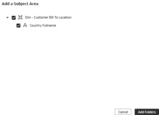

  5. In Add a Subject Area, select Country Fullname and click Add Folders.
    The Add a Subject Area dialog displaying the extended Country Full Name column in the prebuilt Customer Bill-to Details folder
