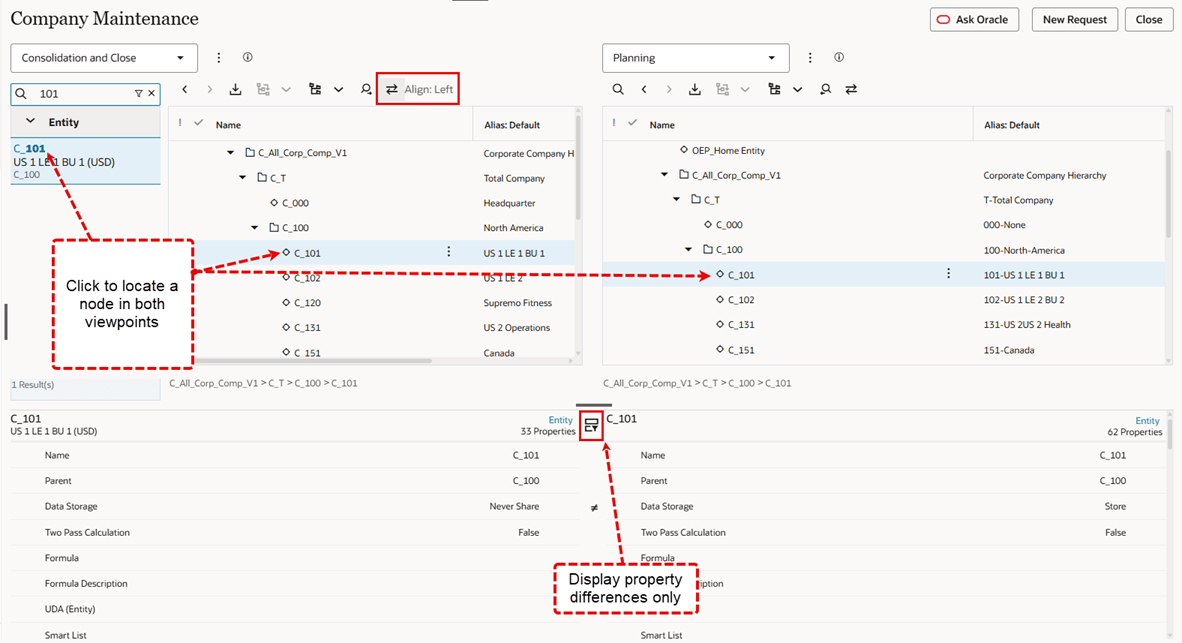

    The screenshot below shows that when you click Align align button and then select node 101 in the search result, the navigation links, or the viewpoint on the left, the node is also displayed in the viewpoint on the right (if the node exists in that viewpoint). It also shows the list of properties for each viewpoint separated by a horizontal line. The properties above the line are the properties that the two viewpoints have in common or that are mapped by a node type converter. The properties below the line are ones that are different between the viewpoints.
    Tip:
    When you are displaying aligned nodes on the Compare tab, you can optionally click Filter to Differences Only Filter to Differences Only button to display only the properties that have different property values.
    property differences in align nodes and properties screen with align button highlighted
