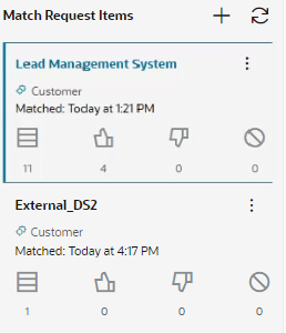

Match Request Items Panel
Result panel as described below
The Match Request Items panel displays the match result sets for the matches that you have run for this request by data source. If your request contains request items with different data sources, you can run matches for each data source and the results are displayed in the match request items panel. Click a match result set to switch your view to the matches from that data source.
Match results sets persist if you navigate away from the matching workbench (for example, by returning to the request view or closing the viewpoint).
Each match result set displays the total number of request items that have match candidates, as well as the number of request items with match candidates that were accepted, rejected, and skipped.
From this panel, you can perform the following actions:
