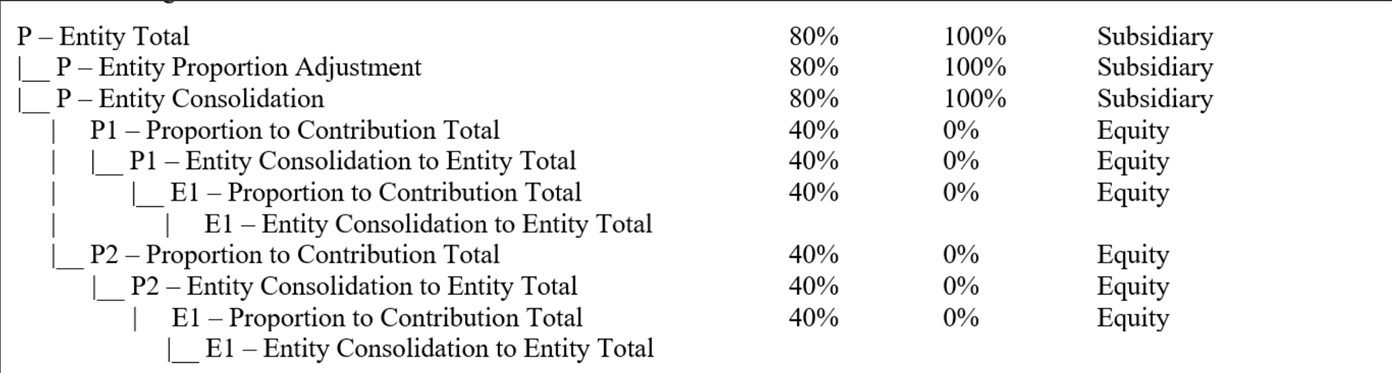

    For example, if you have two shared instances of an entity consolidating to a common parent via two different branches of the hierarchy, and they are both consolidated using the Equity method (40% ownership via each branch), then at Entity Consolidation of the common parent, the result would be data representing an 80% Equity consolidation. Instead, what is required is an 80% Subsidiary consolidation, which is different. Entity Proportion Adjustment and Entity Elimination Adjustment are used to adjust the data contributed via the two branches to what the data would have been if a direct 80% Subsidiary consolidation had been done (that is, in the flat entity structure). The 80% Equity data in Entity Consolidation aggregated with the EPA / EEA adjustment data would then accumulate to the required 80% Subsidiary consolidation data at Entity Total.
    Entity Proportion Adjustment example
