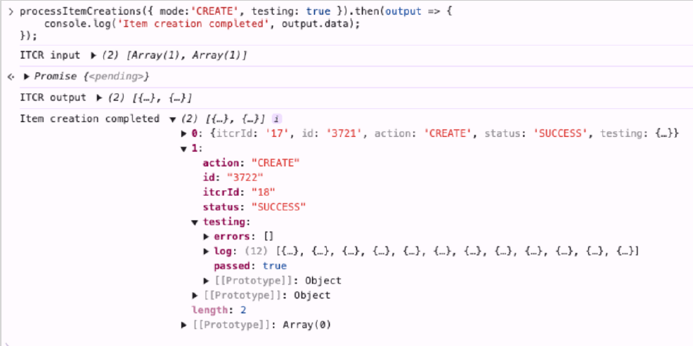

Creating Items And Verifying The Results
This example creates items and verifies the item creation results also includes the testing parameter.
              processItemCreations({
    mode: 'create',
    testing: true
}).then(output => {
    console.log('Item creation completed', output.data);
The returned output will include a testing object for each processed item with the following information: validation status (passed), detected errors (errors), and a detailed logs (log).
An example of the testing parameter output for processItemCreations().
