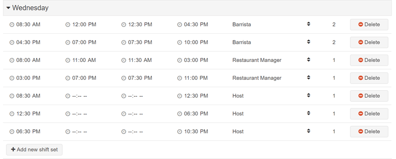

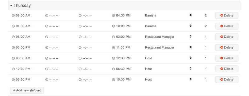

  1. To create the initial template, go to Shift Template setup, available by Setup > Locations and selecting a location. When selected, click on Scheduling and Template shifts.
  2. Click on a day to expand and view all template shifts on that particular day. If there are no template shifts, you will see a button 'add new shift set'
  3. The list of headers that appear are:
    • Start – start time of template shift
    • Break start – start time of the break of the template shift (Only used with the Shift Template Model option)
    • Break finish — end time of the break of the template shift (Only used with the Shift Template Model option)
    • Finish — finish time of template shift
    • Job — the job assigned to this template shift
    • Count — number of shifts with this day (explained below)
The following are sample settings for a template shift:
  • start time of 7:00am
  • finish time of 4:00pm
  • Break start time of 12:30pm
  • Break end time of 01:00pm
  • Job of Manager
  • Count of 2 employees working this shift
The count of 2 above means two template shifts will appear, both starting at 7am and finished at 1:30pm of the job Manager

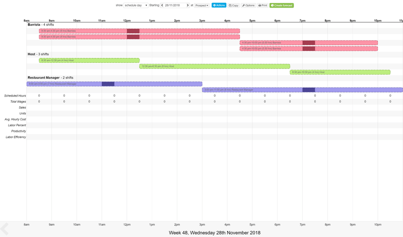

The shifts created earlier show up below. Note the differences from normal scheduled shifts:
  • No names attached to the left of shifts
  • Dotted shift outline
  • No cost associated to shifts
  • No wages or scheduled hours added to KPI's
Shift templates in action

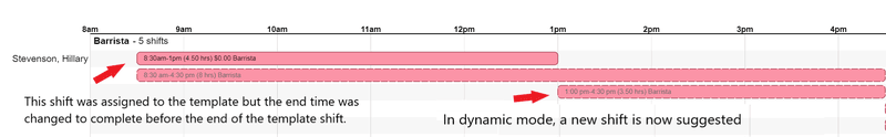

The Model Shift template is dynamic. It suggests what coverage is still needed after you start filling shifts.
If you assign part of a template, it will show what still needs to be filled.
Model shift template type
