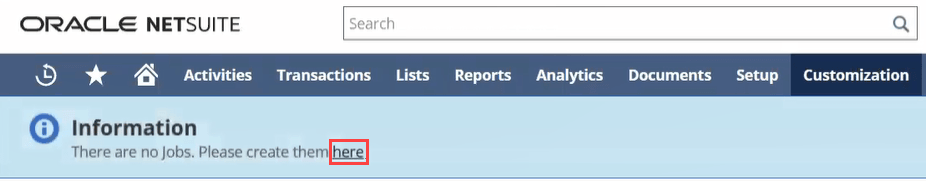

    Tip:
    If you haven't yet added any Planning and Budgeting or Data Exchange jobs for the integration, click here in the Information bar to access a NetSuite page where you can add the jobs.
    Page with information message stating there are no jobs and link to create jobs

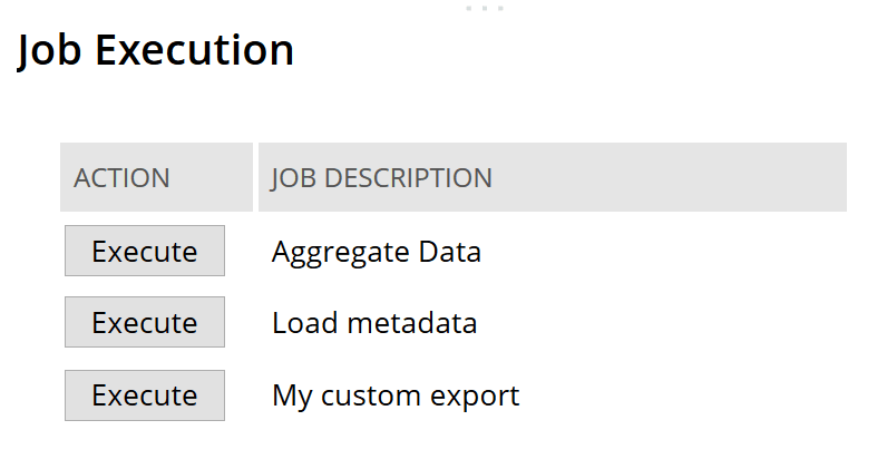

    The following screenshot shows an example of the portlet setup:
    Example of a Job Execution portlet setup
  7. Click the Execute button for the job you want to run. The button is dimmed and marked with one of the following icons:
    • An information icon An information icon - When you hover over the icon, a message appears indicating whether the job execution was queued or is already in progress.
    • A red cross icon A red cross icon - When you hover over the icon, a message appears indicating the reason for the job failure.
  8. You can watch the status of the job execution in the corresponding Execution Logs portlet. See Execution Logs Portlets for NSPB Sync.
