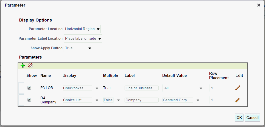

  2. In report editor, click Parameters to launch the Edit Parameters dialog as shown in the following figure.

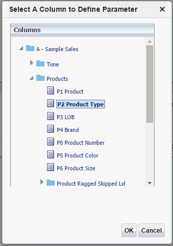

  3. Click Add to launch the Select a Column to Define Parameter dialog as shown in the following figure.
  4. Select a parameter column and click OK to launch the Edit Parameter dialog as shown in the following figure.
    The options displayed for selection in the Edit Parameter dialog are driven by the parameter column data type.
  5. Enter the parameter label to be displayed in the report.
  6. Select a parameter display option:
    • Calendar - Provides users with a field into which they can enter a specific date, as well as a calendar pop-up to select a date. This display option is only available for selection if the parameter has a date column type.
    • Choice List - Provides users with a collapsed list of all prompt values. This display option is useful for a long list of values where you want to provide the user with the ability to search for a specific value.
    • Checkboxes - Provides users with a visible list of all prompt values where a small, selectable box displays before each value item. This display option is suitable for a prompt that contains a smaller set of data.
    • Radio Buttons - Provides users with a visible list of all prompt values where a radio button is displayed before each prompt value. This display option is useful for short lists of values where the user is to select only one prompt value.
    • Text - Provides users with a field into which they can enter a specific prompt value. This display option cannot be used for multiple prompt values. Only the field and the field label are displayed for this option.
  7. Select the parameter operator. The default value is set to is equal to/is in.
  8. Click OK.

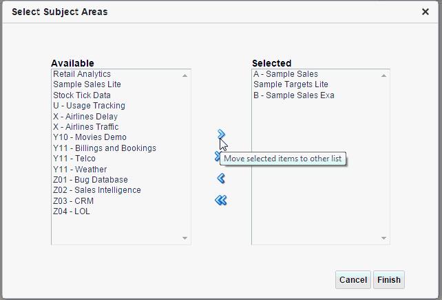

  1. Use the report editor to open the report. The upper left corner displays the subjects areas already linked to the report.
  2. Click Edit Subject Areas to launch the Select Subject Areas dialog as shown in the following figure:
  3. From the Available pane, select one or more subject areas.
  4. Click Add to move the subject area(s) to the Selected pane.
  5. Click Finish.
