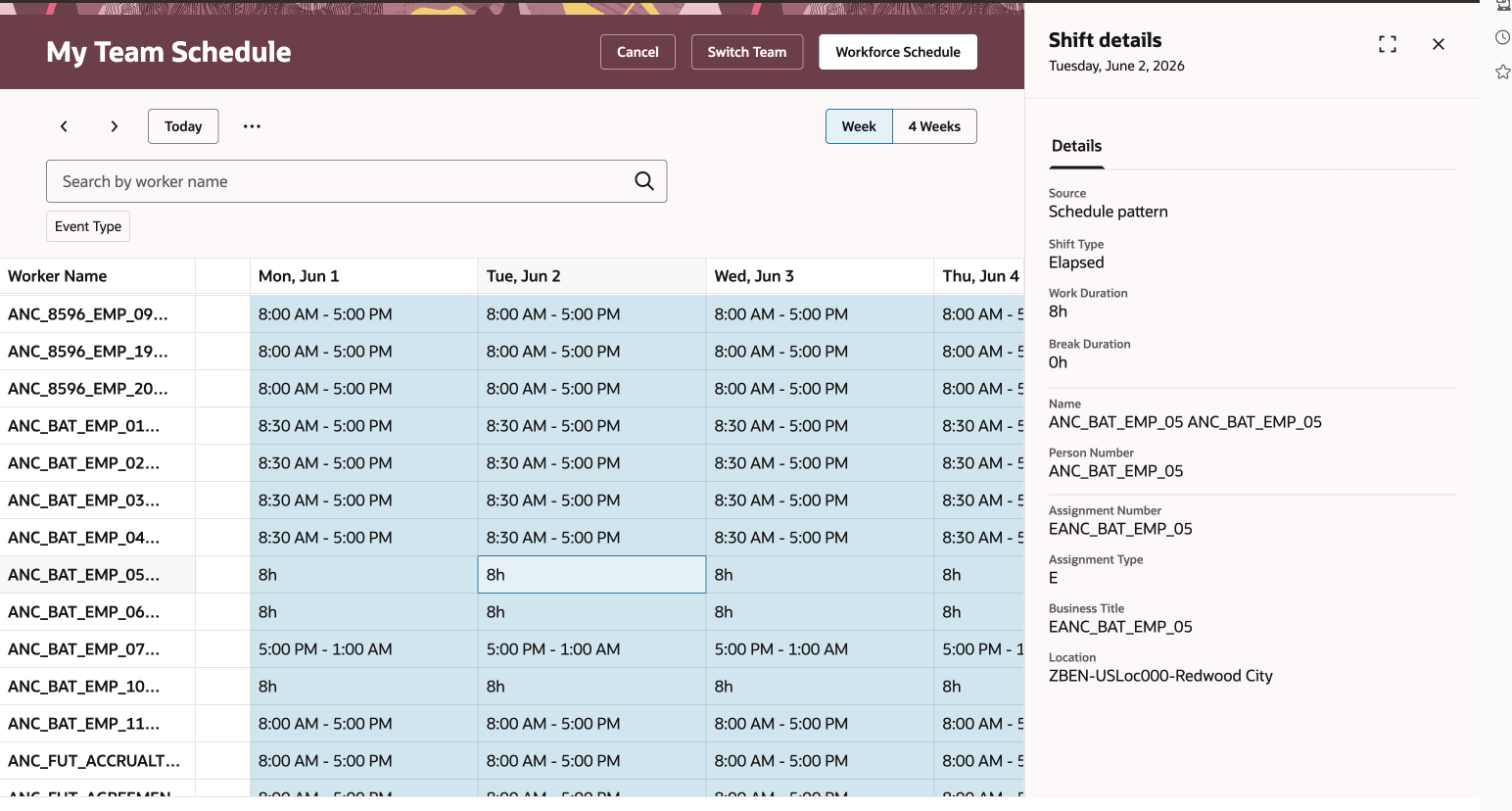

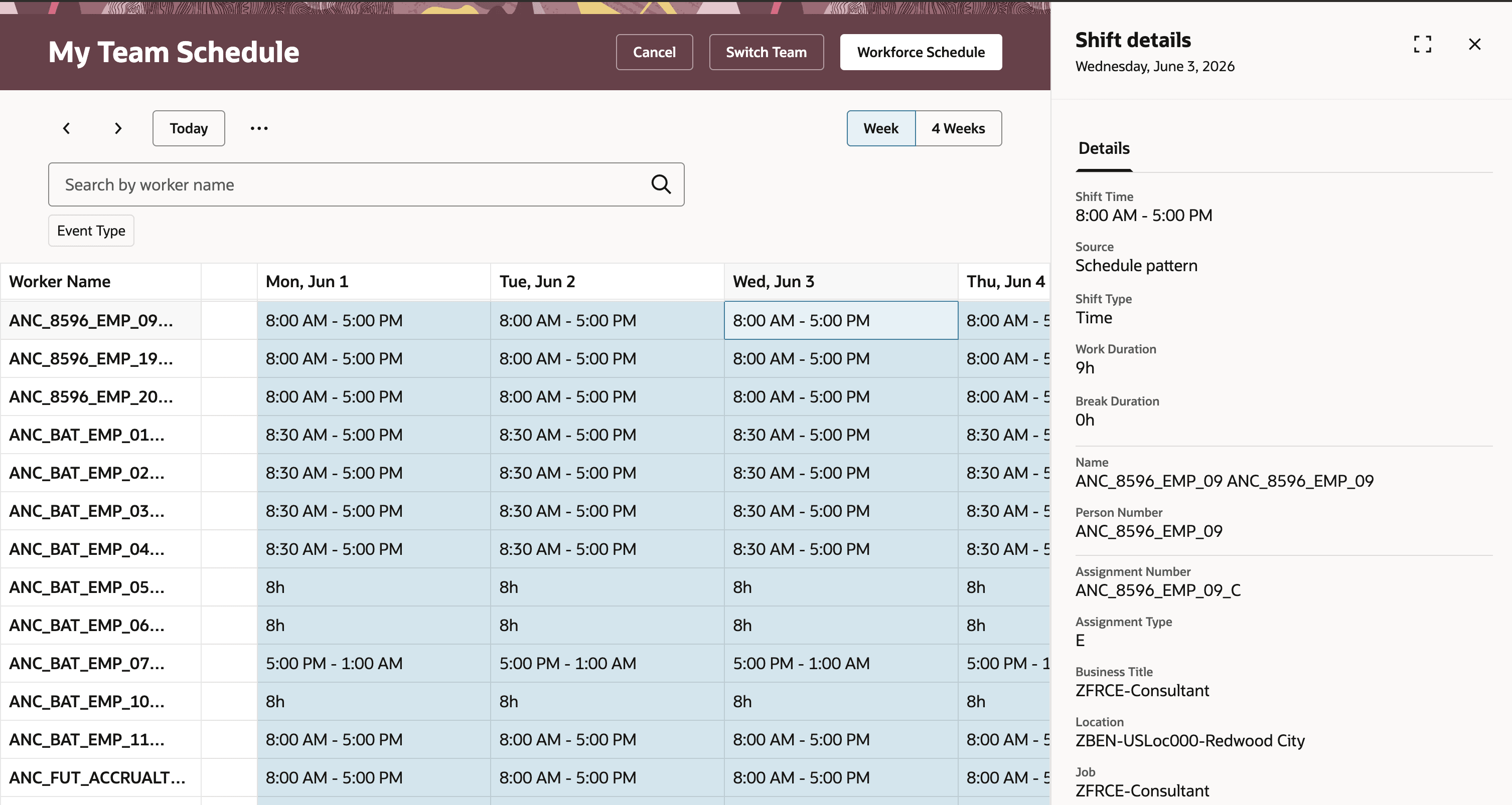

After the process runs, line managers and time administrators can view these shifts in Redwood Team Schedule as part of the published schedule color-coded category, together with other schedule and absence information. Both Time based and Duration (Elapsed) Shifts will be shown with the Source: Schedule pattern.
Team Schedule with Schedule Pattern Time Shifts
Team Schedule with Schedule Pattern Elapsed Shifts
