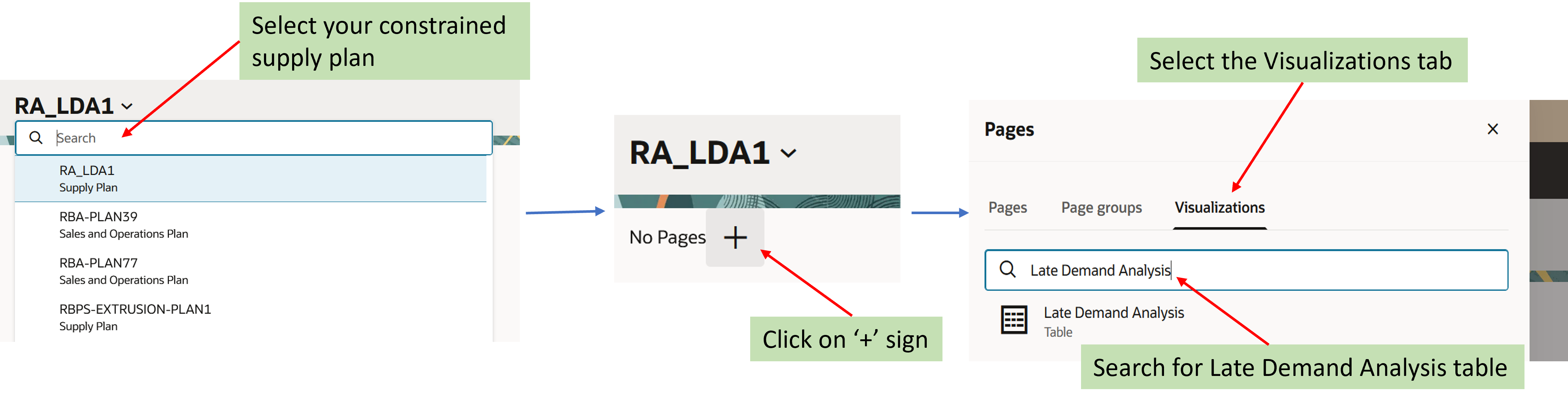

- Select a constrained supply plan from the plan selector.
- Click the ‘+’ sign to open Pages.
- Select the Visualizations tab.
- Search for the Late Demand Analysis table.
- Select the table to open it.

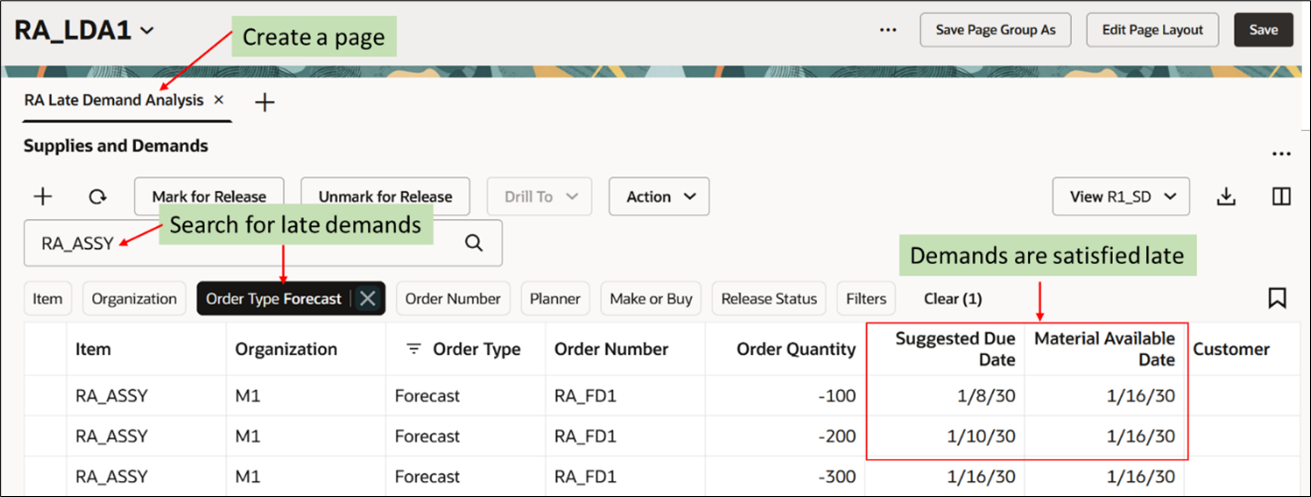

- Create or open a page with Supplies and Demands table.
- Identify the demands that are satisfied late.
Open Supplies and Demands Table

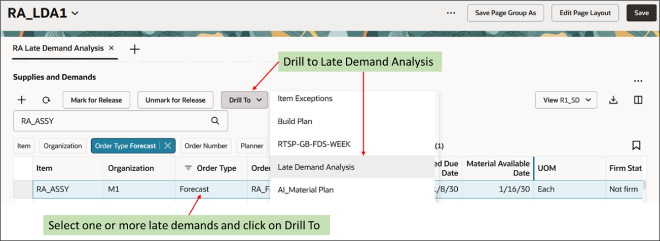

- Select one or more late demands, and then drill to the Late Demand Analysis table.
Drill to Late Demand Analysis Table from Supplies and Demands

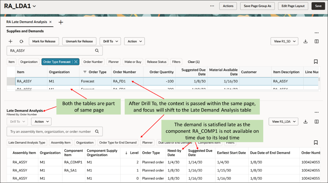

If the Late Demand Analysis table is part of the same page, then the context of the late demand is passed within the same page, and the focus shifts to the Late Demand Analysis table.
Supplies and Demands and Late Demand Analysis Tables on The Same Page

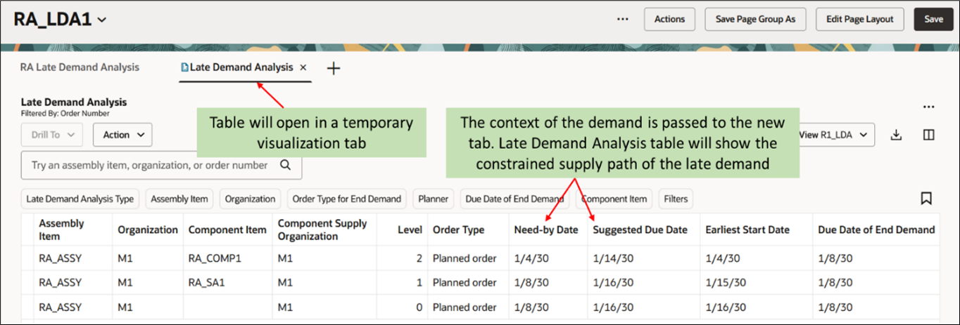

If the Late Demand Analysis table is not part of the same page, then it opens in a new temporary tab. The context of the late demand is passed to the new tab. The Late Demand Analysis table shows the constrained supply path of the late demand.
Late Demand Analysis Table in a New Tab

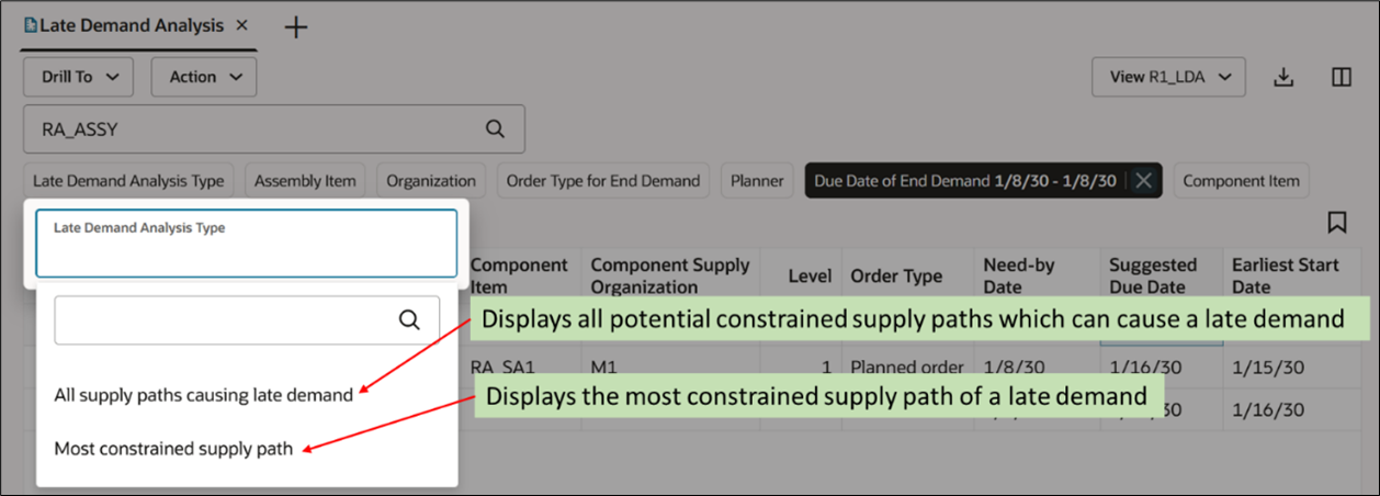

Late Demand Analysis Type
You can analyze a late demand using one of the two options:
- Identify the most constrained supply path (the path causing the maximum delay). Resolve the lateness and repeat the process.
- Identify all the potential supplies that can cause demand lateness.
Use the Late Demand Analysis Type Filter

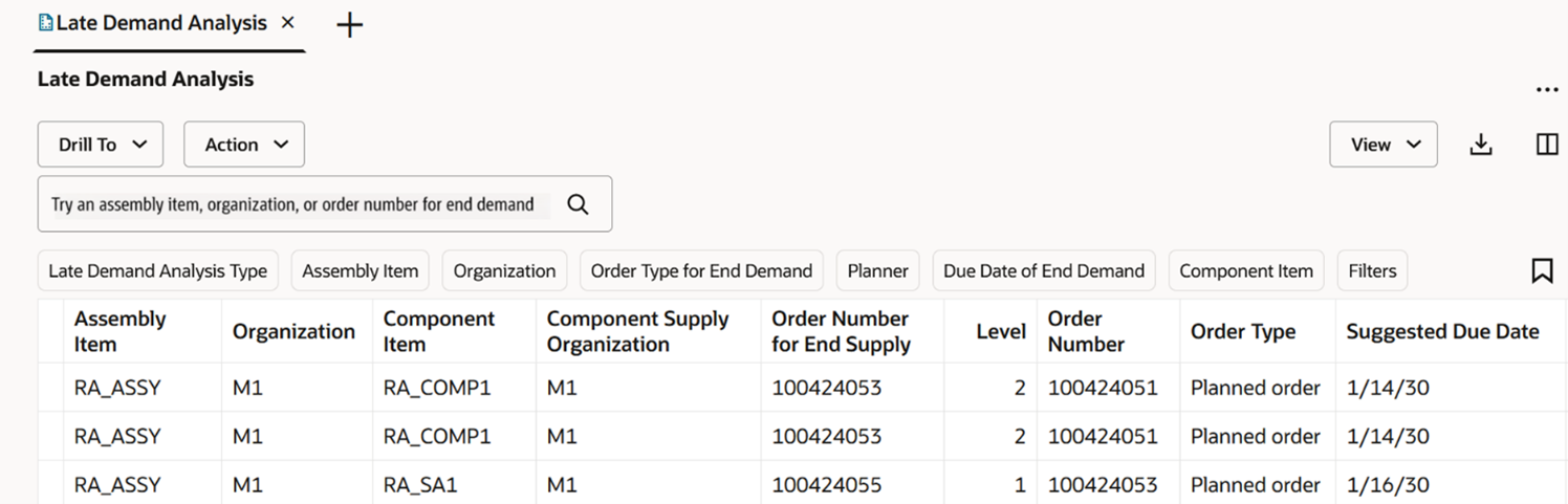

Viewing the Late Demand Analysis table

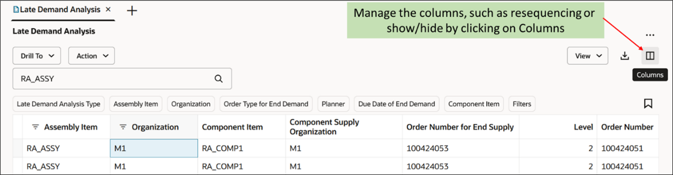

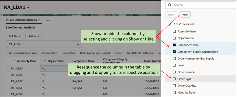

You can customize the view of your Late Demand Analysis table by rearranging the order or toggling the visibility using the Columns option.
Rearrange Columns
Toggle the Visibility of the Columns

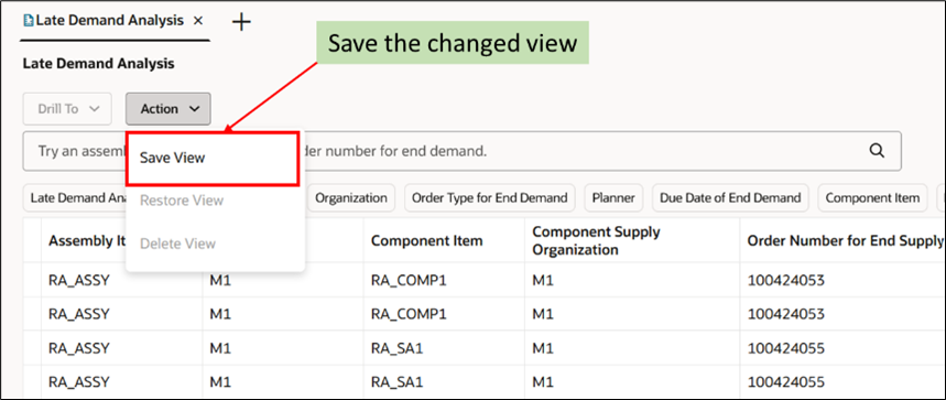

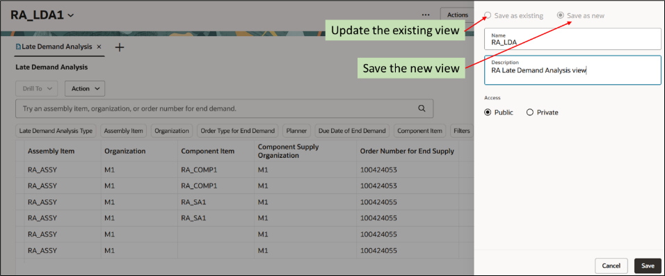

After you've rearranged the columns, save the updated table view.
Save Late Demand Analysis Table View
You can open an existing table view through the View menu.
Select an Existing View
You can also modify an existing table view.
Modify Existing Late Demand Table View

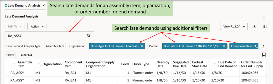

You can analyze late demands based on different attributes using filters. For example, you can analyze the late forecasts of a finished good for a time-range of end demand due dates.
Use Search and Filters to analyze late demands

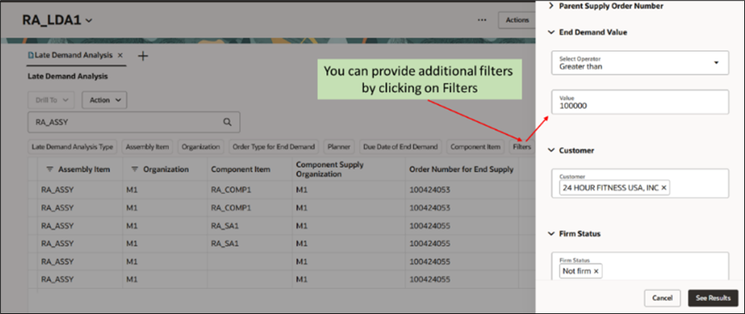

You can provide additional filters by clicking the Filters option.
Use More Filters to Analyze Late Demands

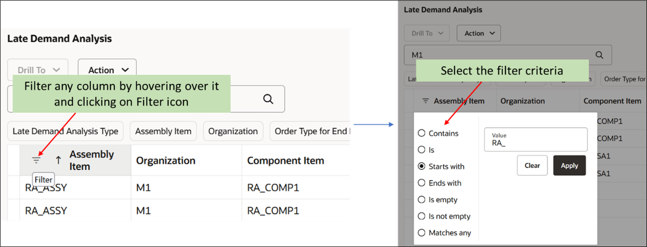

You can apply a filter to an individual column. Hover over the column header, click the filter icon and select the required criteria.
Filter Individual Columns

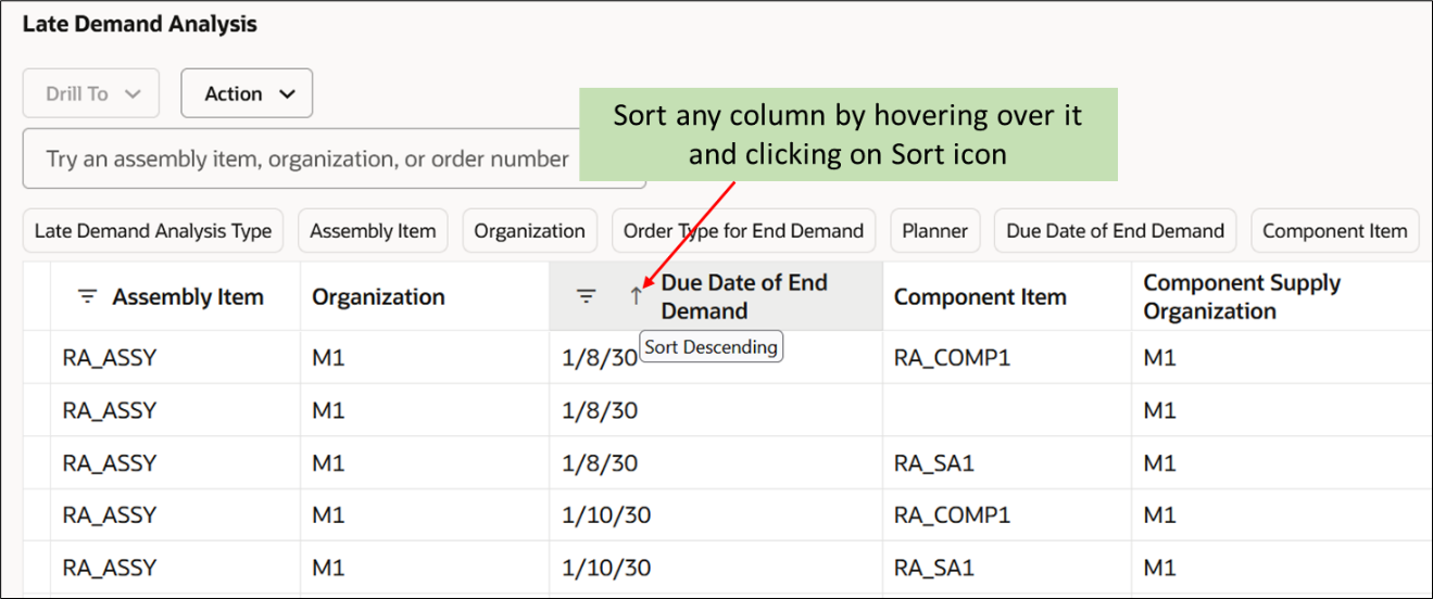

You can sort the data in any column by hovering over it and then clicking the sort icon.
Sort Columns

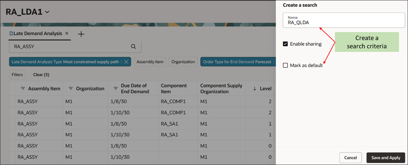

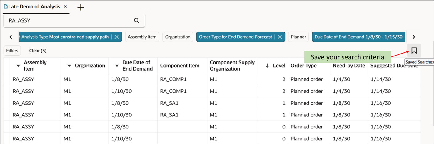

After you’ve filtered and sorted the table, you can save your search criteria and name it.
Save the Search Criteria
You can share the saved table containing your search criteria with others or mark it as a default search.
Save Table with Search Criteria for Quick Access and Reuse

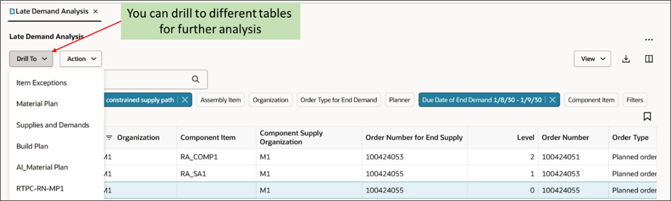

You can drill to different tables from the Late Demand Analysis table to further analyze and resolve the root cause of lateness.
Drill to Another Table from Late Demand Analysis Table

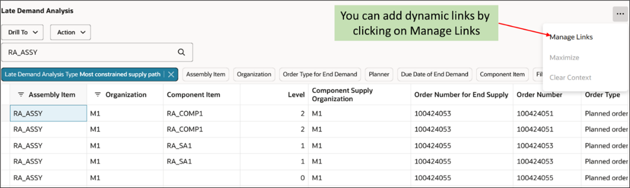

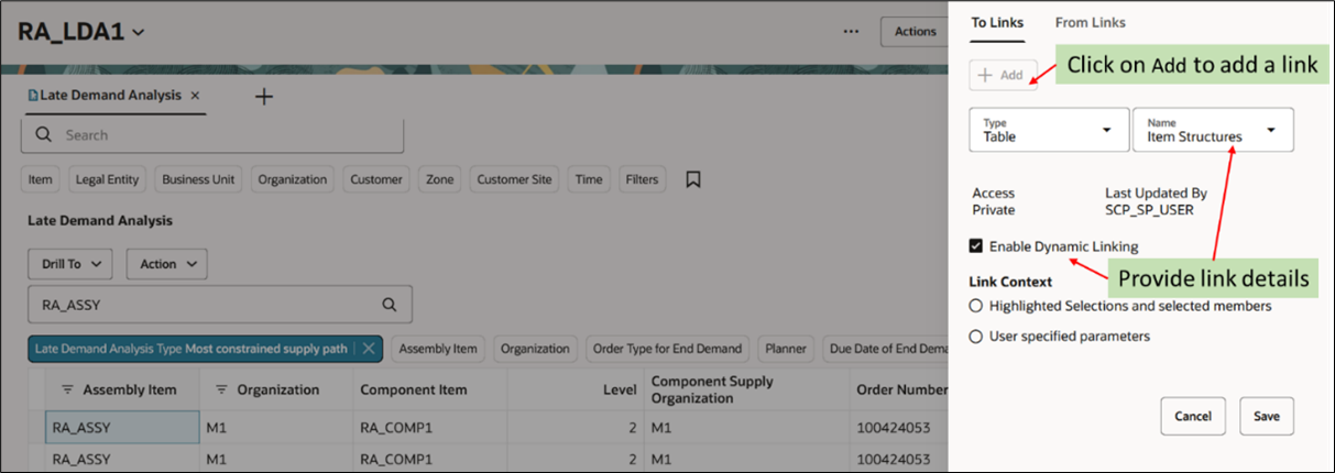

Managing Links
You can add dynamic links to and from the Late Demand Analysis table. Click Manage Links on the Actions menu.
Manage Links in Late Demand Analysis Table
Provide the link details and click Save.
Create a link in Late Demand Analysis Table

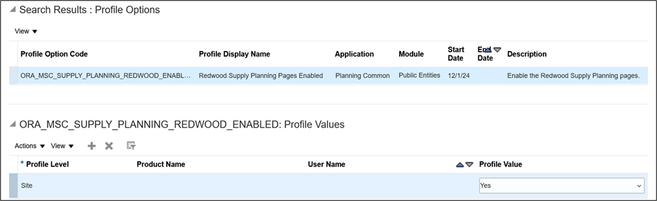

Steps to Enable
To enable the Redwood Supply Planning pages, you need to set the profile Redwood Supply Planning Pages Enabled to Yes.
Manage Planning Profile Option
