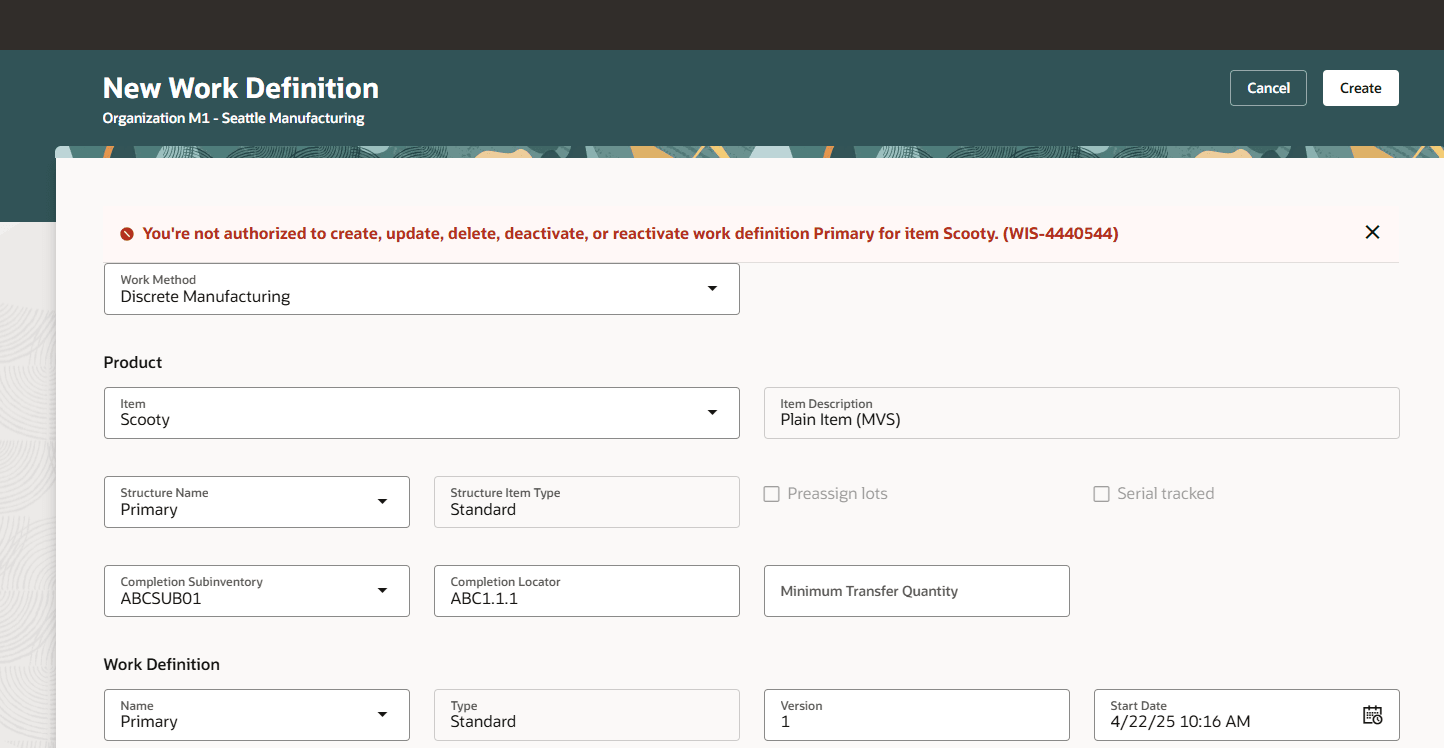

The following screenshot shows the error message that is displayed when the user tries to create a work definition for an item category, for which the user has only view access.
Work Definition Data Security Error

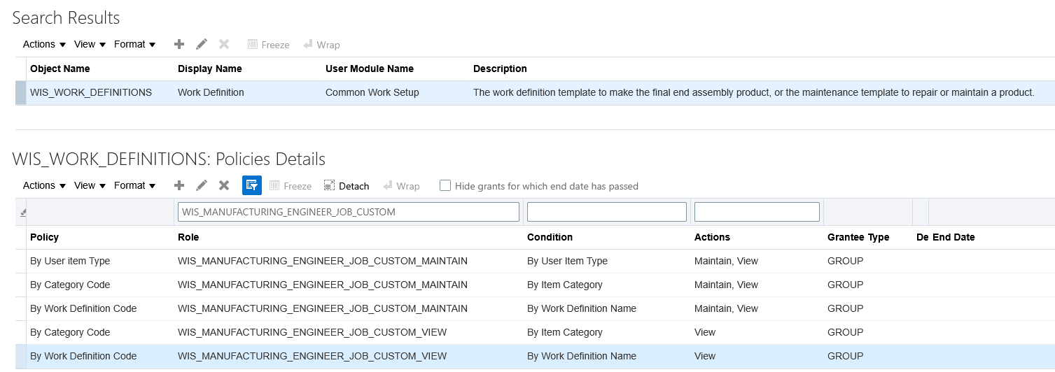

A data security policy is defined by specifying a predefined or configured condition and one or more actions. The data security policy is assigned to predefined or configured job roles.
The following screenshot shows data security policies that have been defined for various conditions for a configured role.
Data Security Policies

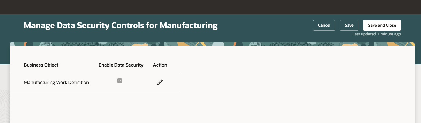

After defining data security policies in the security console, you must also enable data security for manufacturing work definitions using the Manage Data Security Controls for Manufacturing task in the Setup and Maintenance work area.
Data security for manufacturing work definitions enables granular control on the authoring, maintenance, and visibility of work definitions to align with business policies.

To enable data security for the manufacturing work definition business object, use the following steps:
- In the Setup and Maintenance work area, navigate to the following:
- Offering: Manufacturing and Supply Chain Materials Management
- Functional Area: Manufacturing Master Data
- Task: Manage Data Security Controls for Manufacturing
- Select the Enable Data Security checkbox for the Manufacturing Work Definition business object.
