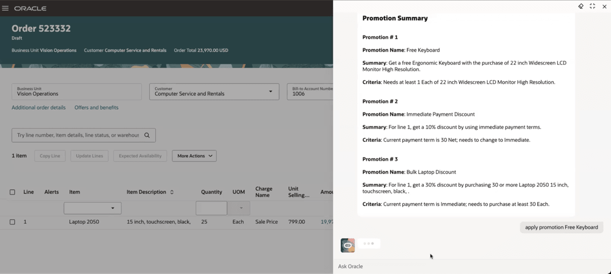

Each recommendation includes a summary about the promotion and details about the criteria that you must meet to get the promotion. This example has three recommended promotions:
The Promotion Summary section includes a list of ranked recommendations. Each recommendation includes the promotion's name, a summary, and the criteria that you must meet to get the promotion:
- Promotion 1. Buy a monitor and get a free keyboard.
- Promotion 2. Pay immediately and get a 10% discount.
- Promotion 3. Buy a quantity of 30 and get a 30% discount.
Pricing ranks the promotions in the Promotion Summary section numerically:
- Ranks a promotion that applies to all items higher than one that applies to only a single item.
- Ranks according to how relevant the item's description is on the sales order to the item's description on the promotion.
- Ranks according to the item's category on the sales order compared to the item's category on the promotion. Pricing considers the product catalog's hierarchy when it does this ranking.

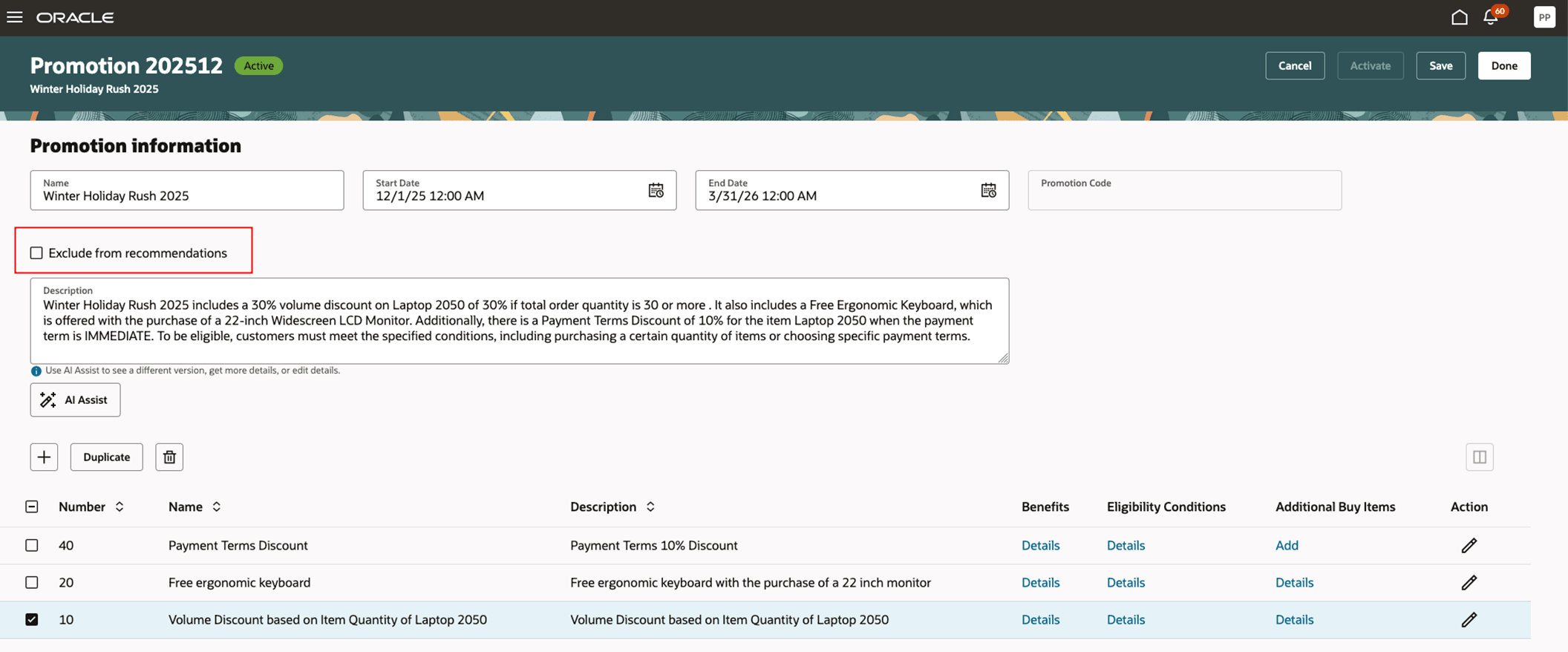

If you don't want to include a promotion as part of the recommendation, then you can use the new Exclude from Recommendations attribute in the Pricing Administration work area:
