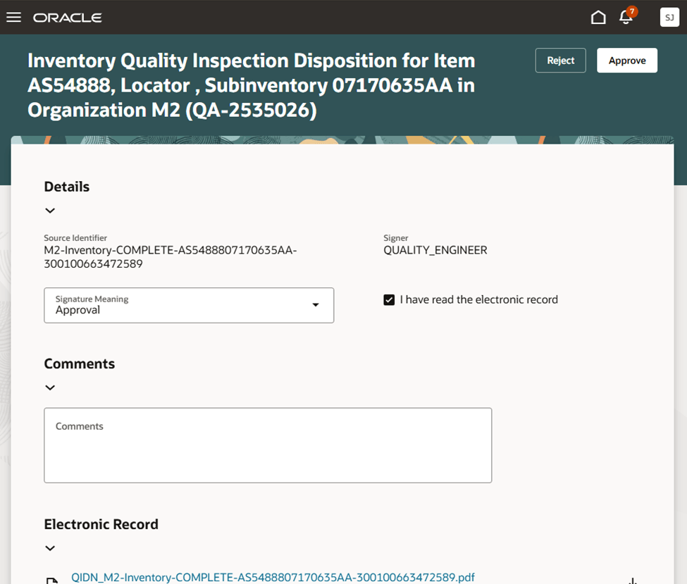

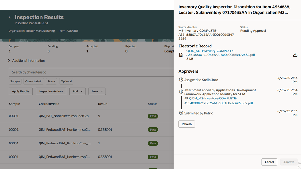

Approval Submission in the Redwood Format
E-Signature Approval in the Redwood Format
