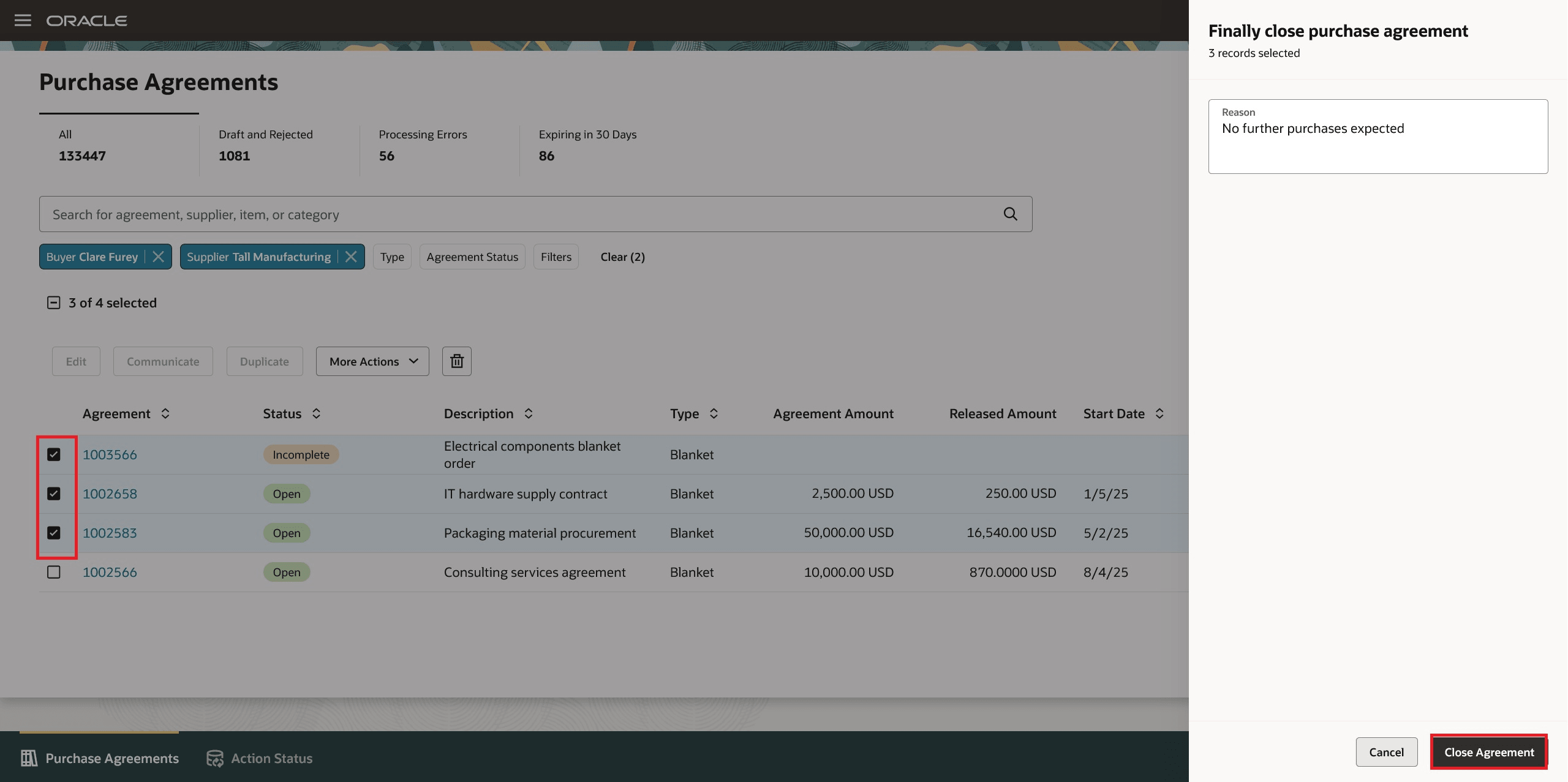

Execute actions on multiple purchase agreements simultaneously by selecting them on the Redwood Purchase Agreements page and submitting a single action.
These screenshots illustrate the feature.
Select and Act on Multiple Purchase Agreements

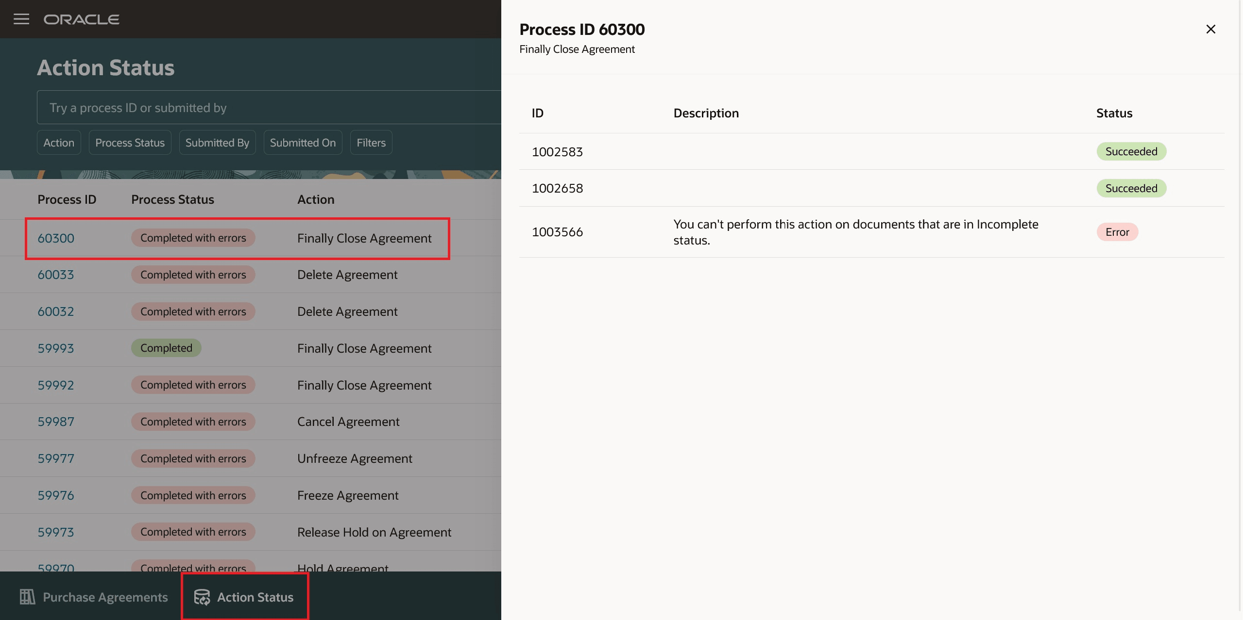

You can then monitor progress and review action results from the Action Status page.
Monitor Action Status and View Results
