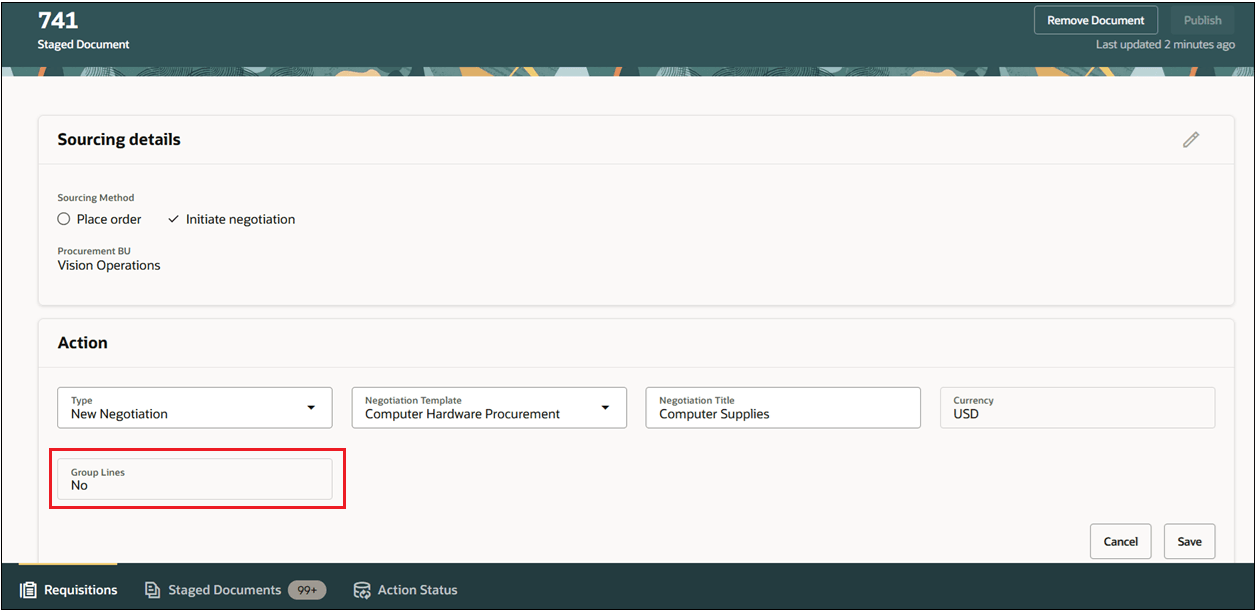

When DFF values from the requisition lines are copied to the negotiation, grouping of the requisition lines isn't supported.
Default Group Lines as No
