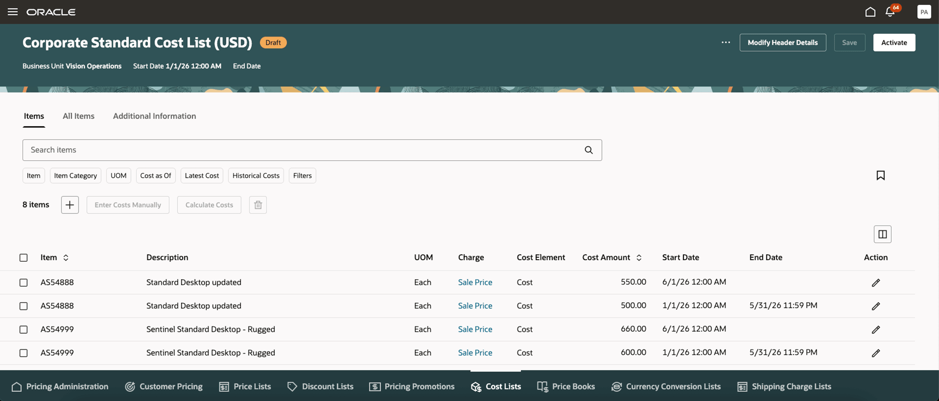

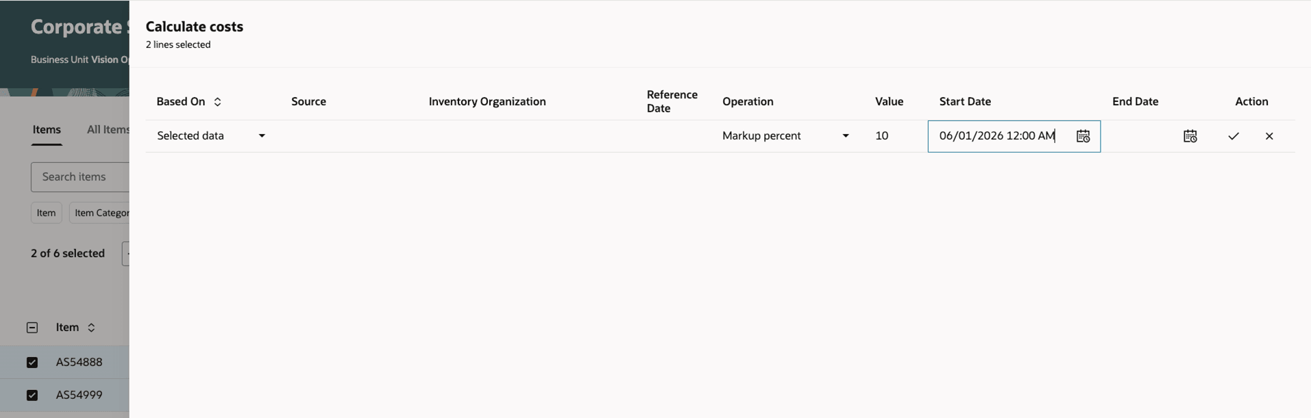

Example 1:  You want to increase the cost for two items by 10% starting on June 1.
1.    Select the items you want to increase the cost by, and click the Calculate Costs button.  A drawer opens where you can select the Based On value, Operation, and Start Date.  By specifying the start date, the existing record is end dated and a new cost is created.
Calculating Costs Based On Selected Data
Calculating Costs Based On Selected Data from the Current Cost List
Corporate Standard Cost List with the Two Added Rows with New Costs Starting June 1

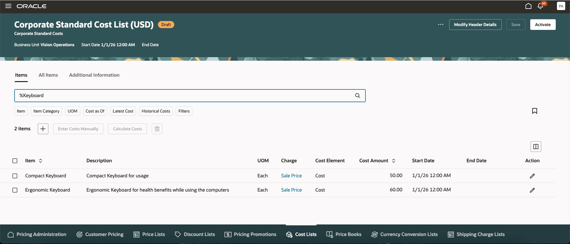

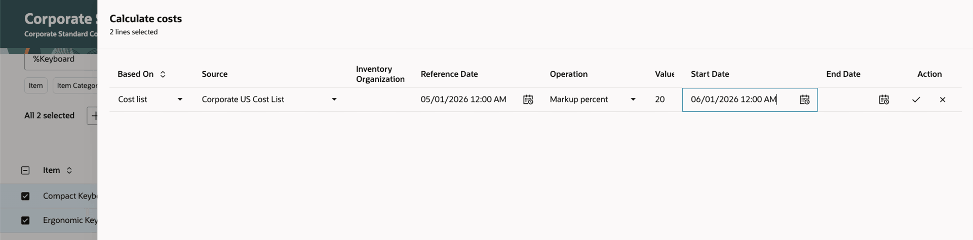

Example 2: You want to set the cost of the keyboard items on the Corporate Standard Cost List based on the cost values defined on the Corporate US Cost List. The costs starting on June 1 will be calculated as 20% value of the cost on specified on the Corporate US Cost List.
Price List Item Cost
Corporate US Cost List Compact Keyboard $40 (on May 1)
Corporate US Cost List Ergonomic Keyboard $30 (on May 1)
Searching for Keyboard
Calculating Costs Based On Cost List
