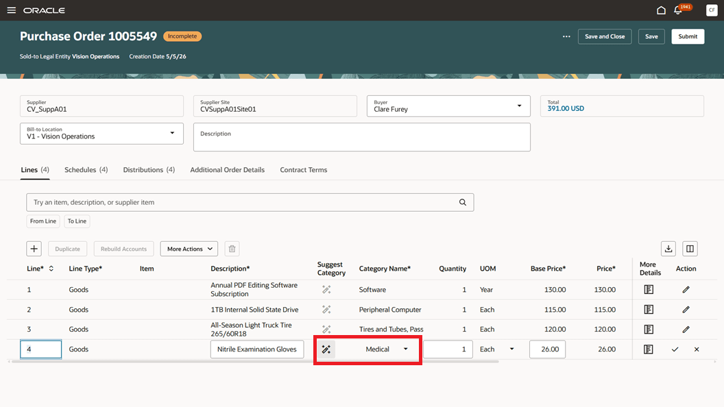

Get category suggestions for description-based lines in purchase orders, blanket purchase agreements, and change orders. When you select the Suggest Category action, the application analyzes the entered description using historical purchasing data and recommends the best-fit category. This helps improve spend classification accuracy and reduce manual category entry.
Suggest Category for a Description-Based Purchase Order Line

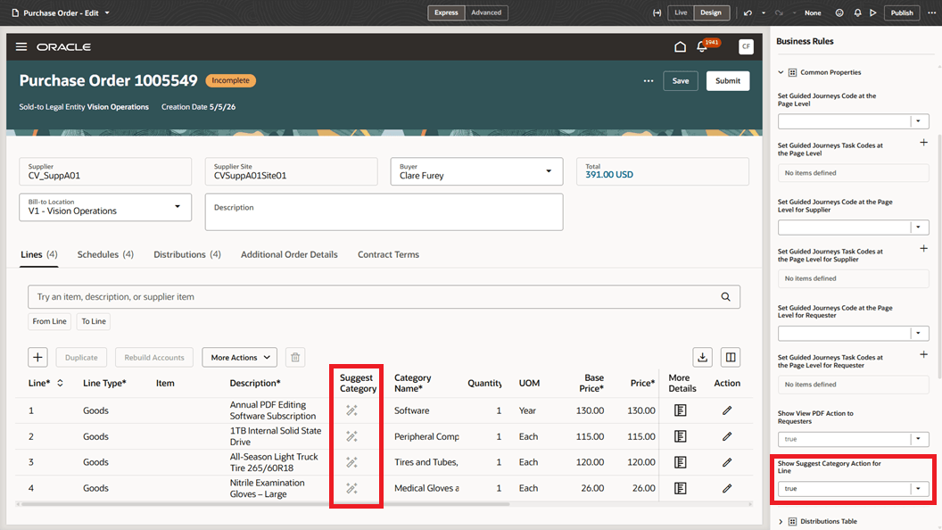

The Suggest Category action is hidden by default. To configure the page to display the action, follow these steps:
- In Oracle Visual Builder Studio, open the Redwood purchasing document page that you want to configure, such as the Purchase Order or Blanket Purchase Agreement page.
- In the Page Properties pane, navigate to the Common Properties section.
- Set the Show Suggest Category Action for Line property to true.
- Publish your changes.
Enable Show Suggest Category Action for Line in Page Properties
- Run the Prepare the Purchasing Category Suggestion Model scheduled job to prepare the classifier used for category suggestions. Consider scheduling this process to run periodically so the model can be refreshed as new approved purchasing document history becomes available.

- The Suggest Category action is enabled only for description-based lines when the category is editable and a description has been entered. The action remains disabled when the category isn't editable, the line is item-based, or the description is blank.
- When you select the Suggest Category action, the application first looks for an exact match using prepared historical purchasing data. If no exact match is found, it uses fuzzy matching and historical frequency to identify the best-fit category.
- If the classifier can’t determine a matching category, the Suggest Category action doesn’t return a suggestion.
- You can manually override the suggested category after it’s populated.
