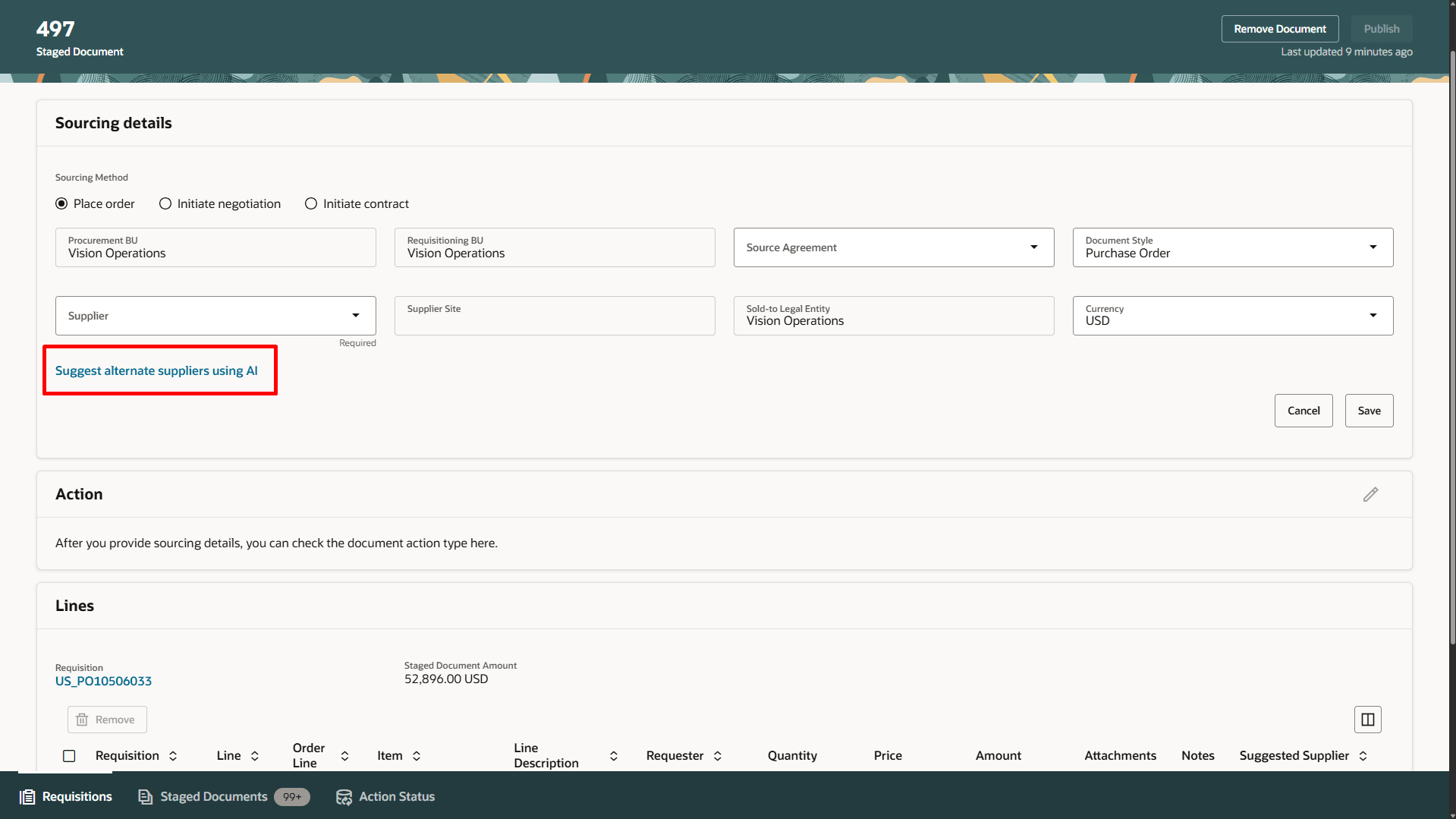

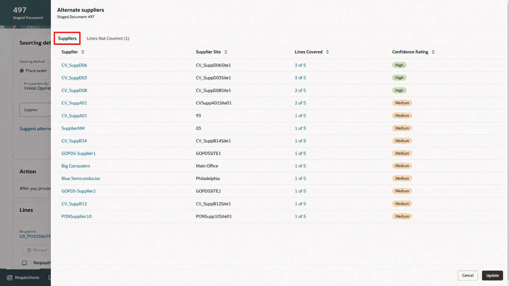

When you create a staged document, you can initiate the Suggest Alternate Supplier Using AI action to view supplier suggestions. The AI model identifies relevant suppliers for each staged document line by matching attributes such as item, line description, or category. Suggested suppliers are consolidated and presented for inclusion in the staged document.

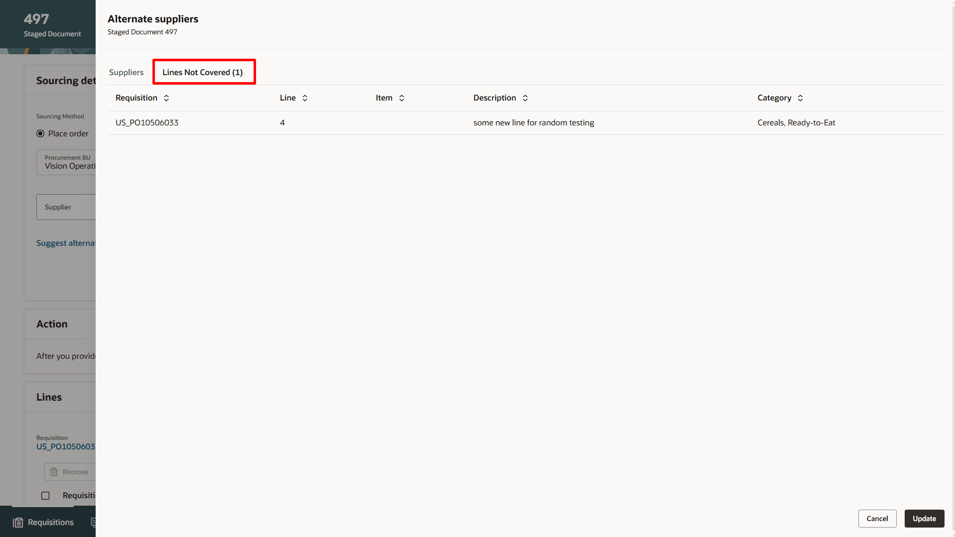

Suppliers are ranked based on the number of staged document lines they can fulfill. Lines without supplier suggestions are grouped under Lines Not Covered for targeted review.
Add Suggest Alternate Supplier Using AI

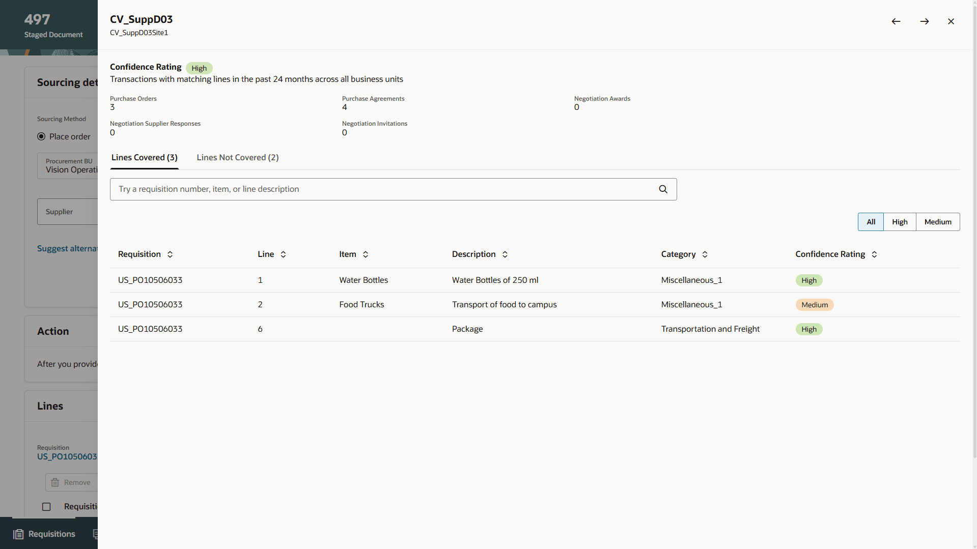

Buyers can review a confidence rating for each suggested supplier. This rating is based on a similarity score that measures how closely staged document line attributes, such as item, description, and category, match a supplier’s historical transactions. The overall supplier confidence rating is derived from the highest line-level rating across the staged document lines.
The similarity score ranges from 1 to 100 and is categorized as follows by default:
- High: 80 and above
- Medium: 60 to 79
- Low: 40 to 59
Supplier Suggestions Based on AI Model with Confidence Rating
Staged Document Lines Not Covered by Any of the Suggested Suppliers

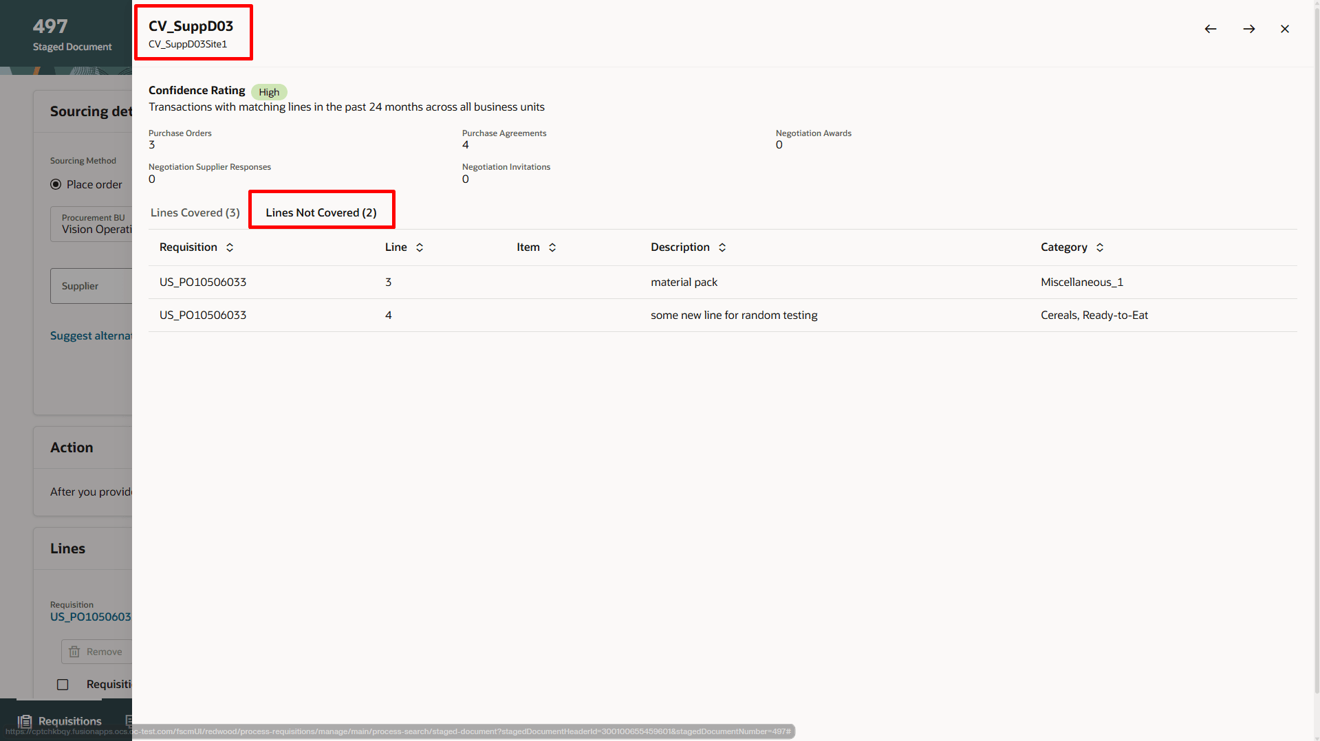

You can evaluate a suggested supplier by clicking the supplier name. Any staged document lines that a suggested supplier can't fulfill are shown under Lines Not Covered for quick review.
Review Details of the Suggested Supplier
Staged Document Lines Not Covered by the Suggested Supplier
