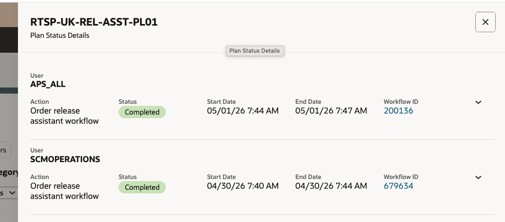

To review the orders that were evaluated by the Planning Order Release Assistant:
  1. Open the plan’s Action menu.
  2. Select View Status Details.
  3. From the list of actions, select the row with your instance of the Order release assistant workflow.
  4. Select the Workflow ID link.
Plan Status Detail Drawer Showing Multiple Order Release Assistant Workflow Links

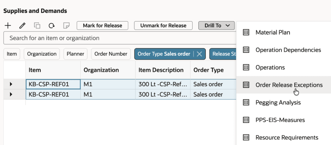

This will open the Supplies and Demands page for the relevant orders and include the orders that were marked for release and those that were not.
  1. To see only the orders that were not marked for release by the AI Agent, filter the results using the Release Status filter.
  2. Select the status of Release.
  3. To review, select the order rows and open the Drill To menu.
  4. From the menu, select Order Release Exceptions.
Order Release Exceptions Drill To Action

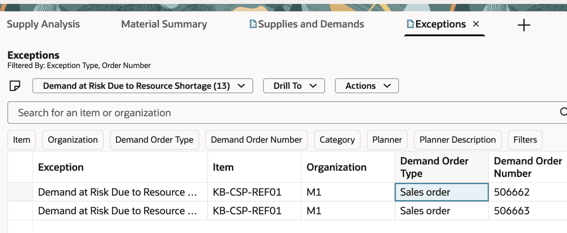

This opens the Exceptions table, listing the exceptions that exist for the orders that were not marked for release, listed by exception type. The exceptions are listed starting with the first exception type identified. Compare these exceptions to your Planning Order Release Assistant’s rules document to see the threshold values that weren’t met.
 Exceptions List Filtered by the Order Release Exceptions
For example, these two orders shown in the exception list weren’t marked for release. The Order Release Assistant’s threshold document had a limit for the Demand at Risk Due to Resource Shortage exception for the value of order amount being no more than $100. These orders had a value of $1500, therefore exceeding the defined threshold and requiring a manual review.
You can switch the exception type menu to see additional exceptions for the given orders.
