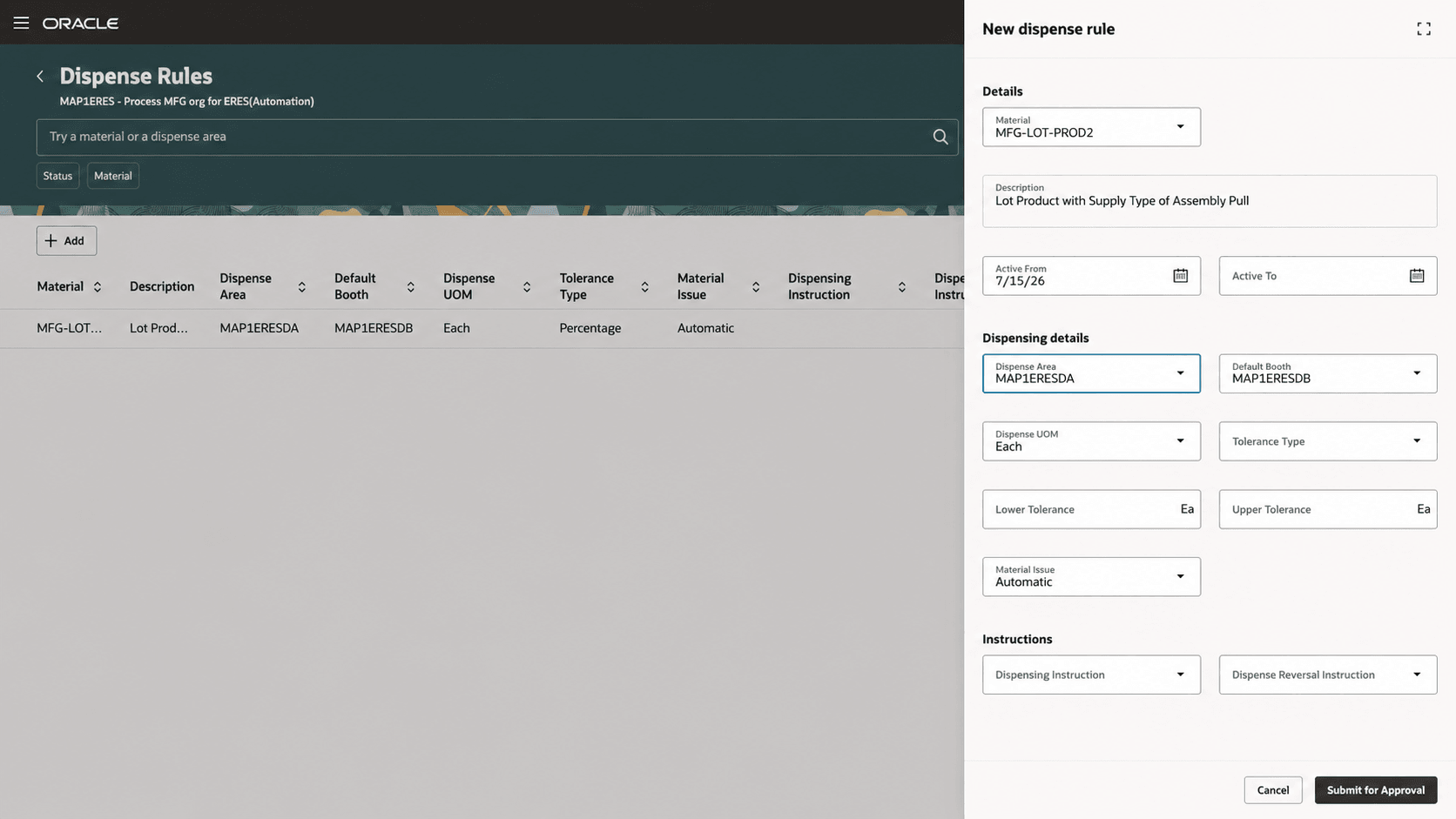

ERES approvals for new dispense rules
Once you click Submit for Approval, a new deferred approval is invoked.

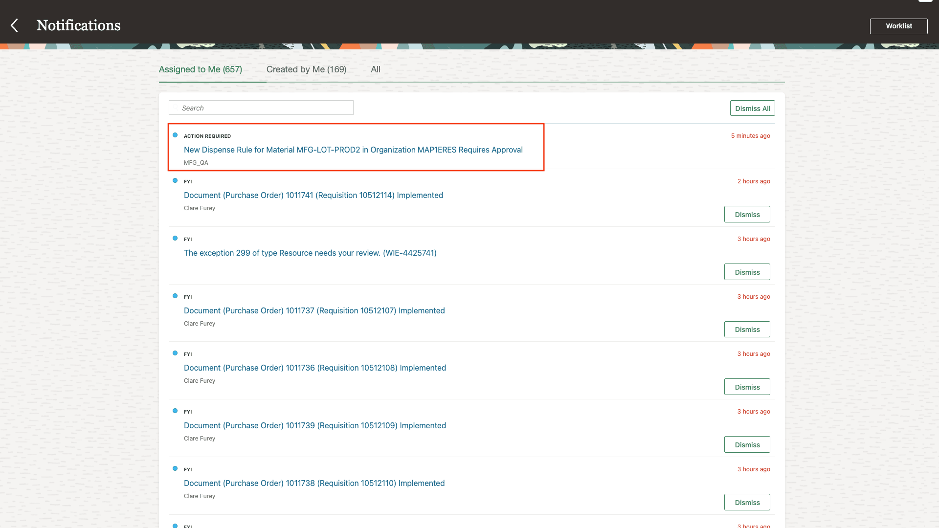

Deferred approval notification

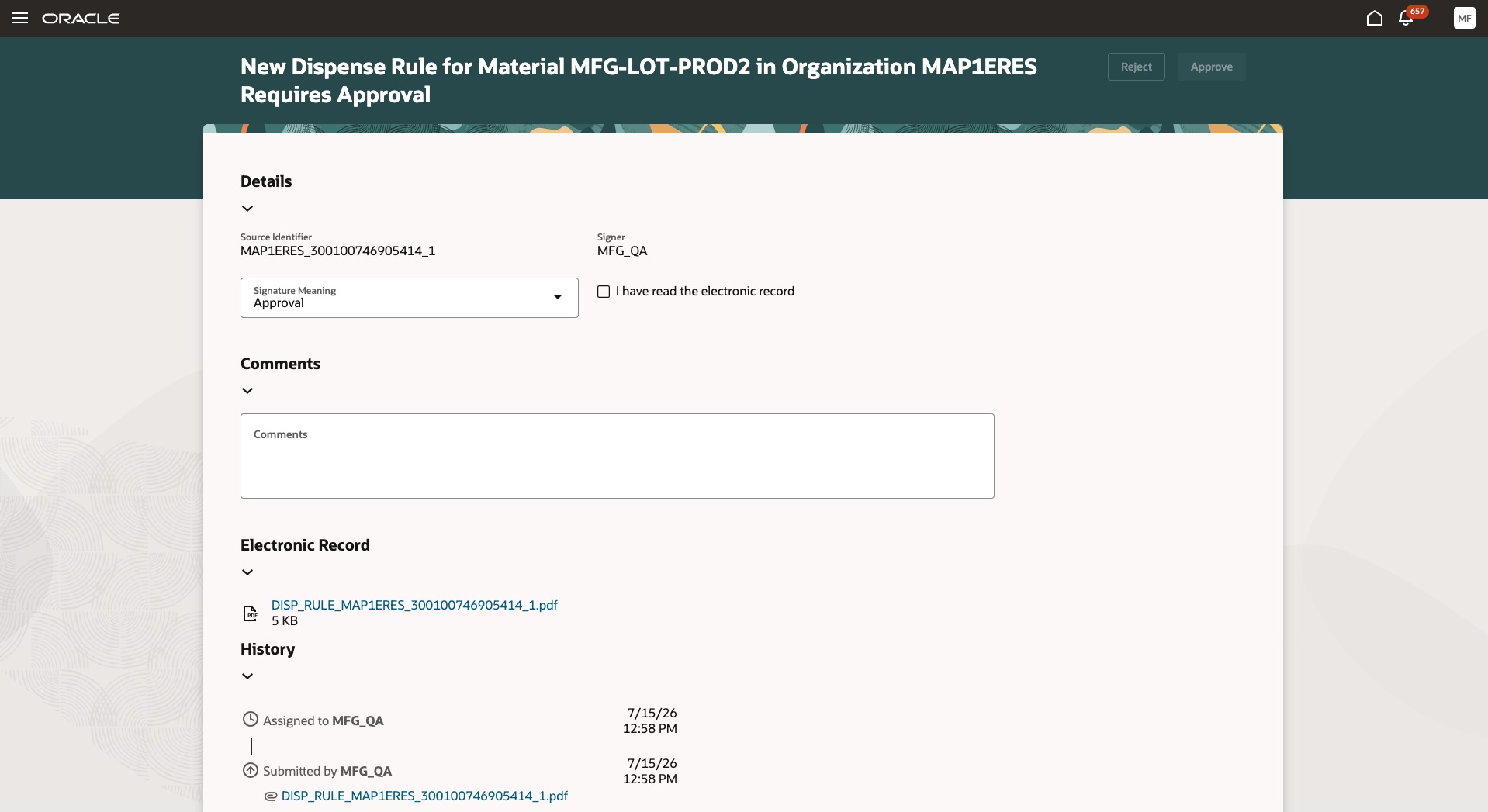

The approver can review the information and approve or reject the dispense rule created.
Dispense Rule Approval
Dispense rule approval

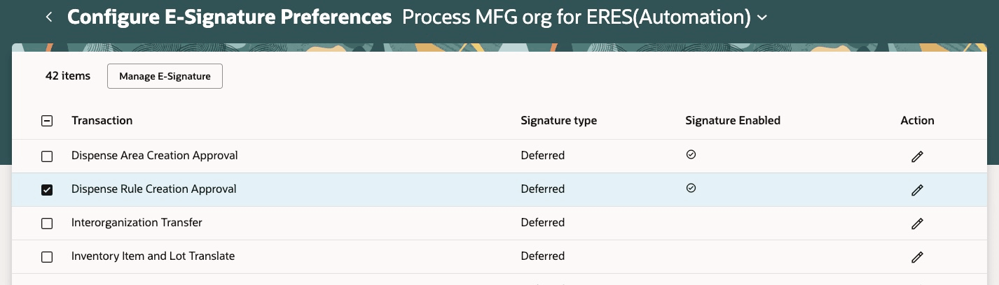

Steps to enable and configure
  1. In the Setup and Maintenance work area, search for and select the Configure Electronic Signature Preferences task.
  2. On the Configure E-Signature Organizations page, select the inventory organization/plant where you would be dispensing materials.
  3. Enable the Dispense Rule Creation Approval transaction.
    Configure approvals for dispense rules
  4. After you enable electronic signatures for a transaction, define configurable business process rules in Oracle Business Process Management using the Manage Task Configurations for Supply Chain Management task.
  5. Use the Manage Approval Groups task in the Setup and Maintenance work area to determine the approvers for each transaction. The task name is DispenseRuleApproval.
