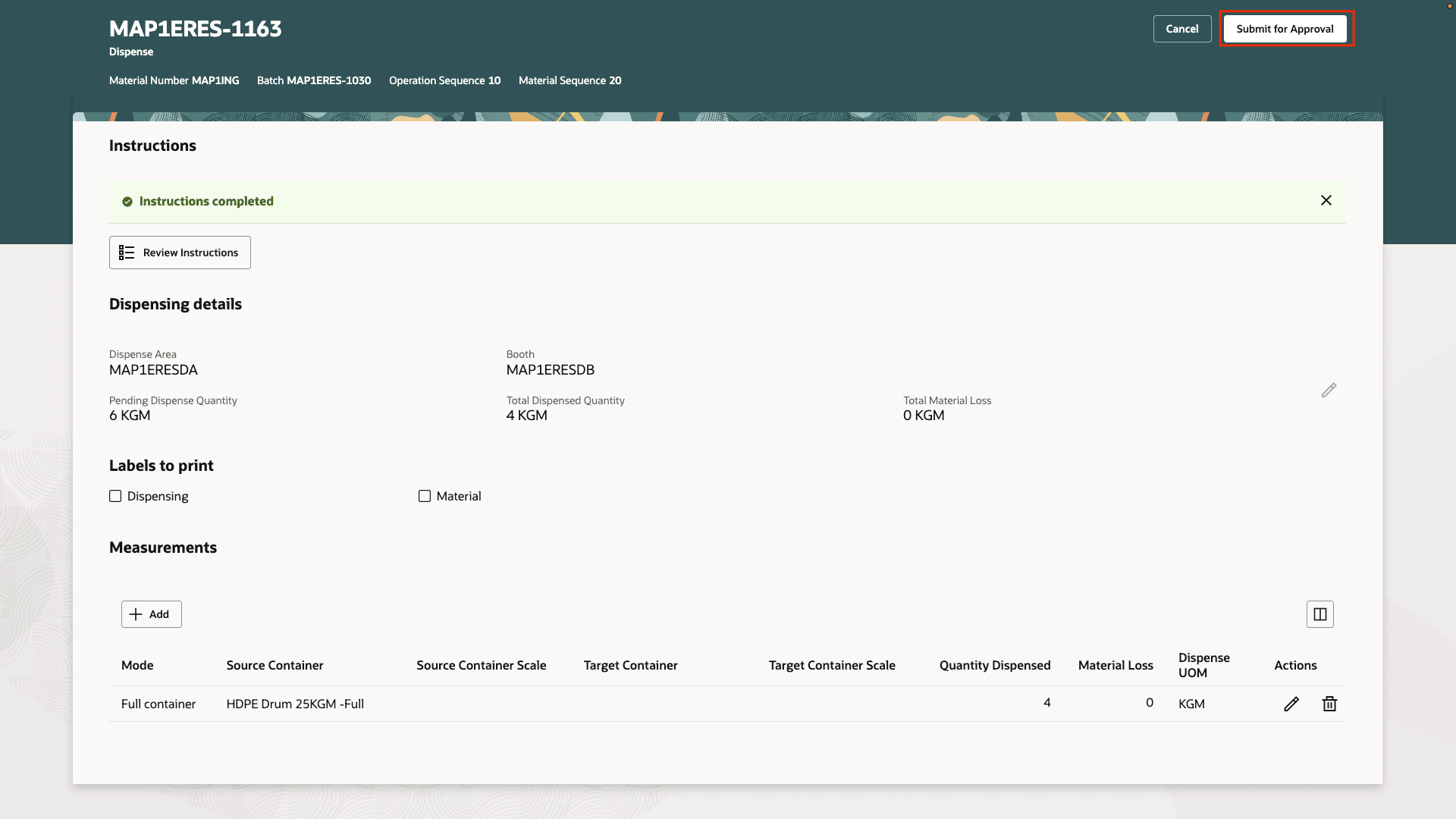

The in-line approval for the dispense transactions is initiated once the operator completes the dispensing measurements.
Submit dispense transaction for approval

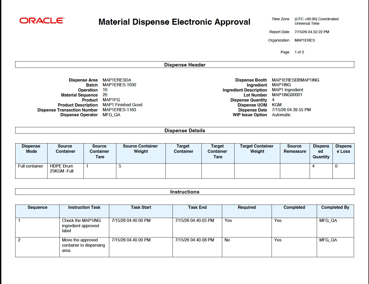

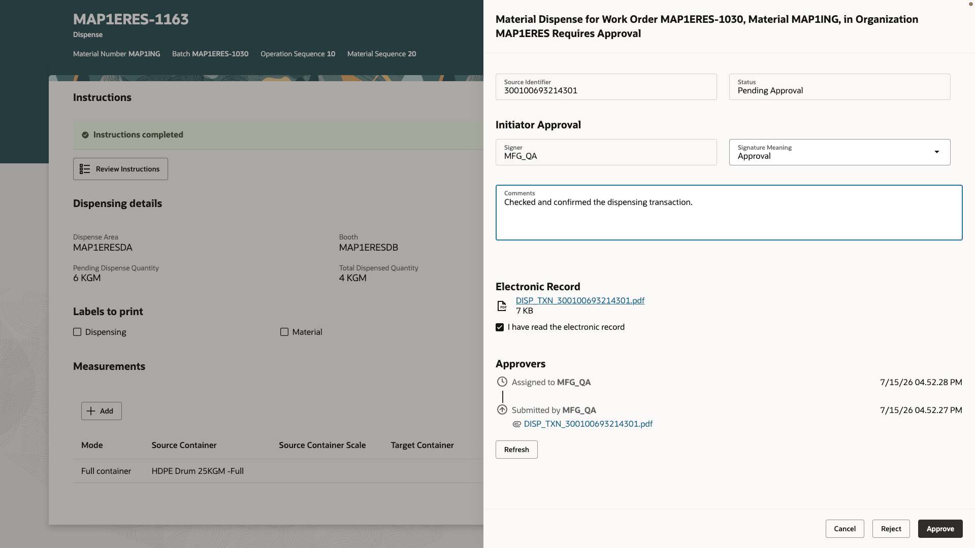

The approval task includes the details of the dispense transaction and an electronic record that contains the dispensing information and the instruction tasks followed by the operator.
Dispense transaction approval
Dispense transaction electronic record

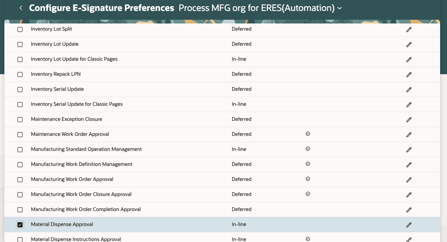

  1. In the Setup and Maintenance work area, search for and select the Configure Electronic Signature Preferences task.
  2. On the Configure E-Signature Organizations page, select the inventory organization/plant where you would be dispensing materials.
  3. Enable the Material Dispense Approval transaction.
    Configure material dispense approval
