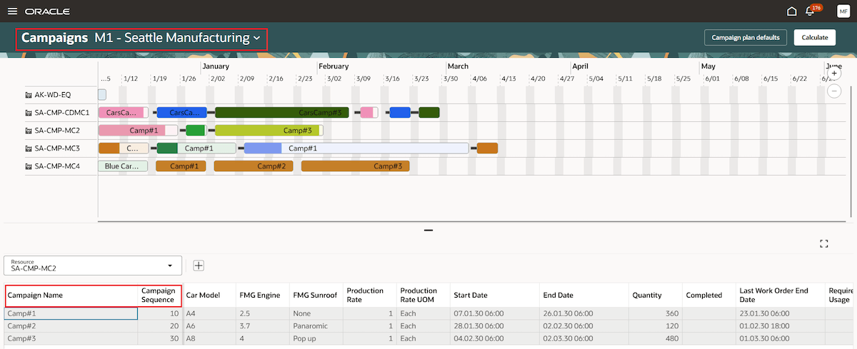

Using Production Scheduling, you can use the integrated Production Campaign to create and manage campaigns by organizations and campaign resources. This capability connects longer-term campaign planning with production batches to organize shop floor activities on campaign resources. Production Scheduling subsequently aligns the upstream and downstream manufacturing stages with the sequenced activities on the campaign resource. You can view the campaign details of the batch in Manufacturing.

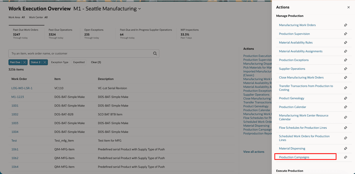

You can view production campaigns from Manufacturing using the Production Campaigns task in Manage Production.
Production Campaigns -  Production scheduling (Supply Planning)

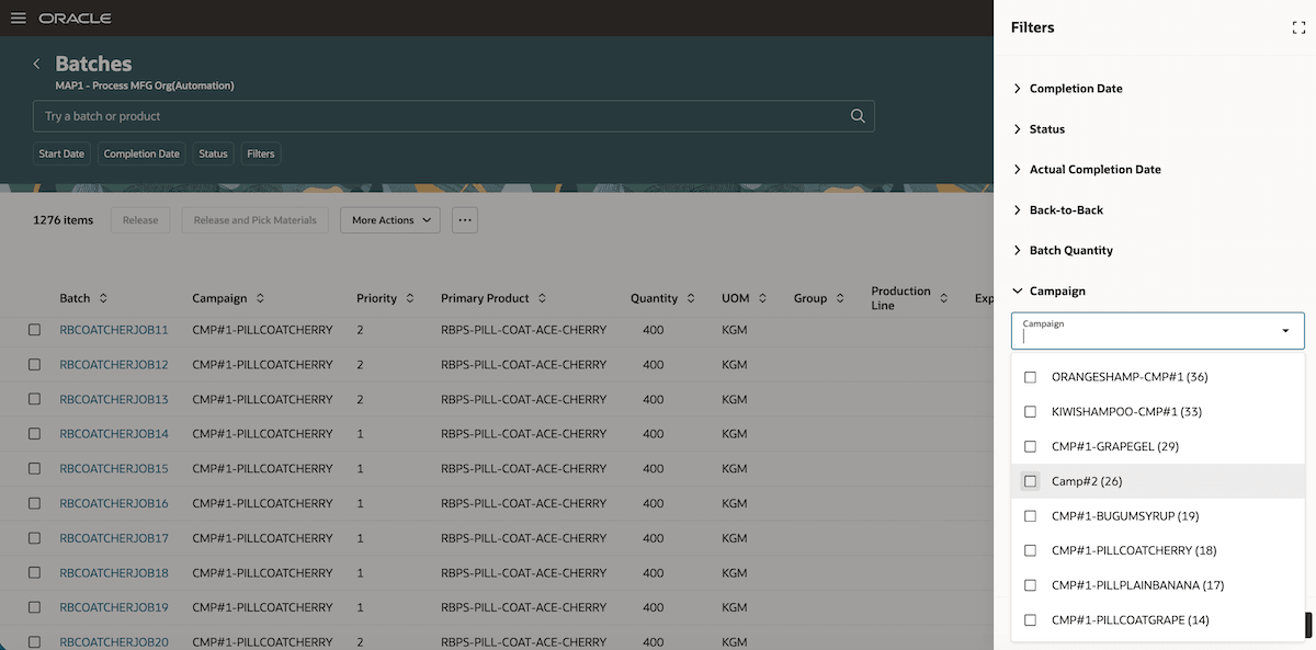

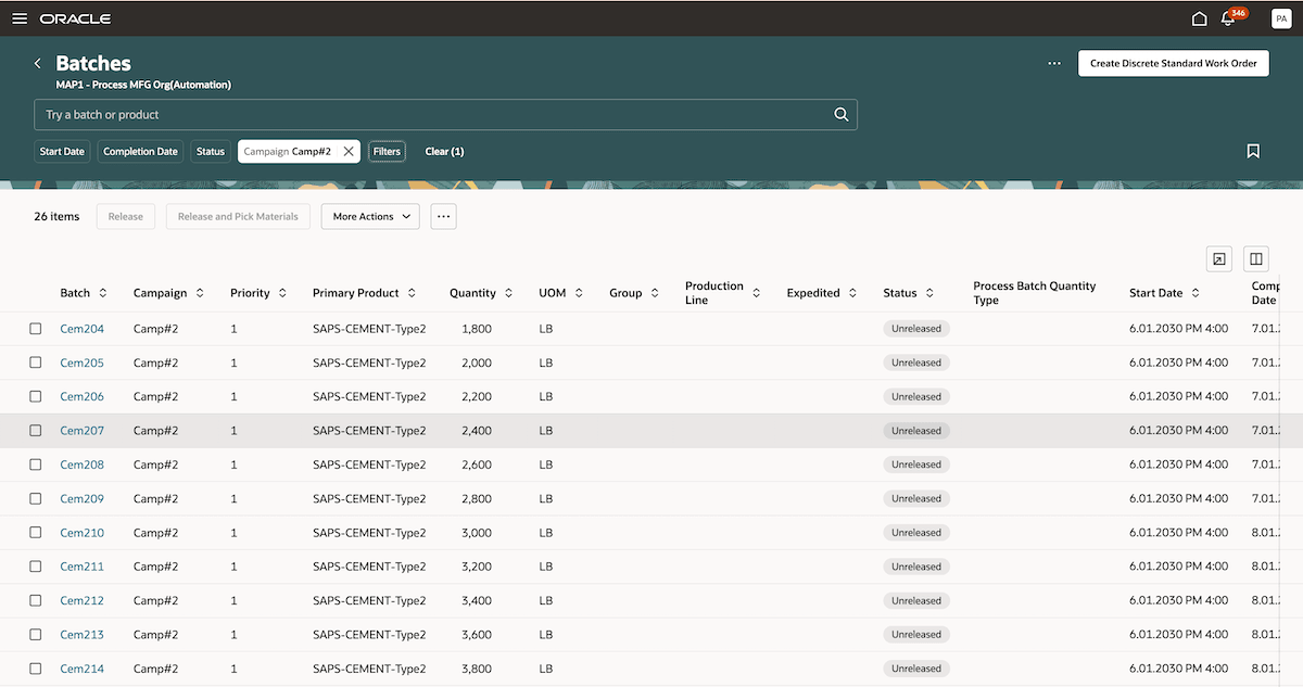

You can filter manufacturing batches by campaigns.
Search batches by Campaign
View batches based on campaign details

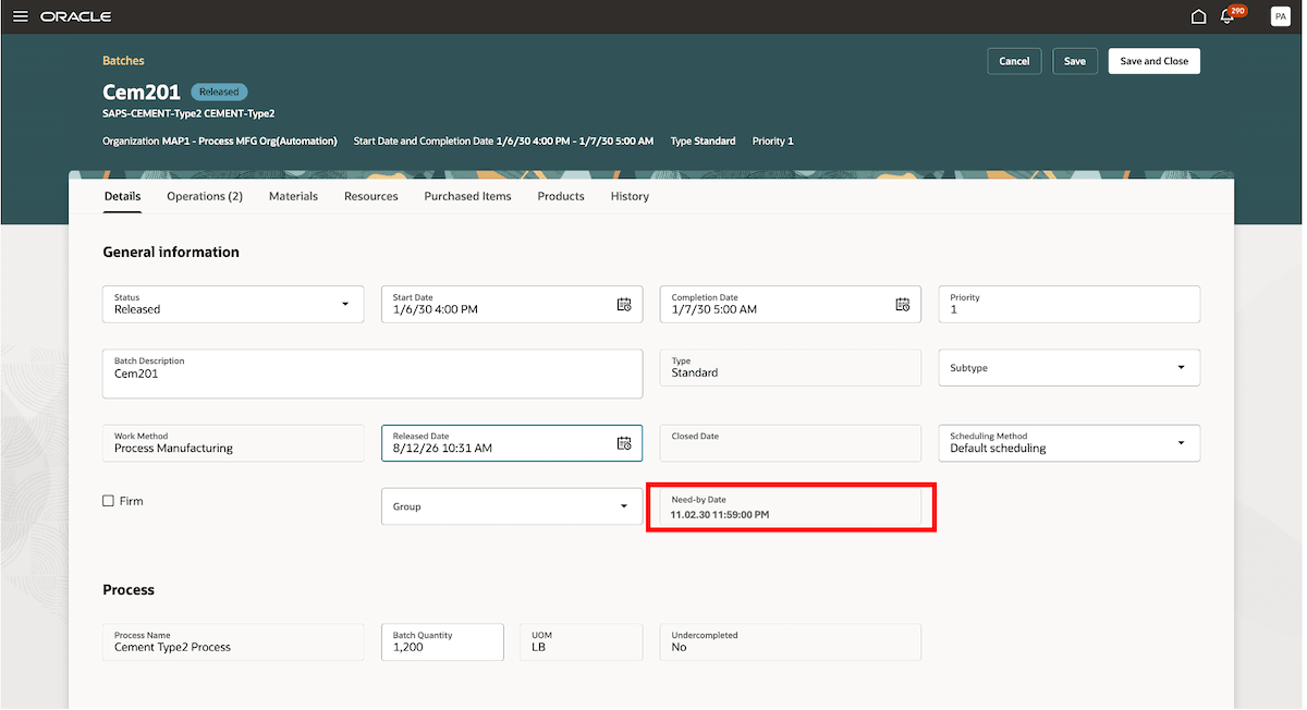

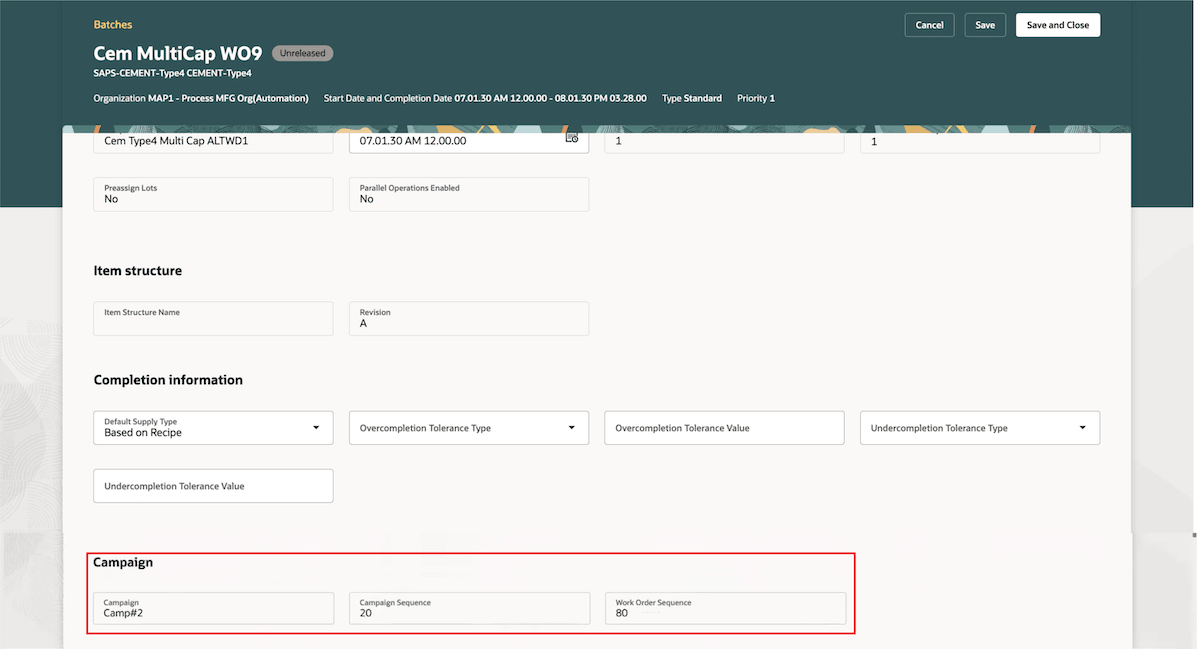

You can select a batch and view its campaign details.
Batch - Campaign Details
Campaign details on Batches UI
Batch - Need-by date

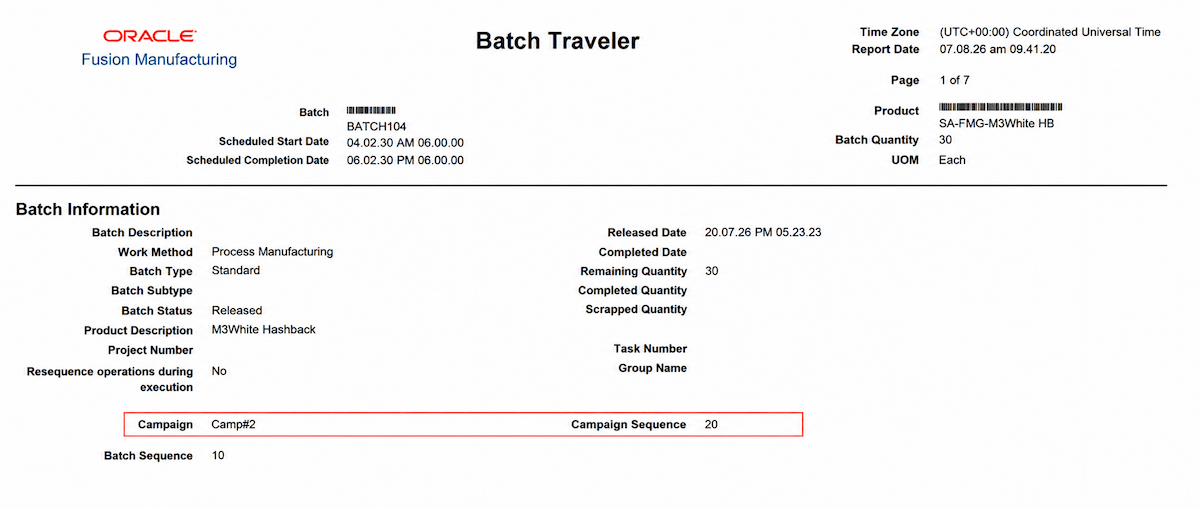

Batch Traveler Report- Campaign Details
Batch Traveler - Campaign details

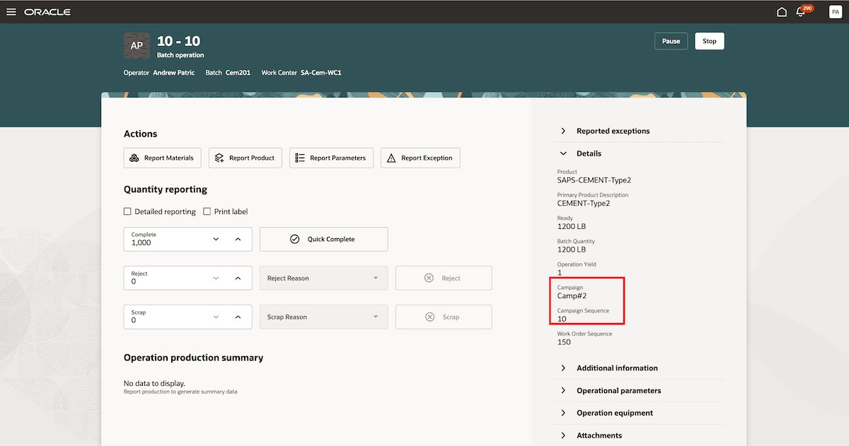

You can also view the campaign details of the batch during work execution.
Batch Execution - Campaign details
Batch execution - Campaign details

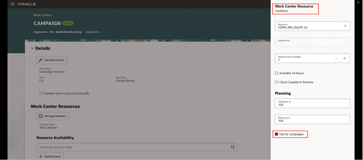

Steps to enable and configure
You can set up a work center resource as a campaign resource. A campaign resource must be an equipment/machine resource defined at the work center resource level. Only single-capacity work center resources can be used for campaigning. Campaigns are not supported on work center resources with Default Units Available set to a value greater than one.
Designate equipment resource for Campaign
