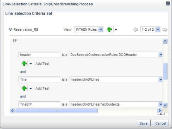

  5. Define IF statements.
    • header is a DOOSeededOrchestrationRules.DOOHeader
    • fline is a header/childFlines
    • flineEFF is a header/childFLines/flexContexts
    where
    • header is a variable that stores the order header.
    • fline is a variable that stores the order line.
    • flineEFF is a variable that stores the extensible flexfield.
    For example:
    adding variables in dialog

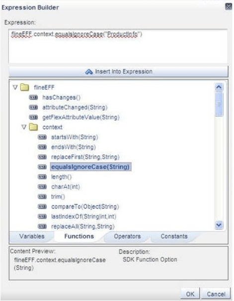

  6. Create an expression that looks up the extensible flexfield value in the tests.
    • flineEFF.context.equalsIgnoreCase("ProductInfo")
      For example:

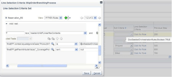

  7. Create tests.
    Code
    Description
    flineEFF.context.equalsIgnoreCase("ProductInfo") is DooSeededOrchestration Rules.Boolean.TRUE
    Make sure the item isn't a coverage item.
    flineEFF.getFlexAttributeValue("CoverageProduct") isn't null
    Make sure the value in the flexfield isn't empty.
    For example:
    adding tests to the rule

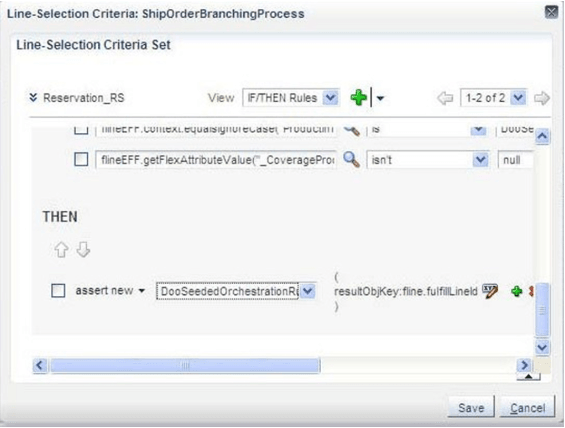

  8. Create an action.
    • Assert new DooSeededOrchestrationRules.Result(resultObjKey:fulfillLineId)
      This action creates the result to use for the order line that satisfies the If statement.
      In the Condition Browser, select the attribute. This attribute sets resultObjKey to the run-time value of the fulfillLineId.
      For example:
      creating the action
