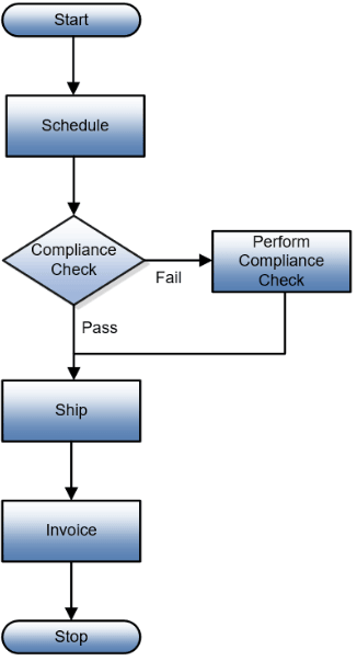

You will set up a line selection criteria in an orchestration process so it specifies which orchestration process steps to run for each order line. You set it up according to the value that the flexfield contains. You create this rule:
If the Export Compliance status is Not Passed for an order line, then manually examine the line. Send other order lines directly to shipping.
You will create this flow:
You use the flexfield to store the value of the compliance status:

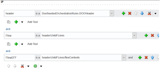

You will create this If statement. It establishes the object hierarchy:
Establish the object hierarchy.
In the If area, delete the value in the field to the left of Is A, and then enter this value.
Attribute
Value
Field to the left of Is A
Header
In the field to the right of Is A, set the value.
Attribute
Value
Field to the right of Is A
DooSeededOrchestrationRules.DOOHeader

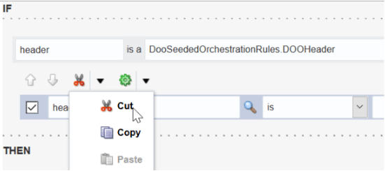

Under the field that contains
header, add a check mark to the option that selects the test, click Cut > Cut.For example:
The hierarchy includes the extensible flexfield variables, so its not necessary to include tests when you define the hierarchy.
Click Add Pattern.
In the field to the left of Is A, enter the value.
Attribute
Value
Fline -
Attribute
Value
header/childFLines
Click Add Pattern.
Attribute
Value
FlineEFF
Attribute
Value
header/childFLines/flexContexts

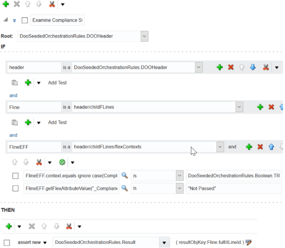

Select Lines According to Flexfield Context
You will add this test:
If the flexfield's context is Compliance
This text will select lines only where the flexfield context is Compliance.
You will create an expression.
Left Expression |
Operand |
Right Expression |
FLineEFF.context.equalsIgnoreCase("Compliance") |
Is |
DooSeededOrchestrationRules.Boolean.TRUE |

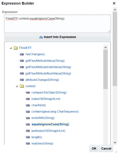

Select lines according to flexfield context.
Under the pattern you just added, click Add Test.
You will add the test criteria that identifies order lines that proceed through compliance testing. If the attributes you reference are optional, then you include null value checks to avoid a null pointer exception at run time.
Click Left Value.
In the Condition Browser, click Expression Builder.
In the Expression Builder, click Functions, expand FLineEFF > Context, click equalsIgnoreCase(String), then click Insert Into Expression.
For example:
To navigate the tree structure, expand the folders until you can view the functions of the context object. FlineEFF is the pattern you declared earlier.
The context you expand is a fact in the FlineEFF pattern. It includes functions you can use to perform a variety of calculations. Therefore, the expression you create includes the pattern, fact, and function.

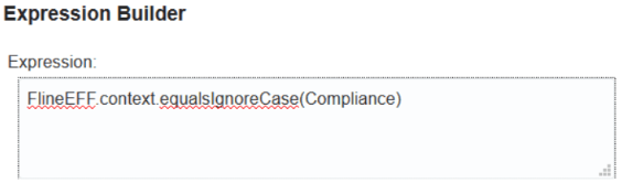

In the window near the top of the dialog, replace the word
Stringwith the context for your extensible flexfield condition. In this example, replaceStringwithCompliance.For example:
Click OK > OK.

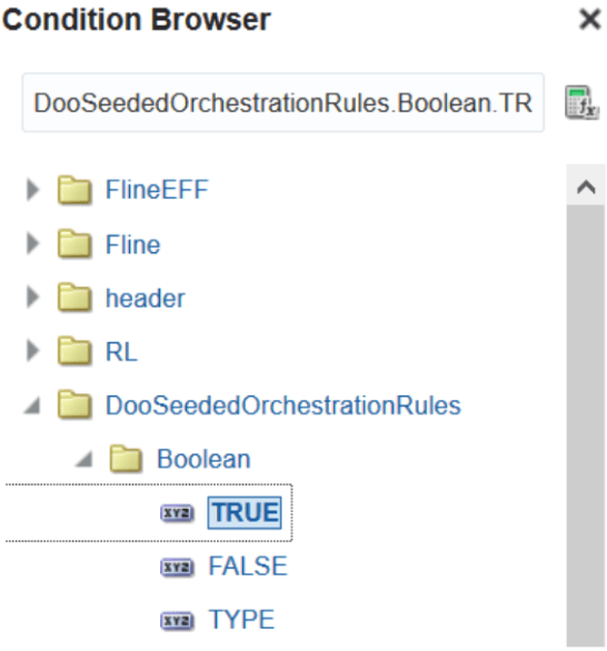

Click Right Value.
In the Condition Browser, expand DooSeededOrchestrationRules > Boolean, then click TRUE > OK.
For example:
Select Lines According to Compliance Status
You will add a test.
If the value of the flexfield attribute named Compliance Status is Not Passed
Left Expression |
Operand |
Right Expression |
flineEFF.getFlexAttributeValue("_Compliance_Status") |
Is |
"Not Passed " |
Select lines according to Compliance Status.

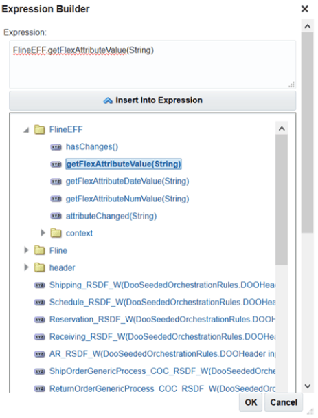

In the test you just added, immediately to the right of the Right Value magnifying glass, click the down arrow, then click Simple Test.
Click Left Value.
In the Expression Builder, click Functions, click FlineEFF.getFlexAttributeValue(String), then click Insert Into Expression.
For example:

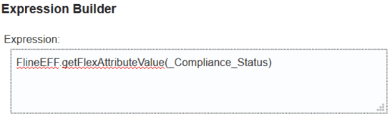

In the window near the top of the dialog, replace the word String with the name of the flexfield attribute.
You must use an underscore to prefix the attribute name in a function. The attribute name is Compliance_Status, so you use _Compliance_Status.
For example:
Click OK > OK.
In the field to the right of Is, enter
"Not Passed".You must include the double quotation marks ( " ).
Make sure your rule contains tests.
Left Expression
Operand
Right Expression
Is
is
"Not Passed"

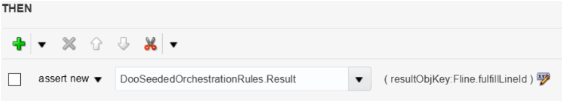

Identify the Order Line That You Need to Manually Examine
You will create a statement.
where
Result is a fact in the DooSeededOrchestrationRules dictionary.
resultObjKey is a property of the Result fact.
resultObjKey stores the value that this rule uses to identify the order line that requires manual examination.
Flineis a fact in the DooSeededOrchestrationRules dictionary that contains order line attributes. -
fulfillLineID is an order line attribute.
Identify the order line that requires manual examination.

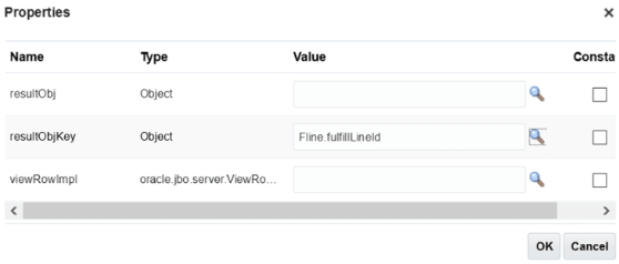

In the Then area, click Add Action > Assert New.
Click Select a Target > DooSeededOrchestrationRules.Result.
Click Edit Properties.
In the Properties dialog, in the resultObjKey row, click Value.
Fline, click fulfillLineID, then click OK. -
Make sure the Properties dialog looks like this:
Click OK
In the Line-Selection Criteria dialog, click Save.
On the Edit Orchestration Process Definition page, click Save.
